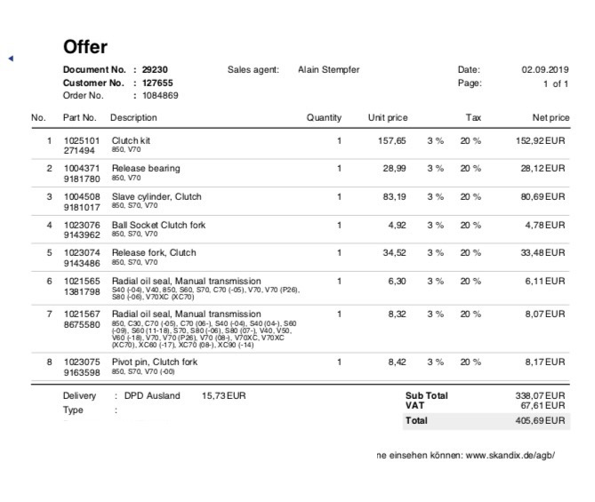

Here's the parts I've bought from Skandix.
Manov

Post by scot850 »
My view is if the problem/noise was not there before the work, something has changed from what has been done.
Looking at the list, if there is a pilot bearing in the end of the crankshaft to support the gearbox main shaft it is not listed unless it was included in the clutch kit. My experience of clutch kits would say that it is not included.
FLXC90 makes fair comments, but to me if something does not sound right then chances are it is not.
Finally, although Volvo part numbers are listed, at those prices I would be surprised if some if any are OE or even OEM parts. Not sure who makes Volvo manual clutch parts these days, but it used to be Sachs or Borg and Beck.

Post by FLXC90 »
Yes there is a pilot bearing/bushing. I couldn't find it at FCPs site, but Volvo US showed it. 20$ part. 1397077. The Skandix clutch Kit should only be disc and pressure plate by the lower part number
