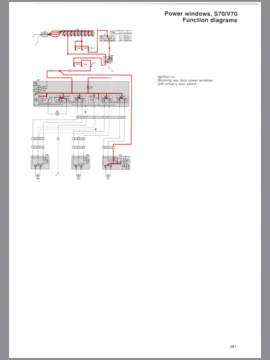

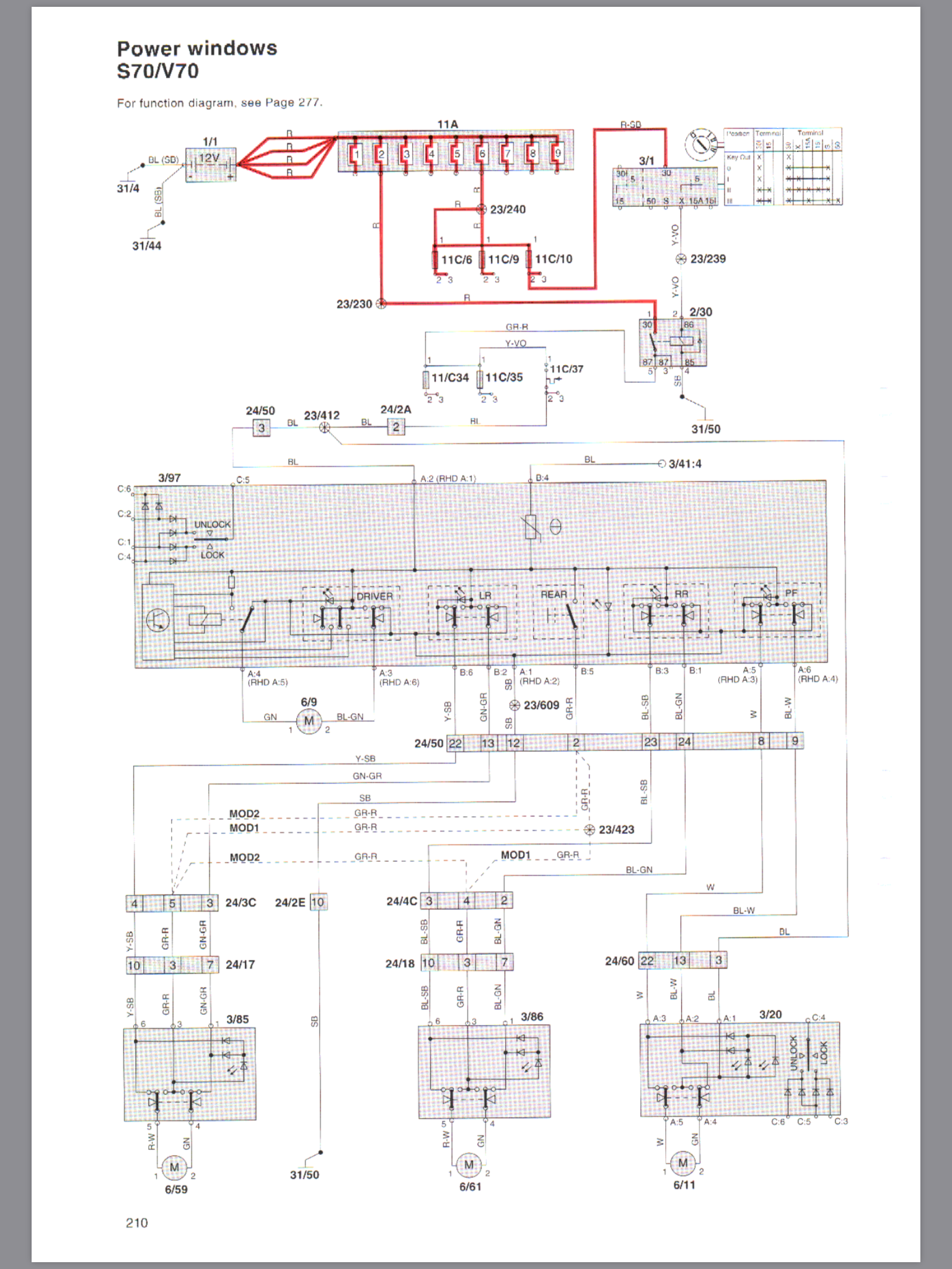

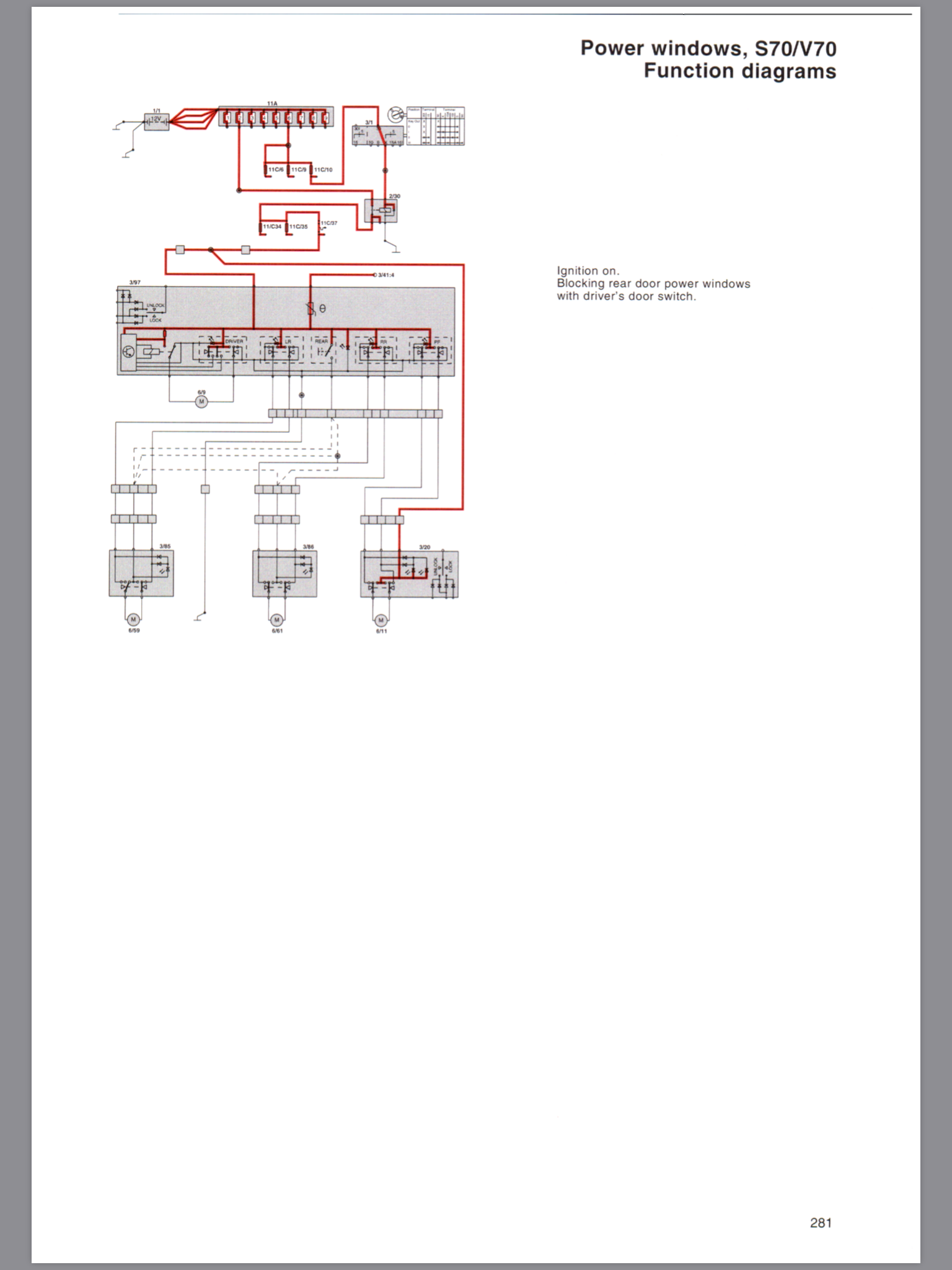

For a sanity check, you can unplug the connector at the local switch, identify the two
wires that run from the switch directly to the motor and apply 12 volts straight to the motor.
Apply voltage one way to put it down, then reverse polarity to run it back up.
( Always run this test with a fuse in the hot side of your test power leads ).
If everything functions as it should, then you can start chasing through switches.
Here’s a little something to help:
