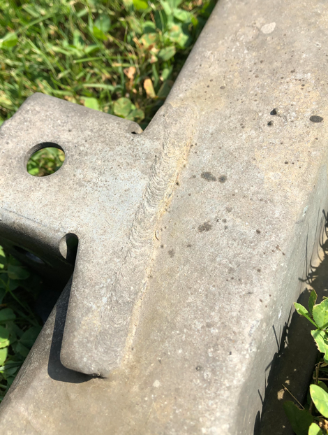

This happened to my car.
Front wheel encountered curb and snapped control arm. As Abscate says, look for damage at subframe.
Below is what my damaged frame looked like followed by a good replacement frame.
Bent frame
You can see that as the control arm twisted, it caused the mount to be twisted into frame. The depression highlighted by red arrows shouldn't be there.
Replacement frame
Same area but nice and flat

So in my case, someone other than me was driving and was distracted by map application on phone. She got too close to curb and got the front wheel essentially parallel and touching the curb. She tried to turn and that is what wedged the wheel against the curb.
The control arm bent and then snapped but not before taking out the frame. The outer CV joint ripped apart but amazingly no bearings were lost and I rebuilt the joint and it's been fine since. No body damage at all. Only thing on the body that was damaged was the mud flap. Easily replaced.
I found a donor car that also gave me new interior bits, mud flaps and a few other parts along with frame. The frame replacement was done in my driveway but took longer than I had anticipated (isn't that always the case). Car has been fine since.
