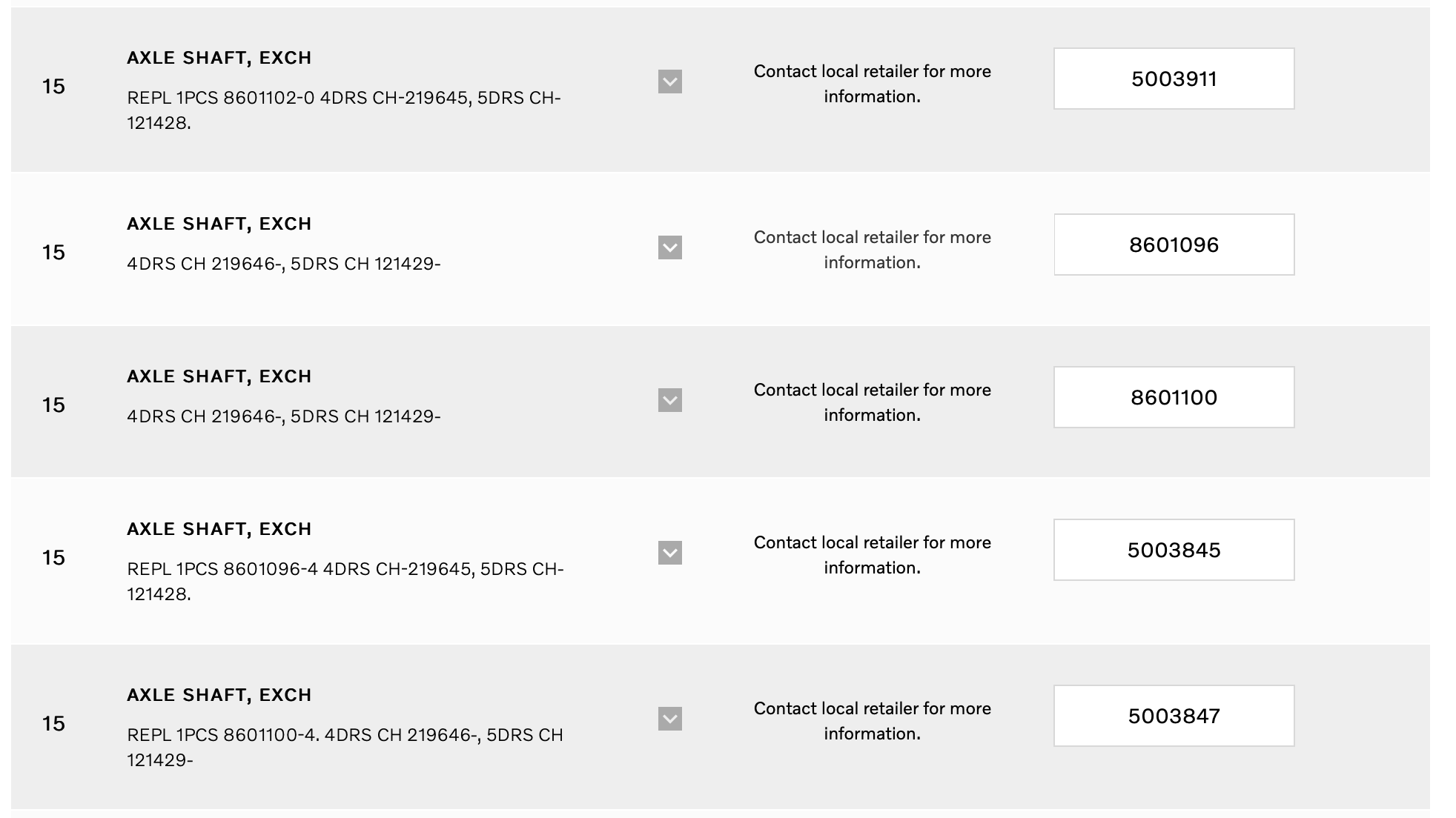

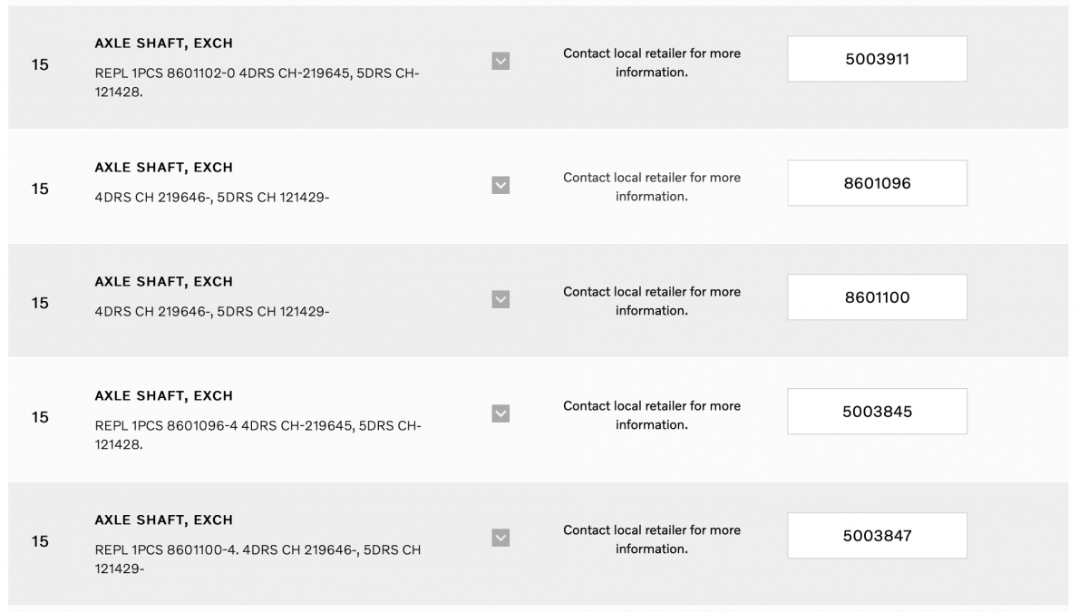

I have tabulated all the part numbers I can find and post images below.
For -1996, it is Hellacious journey into chassis breaks.
From 1997-on isn't too bad
Format is current part number and superseded part numbers in parentheses.

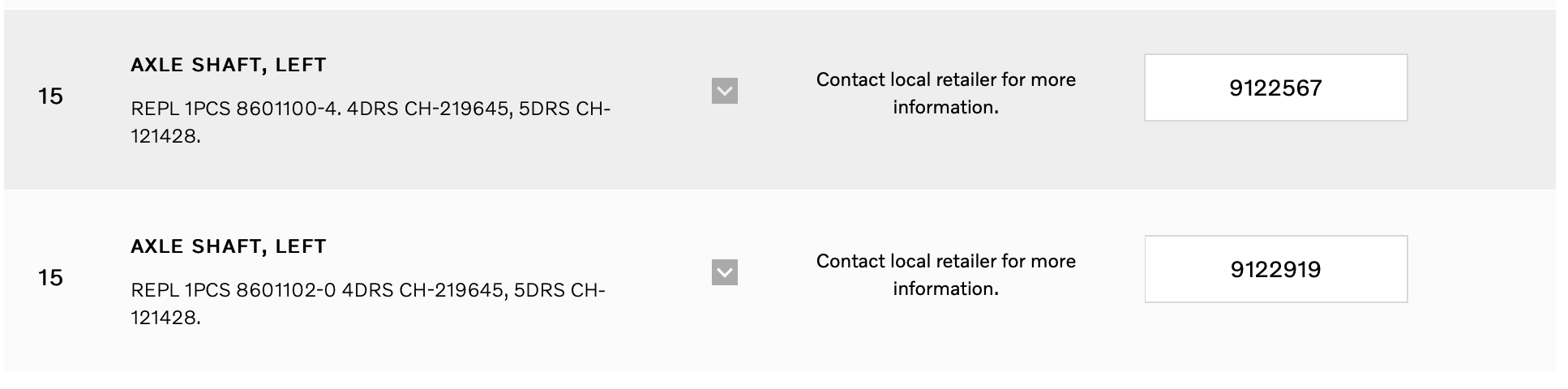

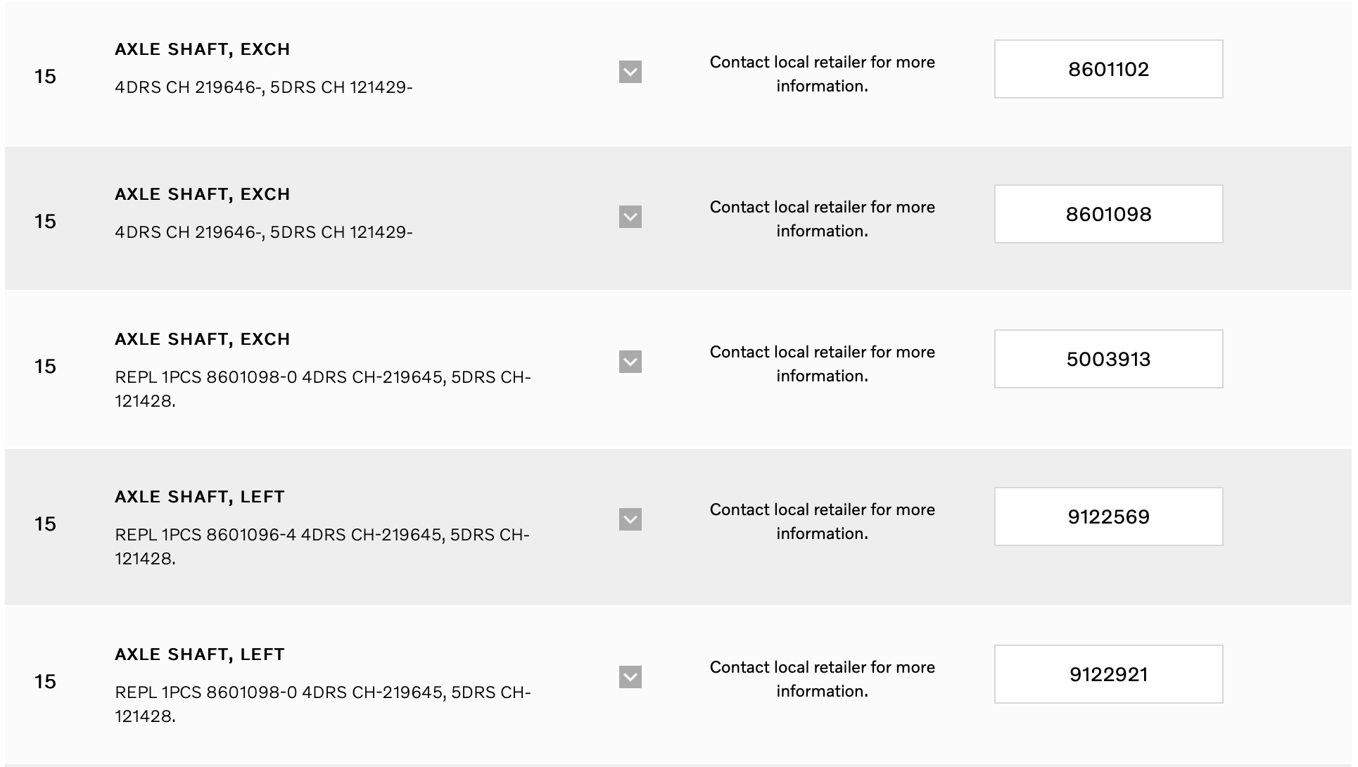

And here are the 15 variants of -1996 axles shafts.
