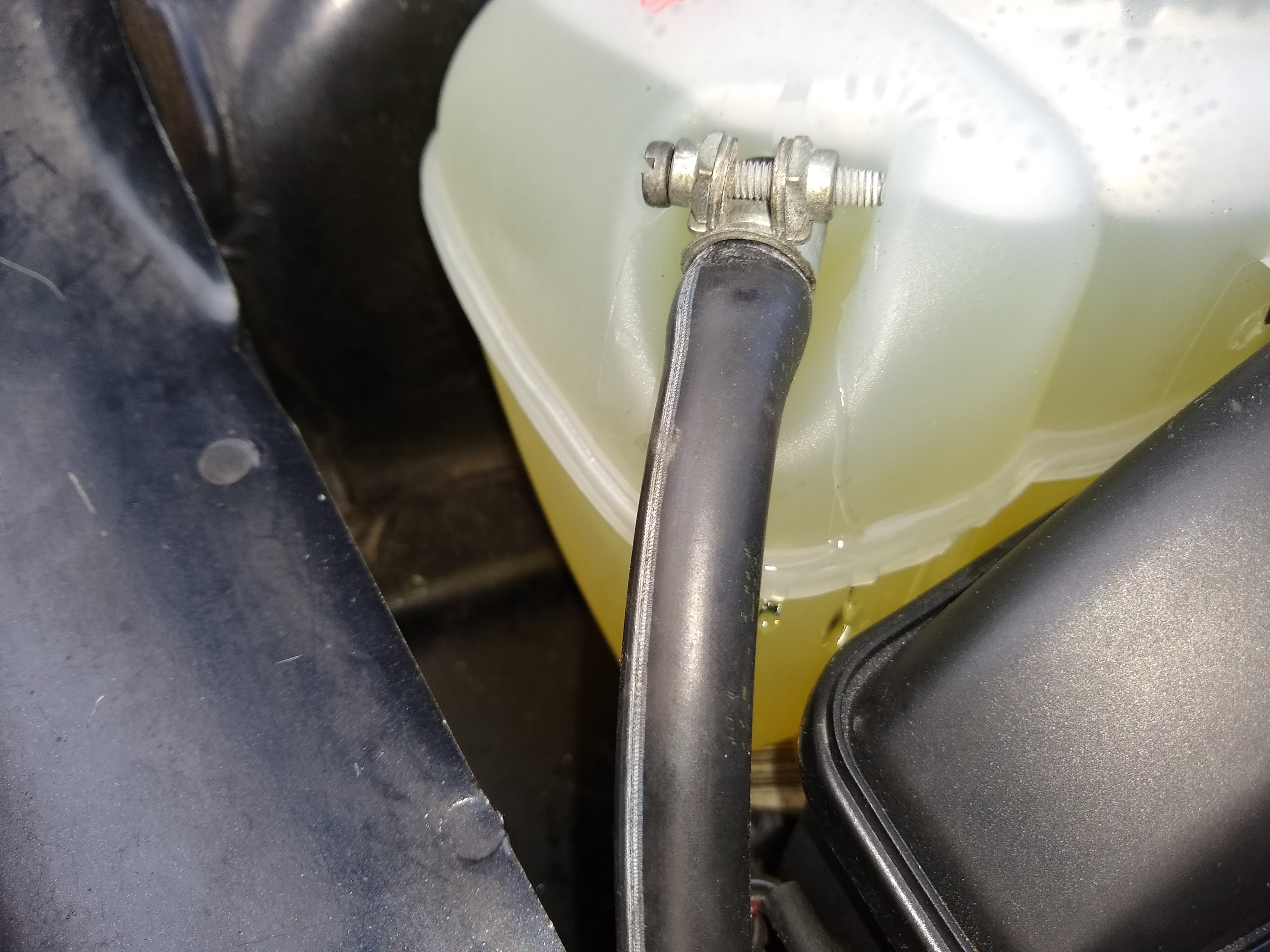

The lottery has never treated me well nor rewarded me unfortunately. After shopping at Costco I checked the level and topped it off. The street parking at home is at a good incline so I have not been able to check the coolant level before driving. After getting home and parking (front facing down hill), I see rapid dripping under the car.
Cut the old section off and reconnected the hose. BTW that's a brand new Volvo tank which I installed after finding the lower radiator hose disconnected. The fan is working when I turn the AC on and that's about all the time I had. Will do the hydrocarbon test at my neighbor's level driveway and if it's OK then I'll test the fan thermostat. Have never tested nor change one so will have educate myself on that one.
If I make it to the compression test and all is well then all the hoses will get a refresh. Thanks.
