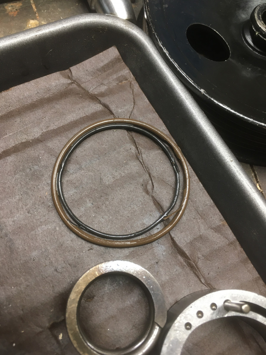

This is an autopsy photo of my first attempt. Incredibly, even with these badly mangled o-rings it didn't leak, although the steering was fairly stiff at idle. There was plenty of assist when the engine was above 1000 RPM, though. The second one I did seems to be working perfectly.
I did wind up installing the Gates kits. I also wound up buying a few more viton o-rings, since the kit doesn't include one for the reservoir or the fitting which the high pressure hose screws into. I used a green HNBR o-ring on the high pressure hose fitting, 5/16" ID X 7/16" OD and so far it's bone dry.
Even using the Lisle 39000 puller on the pulley it was a real struggle to get the pulley off The first time. After 3 hard whacks on the pusher screw I'd be able to turn it another 45 degrees. I think it took over 20 minutes of whacking and wrenching.

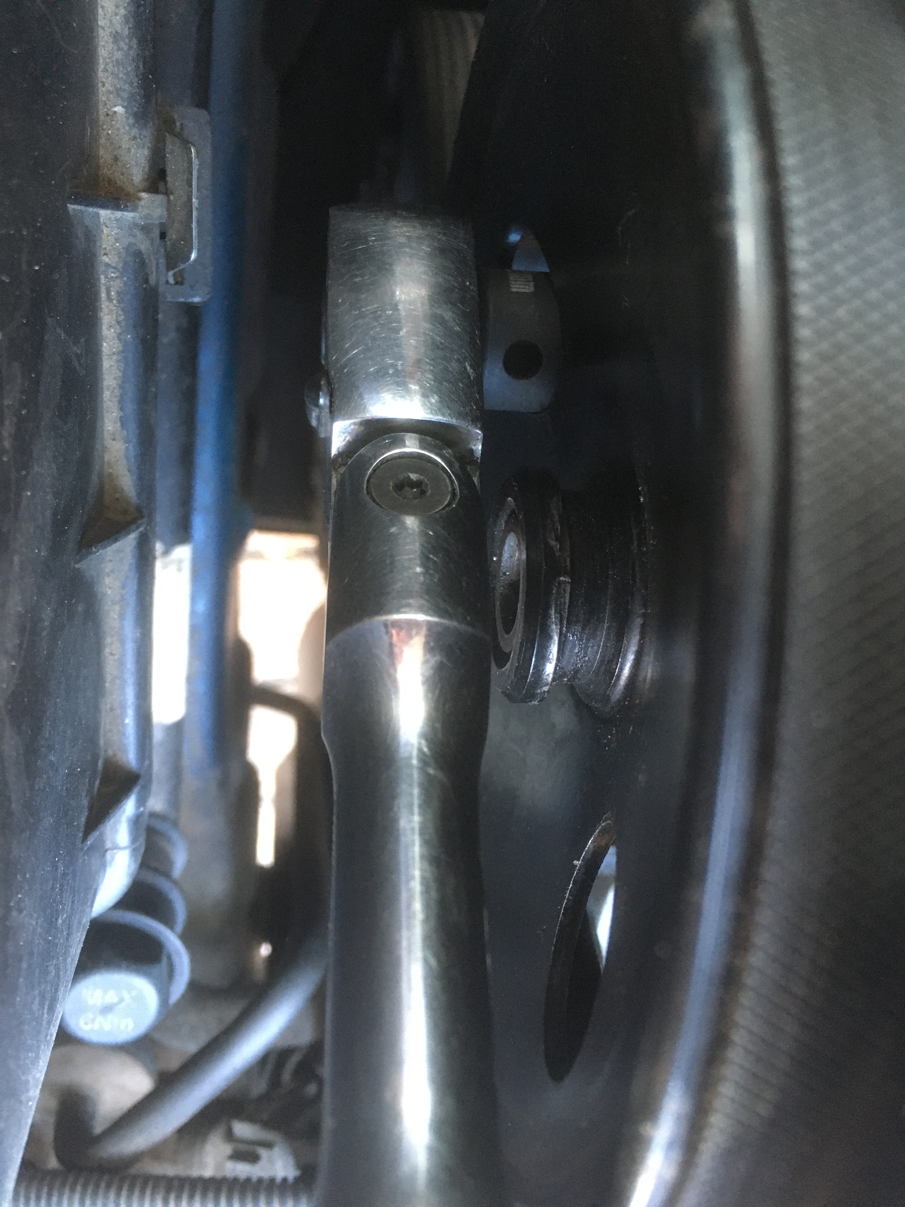

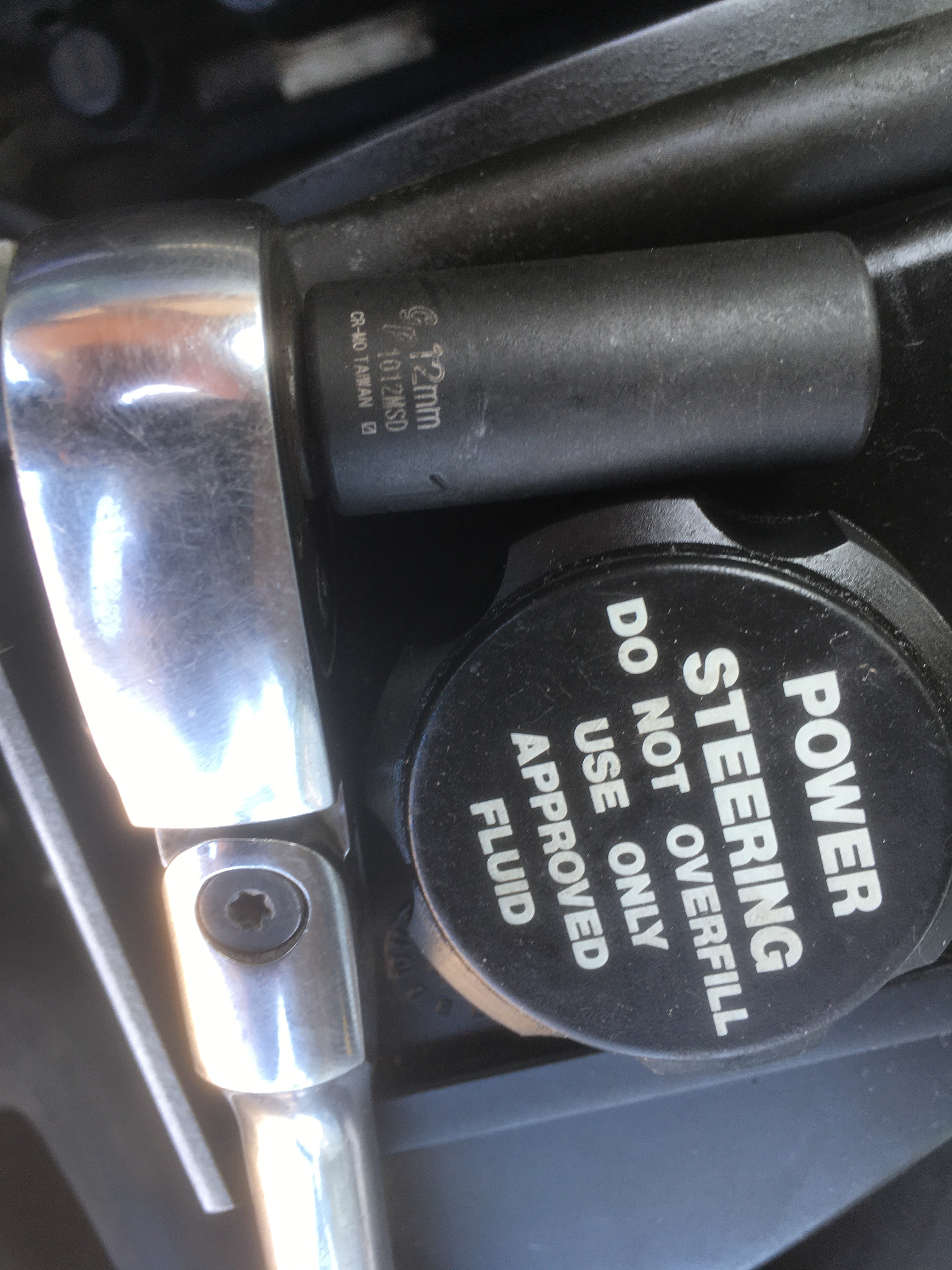

I finally got around to checking the fit of the semi-deep socket I ordered after struggling pretty hard with these bolts the last two times. It's absolutely perfect. I didn't even know semi-deep sockets were a thing until a few weeks ago.
