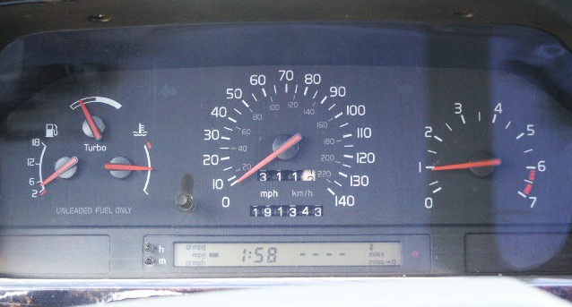

You mean the trip computer? The car *should* be pre-wired for it. I know on 2 of our cars that came without it, the plug for the panel switch was behind one of the blank spots on the dash.
There should also be a connection on the back of the instrument cluster (at least there is on the VDO ones) (The small one on the back of this picture)
