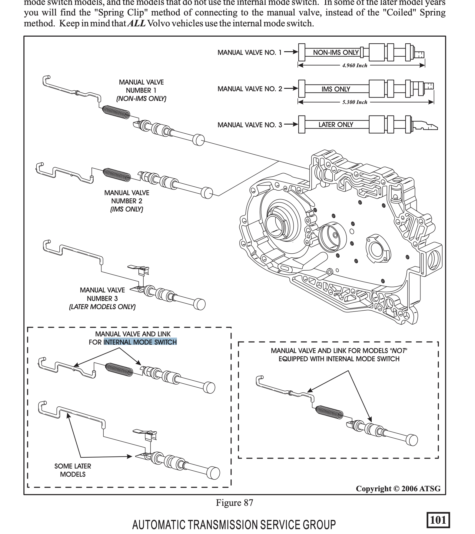

3 versions of valve links, 2 with IMS, one with clip, one with spring
I may have gotten along with the gearbox. I may have installed a wrong combination of manual valve link. There are 2 versions of valve links for these transmissions with Internal Mode Switch (IMS). One has a retainer clip, one has a retainer spring. I thought they would be the same, but I was told they are not. So, I will have to change that out first and see what happens. It does look like I have to pull trans/engine again... 🥺 I will upload a photo with the valve links. The IMS helps determine ignition timing, among other things. Although the IMS is installed correctly (display shows the gear I set the gear lever to), the oil pressure still puts load on, so maybe it's still having an influence on the engine. However, I had lifted the front wheel so they could spin freely, reducing the engine load, which made no difference.

Valve 2 and 3 are the same as far as directing fluid but the retention method is different , so maybe your switch would indicate the gear your shifter cable has selected but the valve body is doing something different

bronco wrote: 18 Jul 2020, 09:34 Valve 2 and 3 are the same as far as directing fluid but the retention method is different , so maybe your switch would indicate the gear your shifter cable has selected but the valve body is doing something different
To clarify I mean even if the manual valve is not attached to the cable the electric switch will still indicate the cable moving the detents for each gear are there as long as that spring roller is bolted onto the valve body , the manual valve in the valve body could be free floating
