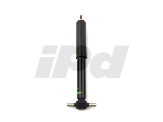

i need the part numbers for the sachs front struts and awd rear shocks (that look like the ipd volvo shock in pic below) and coil springs. Im ready to do the conversion soon. I thought i already did this once or read it already but cannot find it. also are the struts on awd v70 same as the ones on fwd v70?
- picture from ipd, oem volvo awd shock
- ipd volvo awd shock.jpg (24.32 KiB) Viewed 2328 times

Volvo Nivomat Shock Absorber - Genuine Volvo 8626027 green stripe fcp
Volvo Shock Absorber - Rear (w/o Nivomat) 9492049 green stripe eeuroparts
I know neither of these are Sachs, but what a quick search using the picture turned up.
Yes front struts cross between (GLT) AWD and FWD. (as opposed to XCs)

Location: REAR
Brand: SACHS
Part Number: 105 828
Part Type: Shock Absorber
Comment: (Exc. Self Leveling Suspension)
Application: AWD
Qty: 2
do not appear the same, lower mount differs. this is from Sachs (ZF) website https://www.showmetheparts.com/zfservices/
Brand: SACHS
Application: AWD
Qty: 2

https://www.ipdusa.com/uploads/images_p ... _17130.jpg this is a blue stripe, check your data plate (position 22) look for the character there to indicate which rear suspension parts your car uses.

my xc has nivomats. and it also has those 2 bolt down holes on the bottom. i already got the nivomat conversion info (part numbers for the coils and shocks) about 2-4 weeks before my xc went out. i lost the info. need it again. that 828 number isnt what i need. the two silver bolt downs on the bottom (pic you edited) is the awd converted model.FLXC90 wrote: 21 Jul 2020, 21:51 https://www.ipdusa.com/uploads/images_p ... _17130.jpg this is a blue stripe, check your data plate (position 22) look for the character there to indicate which rear suspension parts your car uses.

Also, since you are converting from XC to AWD standard height, you need to check what the different codes meant, which shocks went with which springs, and which anti-roll bars.
Check Volvospeed forums for V70XR build thread, check IPD tech tips, check Volvo parts website and VIN decoders for 98 V70

XC have different rear hub assemblies to AWD or 'R' AWD. They are similar but the mounting points on the hub are raised as the car sits higher. The XC's use a YELLOW banded shock and the regular AWD's and 'R' use green banded. I have never been able to get a straight answer if the banding meant different lengths of travel or just different valving.
If you get stuck I pulled a set of Green Nivomats last week from a 1999 S70 AWD. They need new boots and some paint but are not leaking and the shafts are not rusty. I planned to clean, paint and replace the boots over the winter as a project along with another set I have for the 'R'. Haven't checked the part numbers to confirm if they are the same. The boots are the same part used on the 240's front end. There is a thread on how to replace the boots on MVS several years ago. I bought a set of aluminum 'V' blocks for my bench vice to hold the shafts to remove the bottom mount to get the boots on.
Hey, never thought to see if they are the same length as a FWD Nivomat and if the bottom mounts can be swapped?
