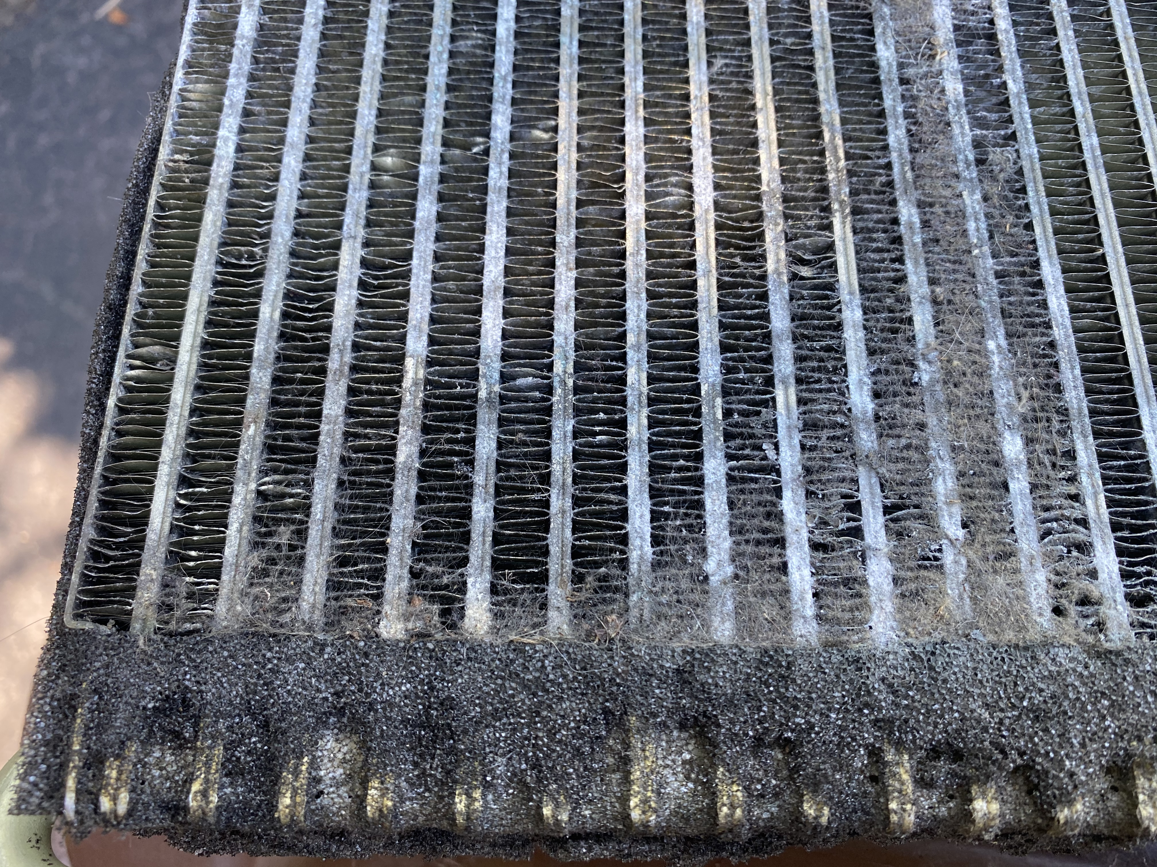

Found the Behr evap from SWMBO bmw I replaces 2-3 summer ago and though I would test it
Symptom ..This car would lose ac performance over three summers due to low charge. I borescoped the evaporator and saw dye and grease stains indicative of a leak.
( skip 12 hours work)

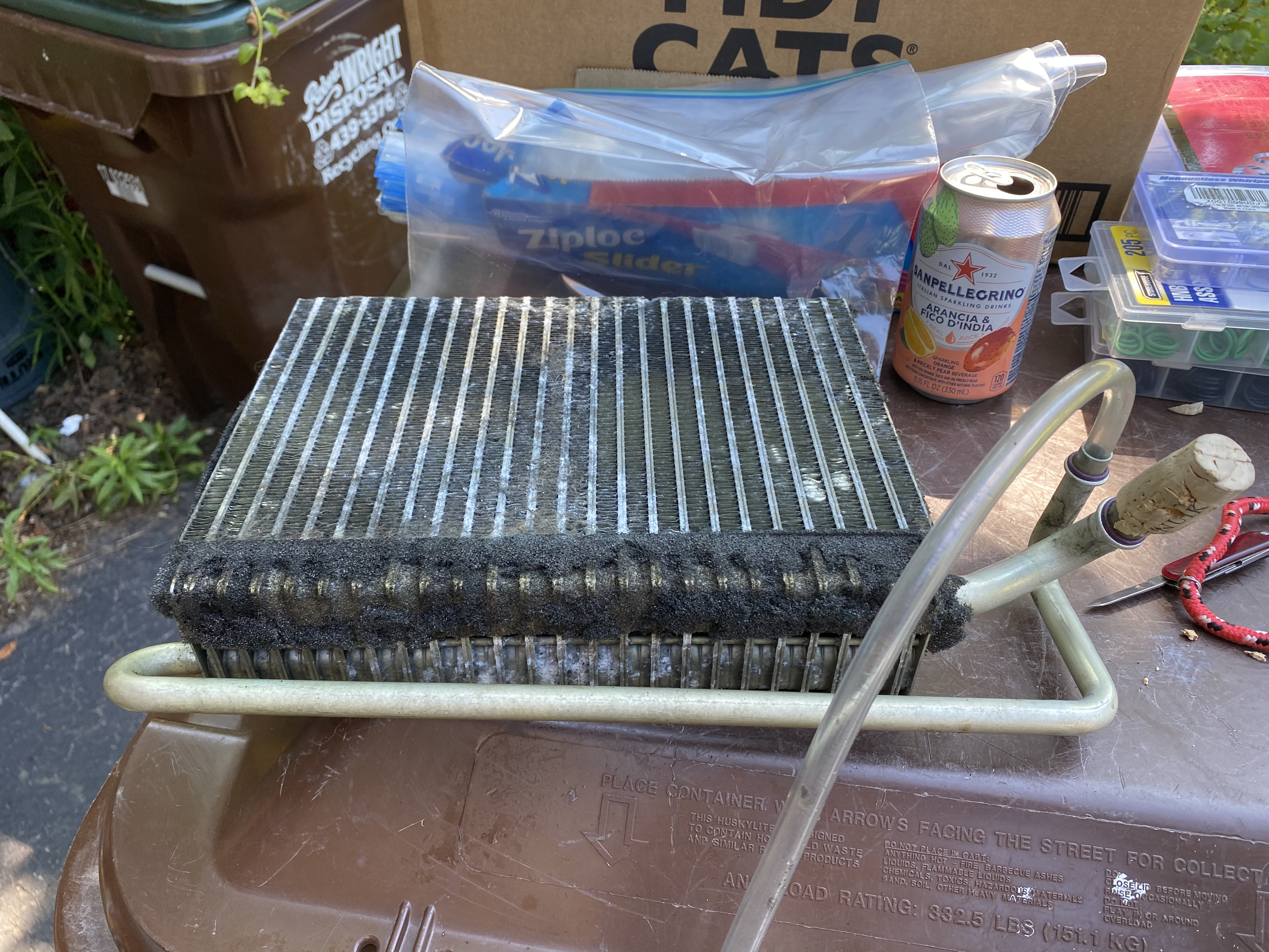

I rigged the evap with a plug and a hose to deliver 3 psi air and submerged it in the bowl of water
I could not find a leak or bubble.
The camera color corrected the evidence away but there is a pronounced. Yellow stain of PAG oil on this.
P80 fault testing BEHR evaporator... failure

Why only 3 PSI? Why not 100?

What pressure does the system normally run at? I would have thought way higher than 3psi??
It could be that the old oil has congealed into the hole (assuming there is one). Also, you have assumed this is the problem, it may have been a bad seal between the pipes and not the evaporator itself.

It’s a TX system so it would run at about 30-60 psi in the evap. When my actual P80 evap went I could see the leak at 3-5 psi easily
The PAG oil and dye stain is clear evidence of evap failure
Upshot. It’s nice to confirm evap failure by finding a hole but false negatives are a possibility using compressed air

If thats the low pressure side then maybe 20-30 psi would be a better test for checking for air bubbles. It wasnt a catastrophic failure as it kept running, so i believe it is safe to assume that the fault would occur at higher operating pressures. It would probably be difficult to make a 20-30 psi seal so this was the next best test in my opinion.

I believe when the engine's not running the high and low sides equalize and the evaporator can have upwards of 100 psi in it. At 100° the PT chart shows 124 PSIG:
https://www.forane.com/export/shared/.c ... -chart.pdf
The PAG oil clearly indicates that there was a leak. But the very slow rate of leakage suggests a hairline crack to me, perhaps it only opened up when the pressure spiked on a really hot day?
