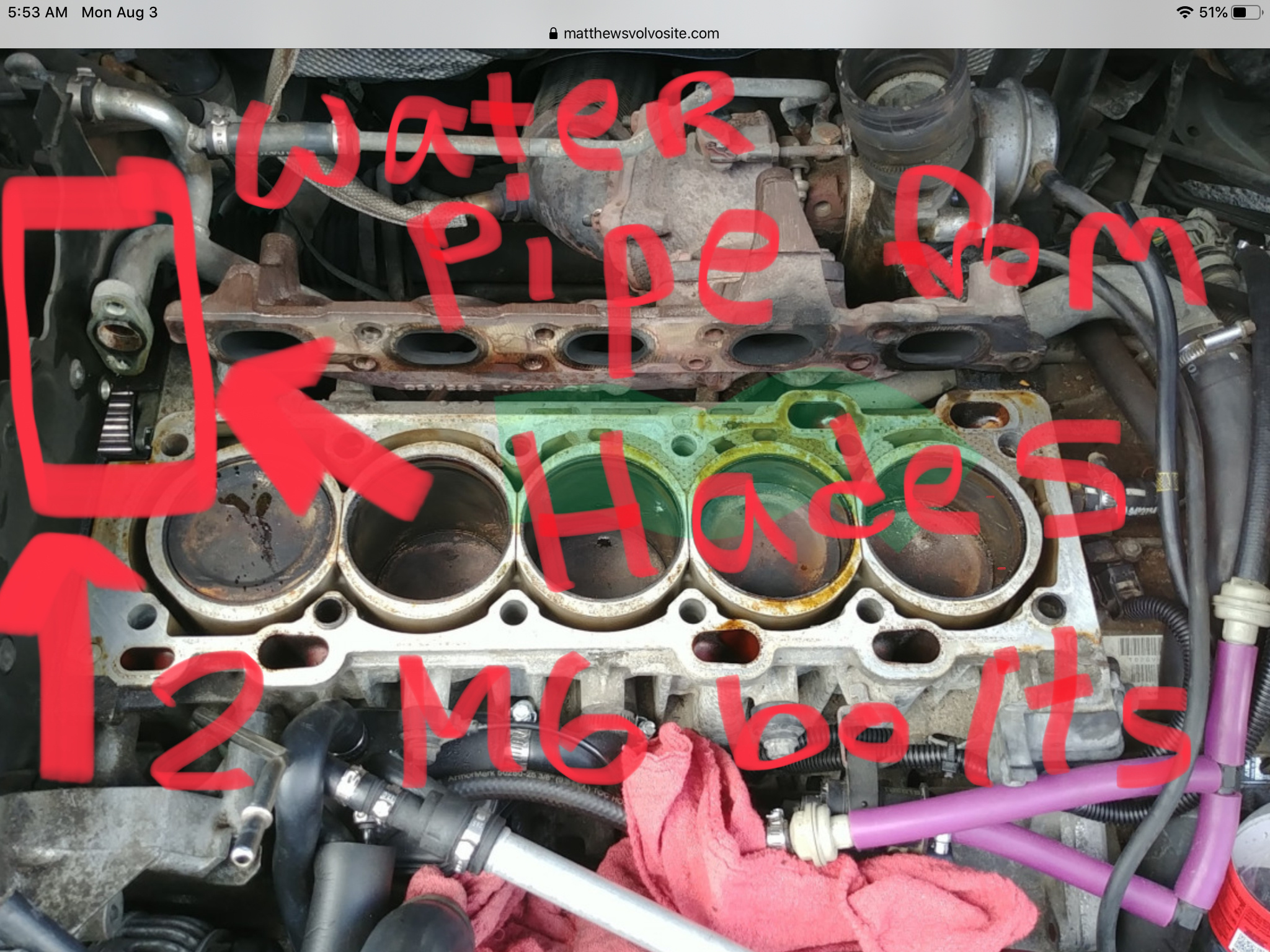

Hey abscate, can you add a picture of the location of the offending article if you have a chance? For the life of me I can't picture what bolt you are talking about and where it fits.

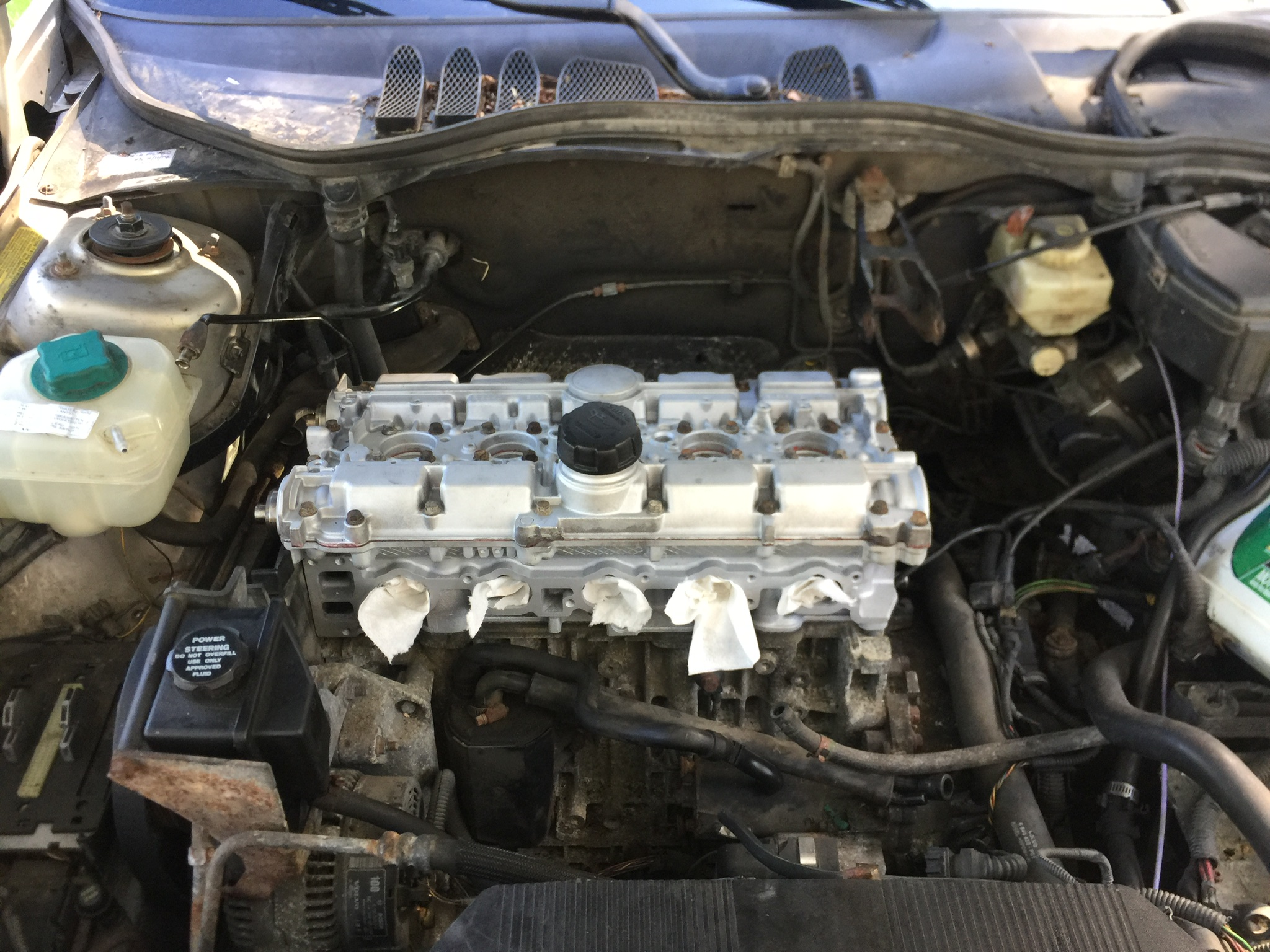

These bolts (firewall side of the head) have to be the absolute worst part of installing the head.
- Posts: 36137
- Been thanked: 4063 times

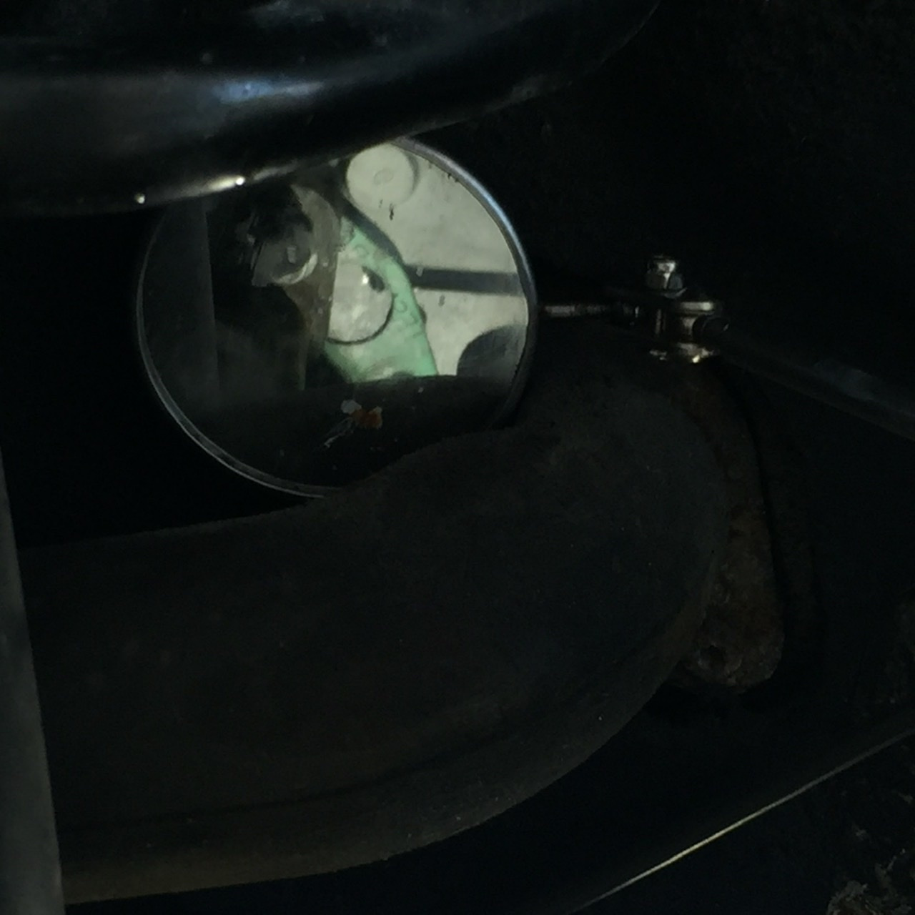

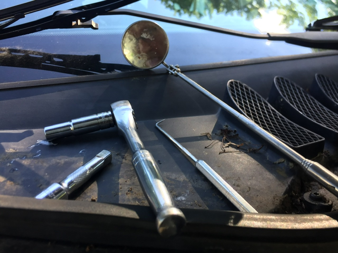

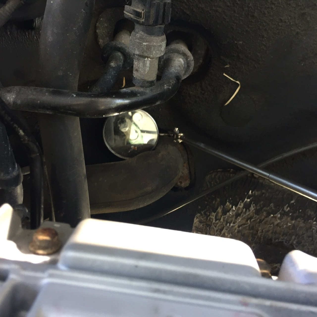

There is a secret. Leave off the last exhaust stud untIl after you fit the gasket and bolts for the water pipe.
Use straight pick to hold top gasket in position, install lower bolt loosely
Remove pick, install upper bolt
The mirror placement
Install the gasket
Install the gasket

Yes, I took this off again to get the pix.

Heres a picture from Tys threadscot850 wrote: 31 Jul 2020, 11:12 Hey abscate, can you add a picture of the location of the offending article if you have a chance? For the life of me I can't picture what bolt you are talking about and where it fits.
