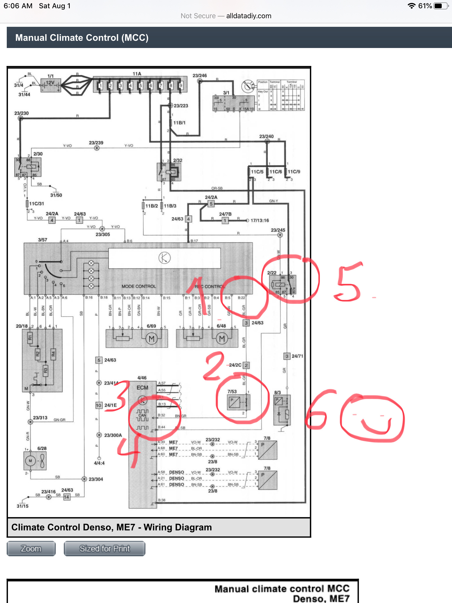

This is from a 1999 but IF it’s DENSO it is probably the same
1, MCC sendssignal to ECM from MCC pin B22
2 It has to makeup through the closed low pressure switch , jumping this switch won’t turn on the compressor like your Uncle Buick, it just enables the ECM to turn in the compressor. A well meaning friend putting voltage here can cost you a lot of money.
3 the ECM received the signal on pin B32
4 if software agrees,it grounds the compressor relay at pin B44
5 compressor relay powers ACcompressor
6 the compressor makes cold molecules and sends them to you in the cabin
Very Swedish
Very Swedish

So your troubleshooting has been perfect

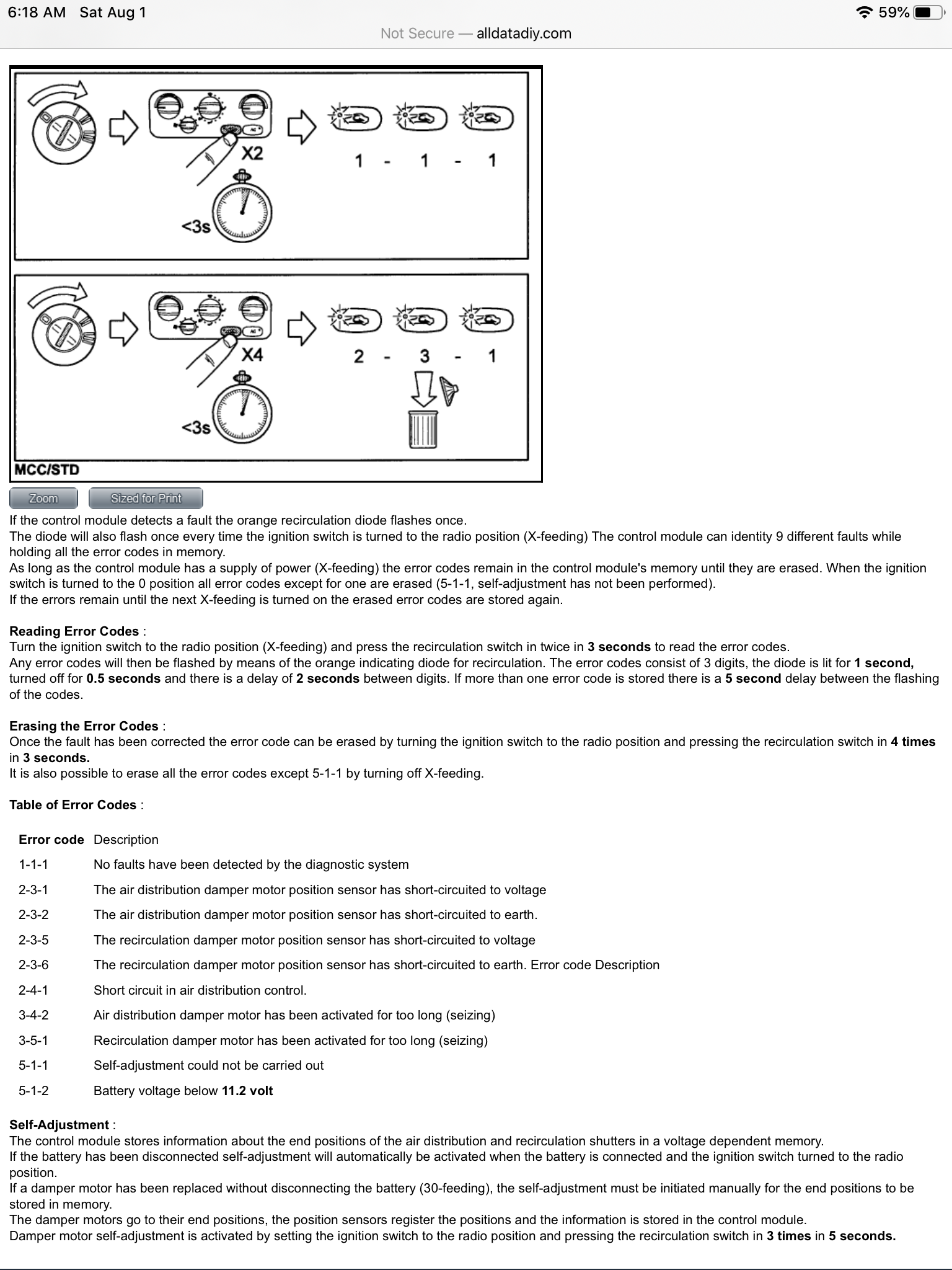

Try key position I, then pushing the recirc twice to read the little flashing lights on the MCC CONTROL UNIT and see if you get 5-1-2 low voltage

I'll take a look for errors on there today, thanks!
Although jumping the connector at the switch won't trigger the compressor clutch directly, it should still provide the ECU with the required signal to ground the compressor relay. That signal should be 12v, right? Because that's not what I'm seeing there.
Should be the same though looking at that diagram, although 1998 NAs are M4.4.
I love the bottom illustration.

It seems the ‘98 may not be able to read MCC codes that way. Every time I try I get nothing.

The signal through the low pressure switch could be 12v or 5v logic , since it’s actually controller to controller signal
10V doesn’t sound Right though
I’ll check Abbys after CHE beats ARS this morning

I thought it could be a 5v reference, but the fact that my meter showed 10v led me to believe it should be 12v.

With kpII I turned on blower and AC, and the command voltage at the low pressure switch went from 0mto 3.5V
That’s probably a TTL signal from MCC controller to ECM
