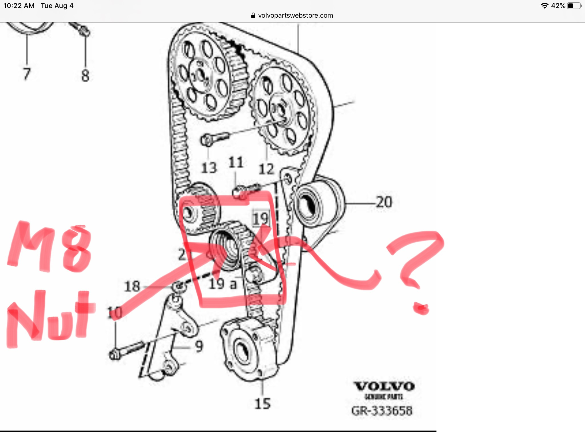

I had a mechanical tensioner moment and undid the nut on the hydraulic tensioner in Earl
I think I just need to remove the whole thing to counterhold and tighten the tensioner axial nut again
See pic...the detail isn’t given there
P80 hydraulic tensioner detail 9135036

Yikes. 19 and 19 A showing as NLA at Volvo web store? ( update, orderable at FCP)

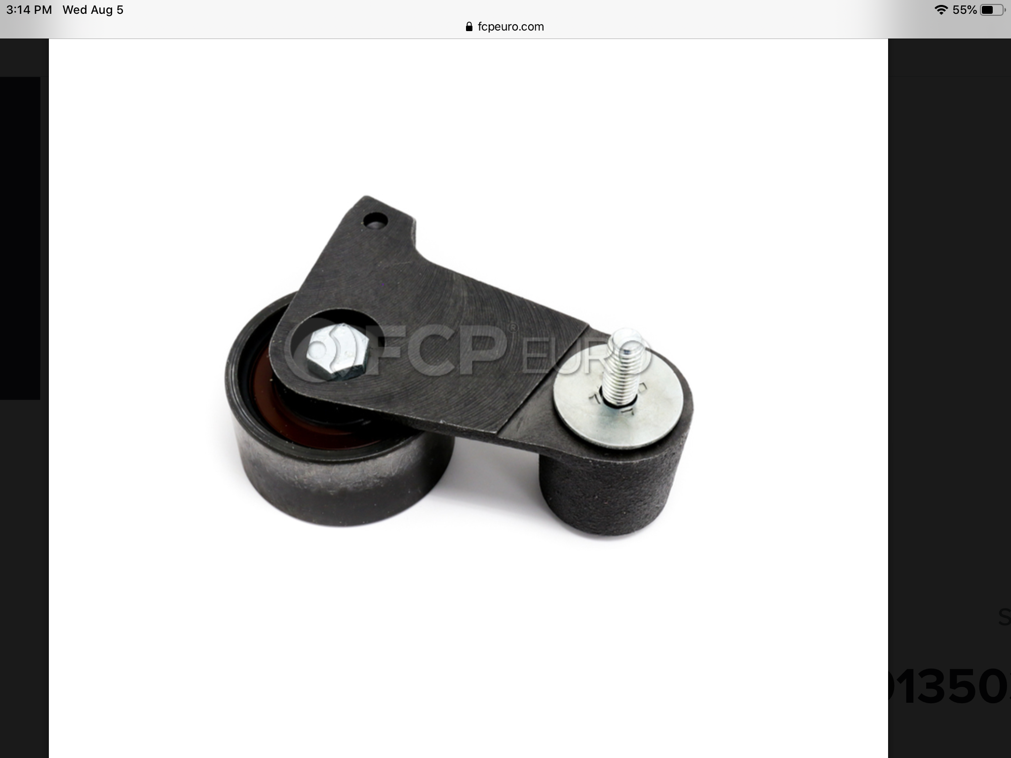

This is a hydraulic tensioner.
I undid the wrong bolt , the one in the actual rotating part , and can’t tighten it now
I tried to remove the T45 holding the assembly on and couldn’t move it.
Sigh.
Sigh.

I need a short, strong T45 bit to solve this removal.
Found a picture at FCP showing the counter hold need
