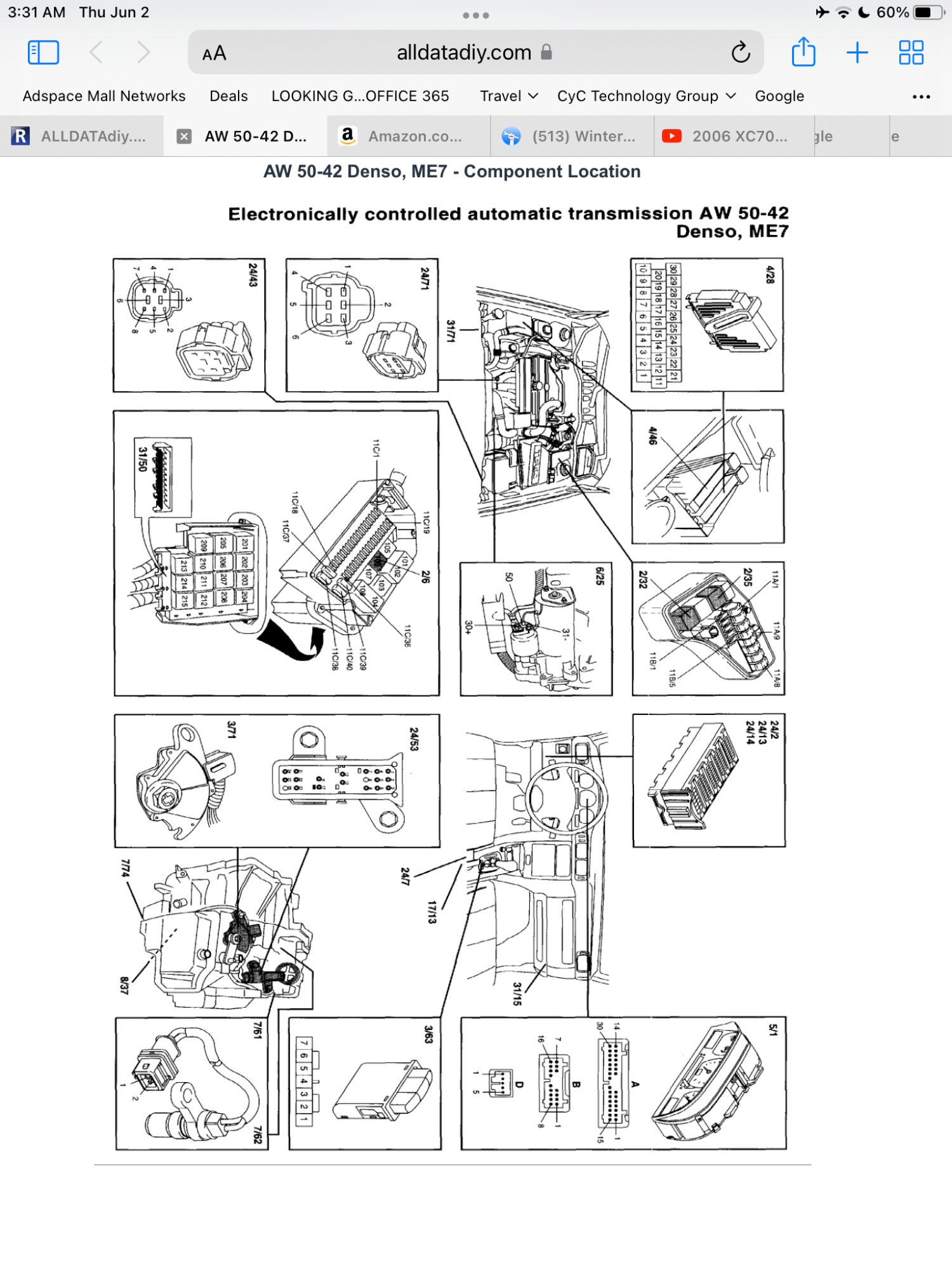

Not sure why, but the "W" button no longer works. It used to work before, when I tried it on a really rainy day to see what it did, if anything, to help limit wheel spin. Now I can press it as much as I want, sitting still in Drive, and it doesn't do anything. No more "W" showing up where it shows "D" like it did before.
I don't use it, but I was wondering if there was any other problem that I should be concerned about since it doesn't work now. Transmission problems, STC, ABS, or anything else that may be effecting the wet driving mode and keeping it from working?

It gets sticky soda and stuff in it, sometimes, then the button won’t switch. I would Leavitt alone for fear of being stuck In W

The first thing I would do is disconnect it and see if it functions as a switch I think it is a simple switch thst toggles pins on the TCU…
On the 1999 itsimply grounds pins.
