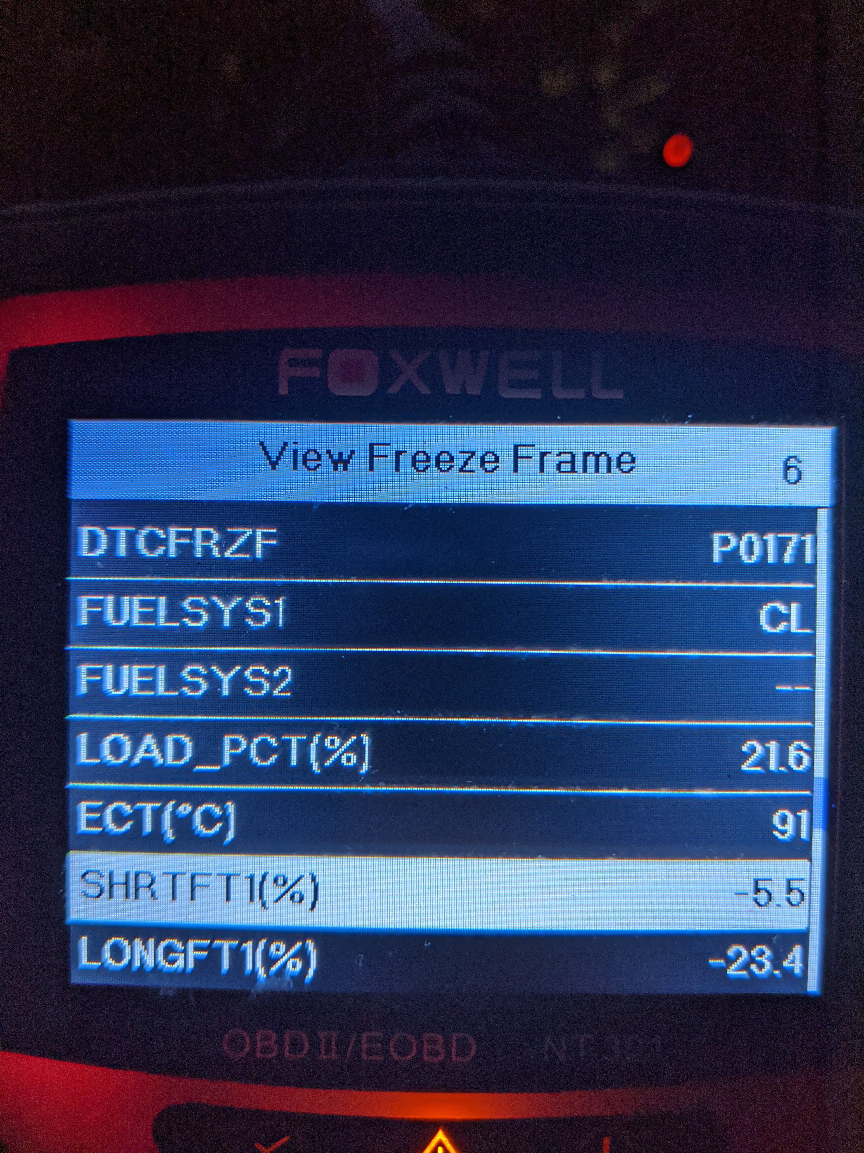

I've been a lurker on these forums for the last few months and I've encountered a problem on my 850R that I can't wrap my head around.
I'm getting a P0171 code but my LTFT reads -25. I've pulled the spark plugs from the car to check and they were black and smelled like fuel. I'm just not sure how I get a lean code, but I'm running extremely rich.
My STFT is all over the place and I can't seem to pin any sort of pattern. I did notice recently that when I accelerate my STFT goes rich very quickly.
Boost gets up to 10psi but I do feel acceleration isn't quite as snappy as I'd expect it to be.
Overall, the car starts up fine and drives without much issue.

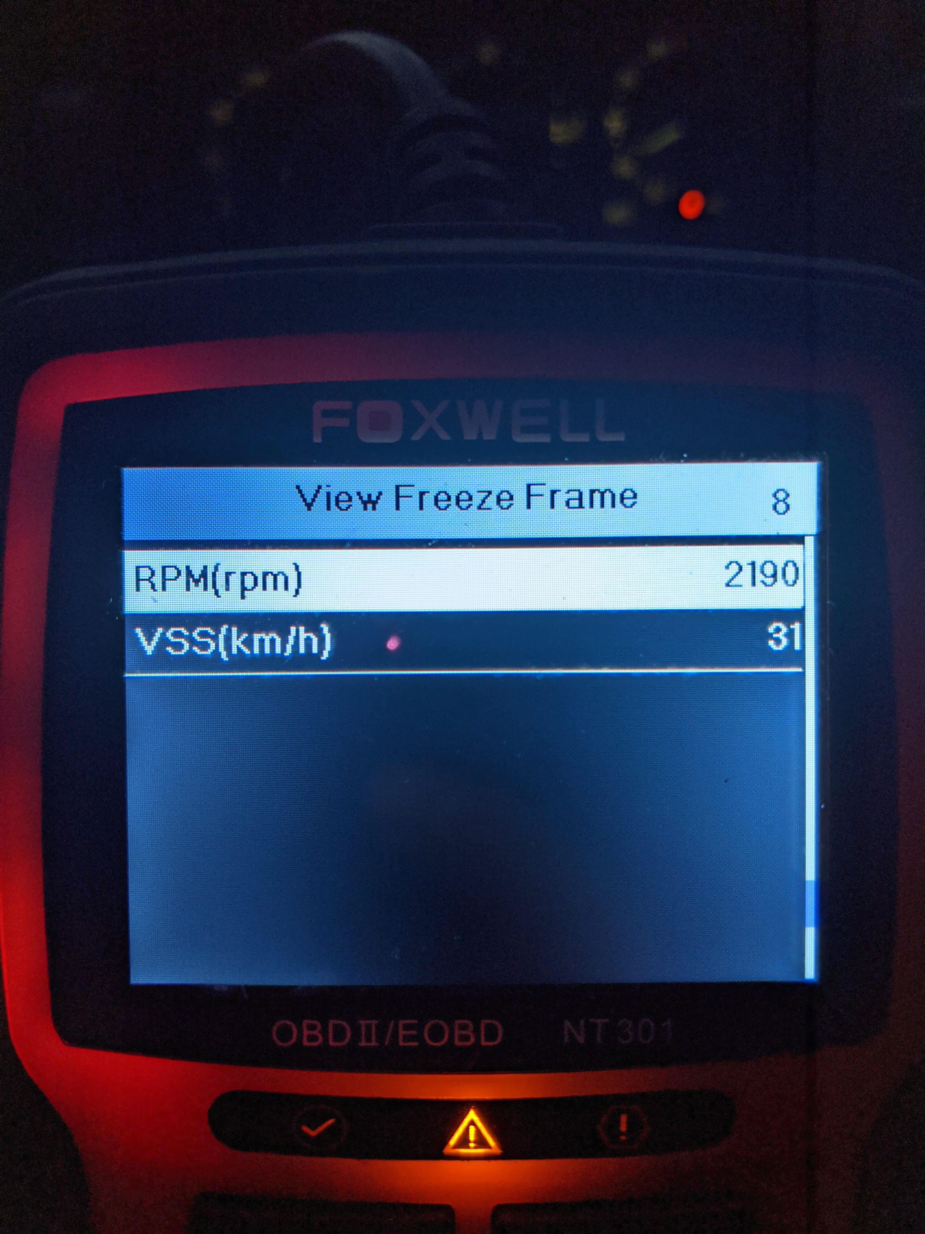

I've included a list of mods that I have currently and the steps I've taken to try and address the issue. I've also included a freeze-frame based on the results of my scanner.
I plan on doing a compression test, but not entirely sure how relevant it might be.
Any help would be appreciated, as I'd like to get this running right and fix this code once and for all.

Lean Code P0171, but LTFT is -25

Leak in the exhaust system.zrjn89 wrote: 06 Aug 2020, 22:37 I'm getting a P0171 code but my LTFT reads -25. I've pulled the spark plugs from the car to check and they were black and smelled like fuel. I'm just not sure how I get a lean code, but I'm running extremely rich.
1. Air gets sucked into the exhaust.
2. O2 sensor detects the unburned oxygen.
3. ECM interprets it as too lean, dumps more fuel in the cylinder to compensate.
4. Extra fuel does not burn because there is not enough oxygen in the cylinder.

Find the leak before you start changing parts. Try using your ears and eyes first. You might plug the tail pipe start the engine then use your eyes and ears. The back pressure will shoot out the leak.zrjn89 wrote: 07 Aug 2020, 10:51 This makes sense, should I just replace the exhaust manifold gasket? The downpipe, and the exhaust look to be in great condition.
Smoke test the exhaust system. Plug and inject smoke up the tail pipe or plug tail pipe then inject smoke into a O2 port.

Have you checked intercooler and the connector hoses? The negative numbers indicate taking fuel away. I would expect the rich P code but scan tools do make mistakes. The black plugs back up the negative numbers from the ECM dialing down injector open time. What is fuel pressure? Is fuel pressure regulator leaking fuel through its manifold sense hose (vaccum hose)?
