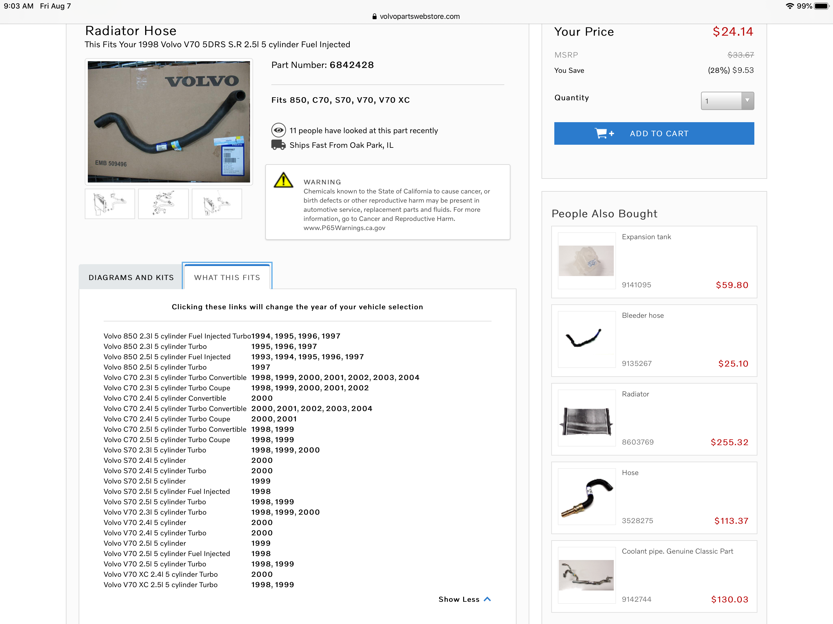

I ordered the Rein aftermarket lower rad hose as a replacement with good reviews
URO failures reported in 4 years here, btw.
The water pipe side was not formed correctly and would not fit on the car.
I will return to FCP
Update. This is the wrong part for my 1998

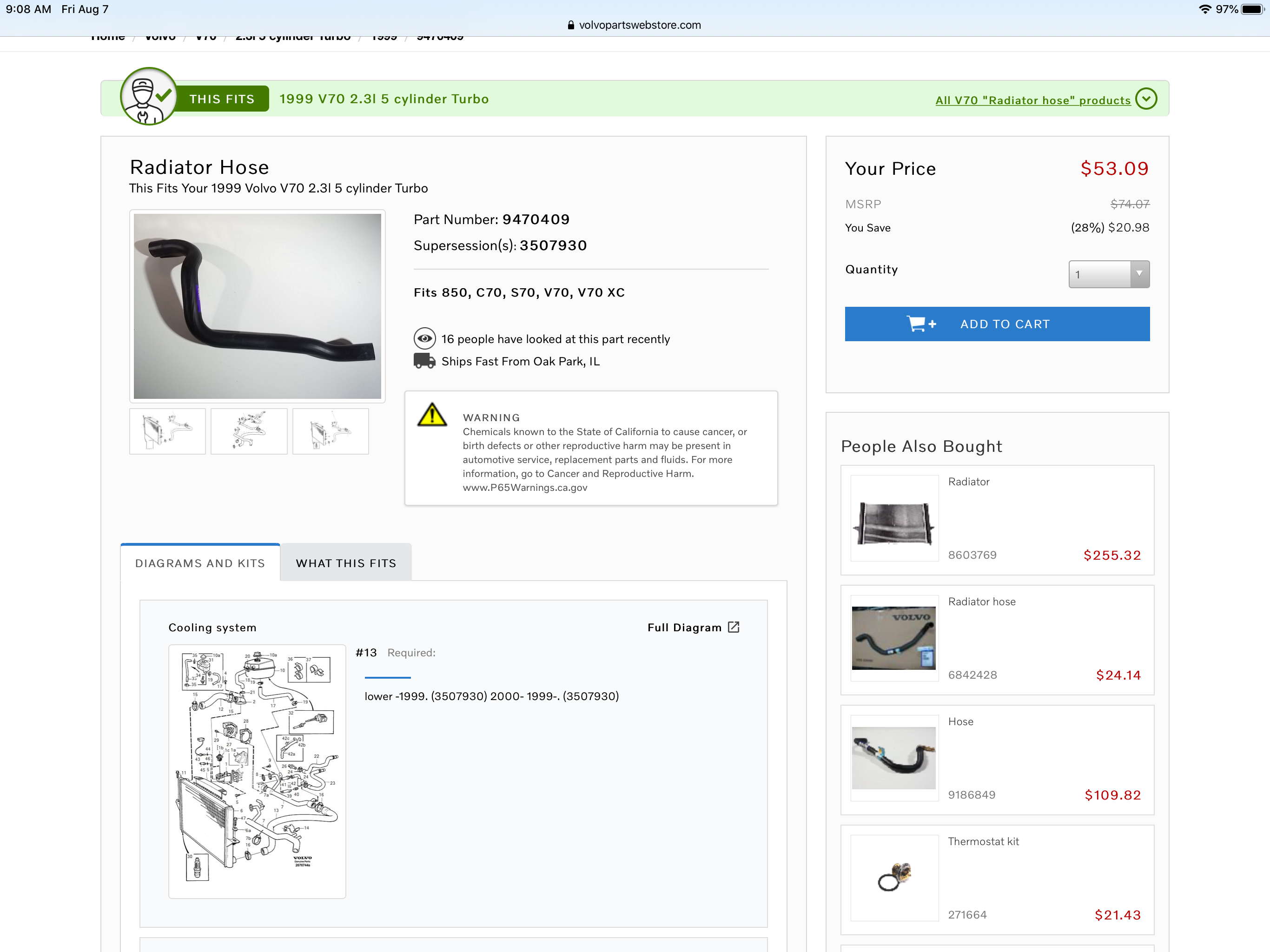

There is a change in the lower radiator hose starting in the 1999 MY
P80 lower radiator hose 9470409 Rein CHR0127R for 1999- only)

- Uhhhhhhhh...No.
- C89E6E65-C11E-4099-8712-C9A0739B1ABB.jpeg (100.13 KiB) Viewed 1610 times
- Wtf?
- AC4B58A8-8623-4B26-B8CE-B23079A4351B.jpeg (94.93 KiB) Viewed 1610 times

Fitment chart from FCP shows compatibility from 1994-2000, so that needs to be improved.

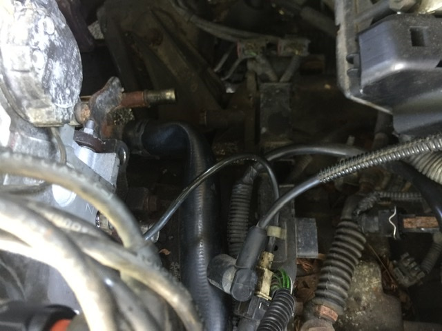

I’ll check my 1999s for this angled fitment and reply
This the lower radiator hose, returning “ cold” coolant to the block via the water pipe on the rear of the block, right side of engine

Is that your right or the engines right?abscate wrote: 07 Aug 2020, 04:57 Fitment chart from FCP shows compatibility from 1994-2000, so that needs to be improved.

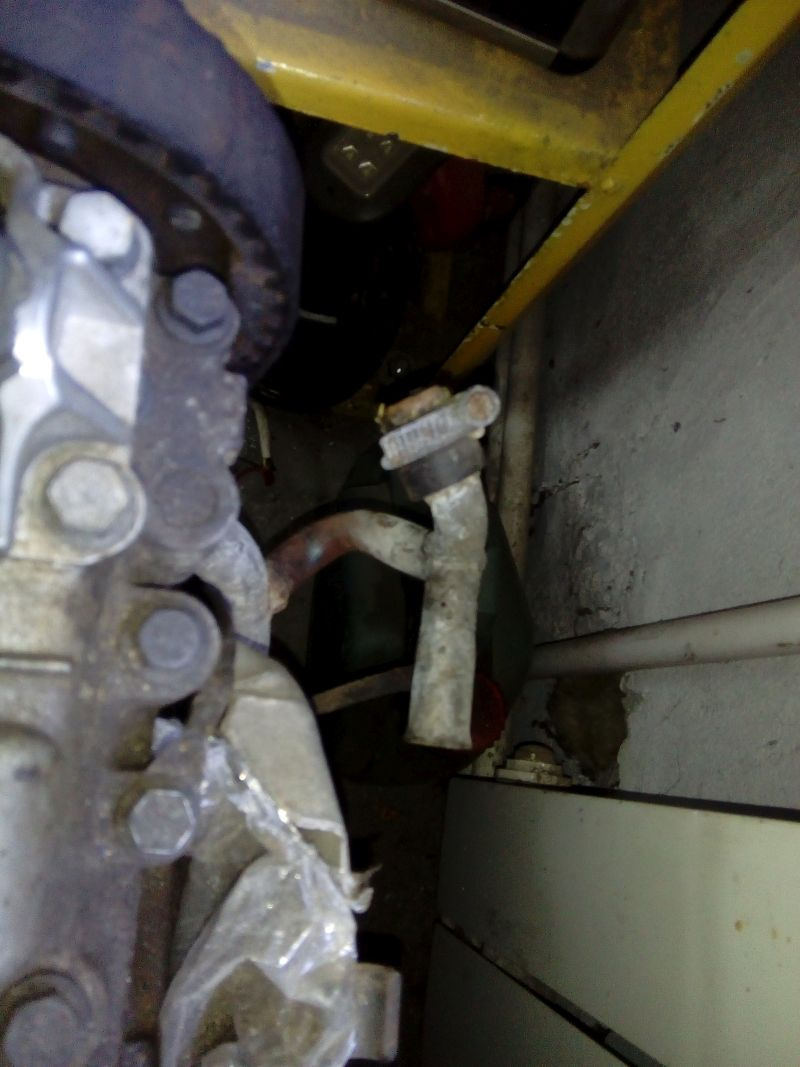

It is a 2000 2.0T from coupe. Angled inlet and another connection with TC cooling pipe using an O-ring.
Much more reliable connection, than that damned short thin hose with 2 clamps.
- IMG_20200807_144138.jpg (184.04 KiB) Viewed 1586 times

I assembled my own engine from 2 different. Block is '98- with internal oil sprayers and heat exchanger on the oil sump. So I'm free from those oil hoses to radiator, they leaking always
. Coolant return pipe is as on photo above. Cylinder head is -'98 without VVT.

Yes,Azik, I confirm my 99 has the angled end of the water pipe so that part will fit that car
I’ll find the right numbers and post up
Thanks for your diligence and detail!!

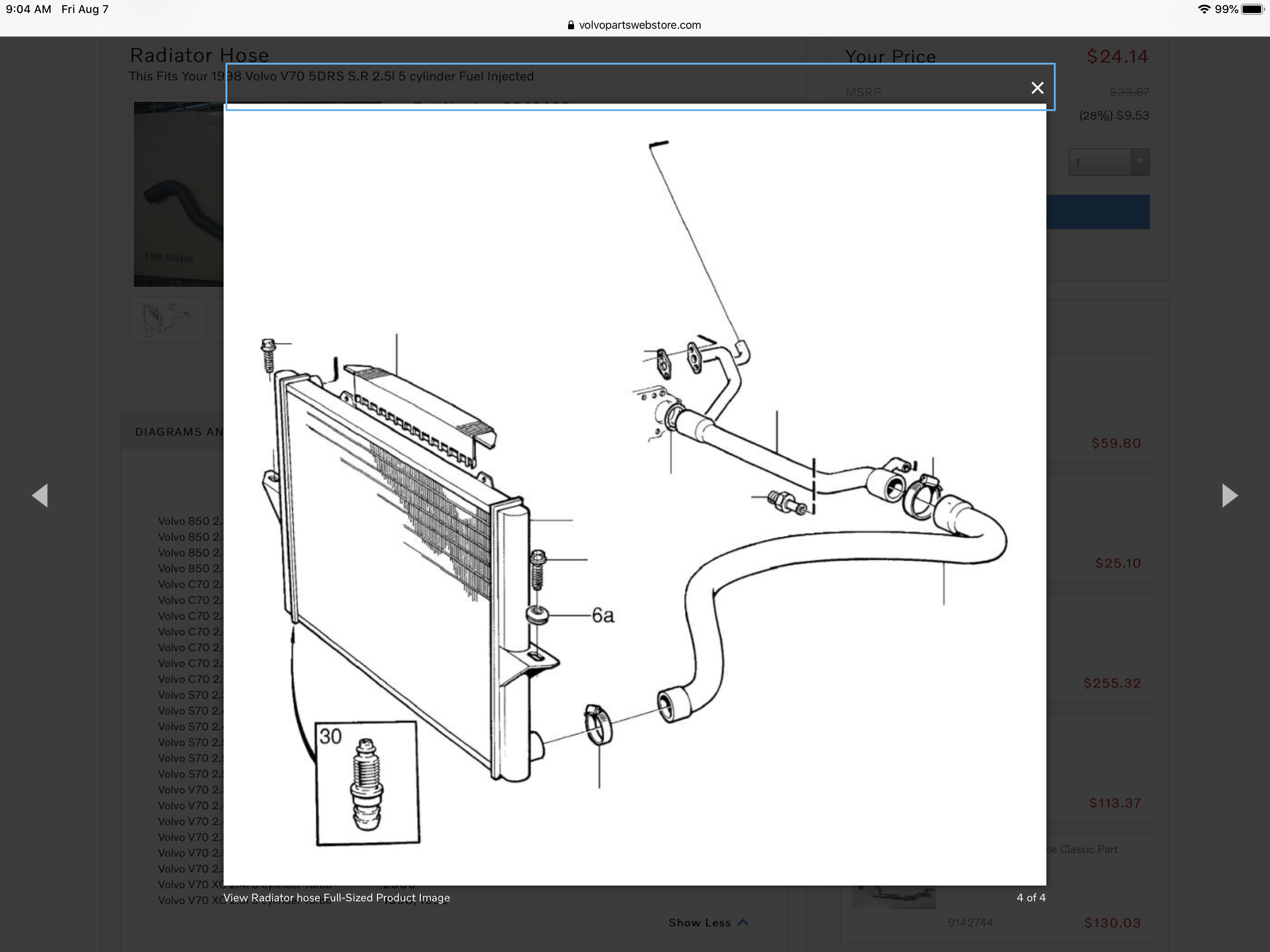

Well here is the Volvo pages for the 1998 model with straight connector - note the fitment chart - that’s wrong!
-1998 part 6842428
-1998 part 6842428

And here is the same for th e1999
They use the same diagram , but then have a parts break for the angled connector, but don’t show it.

Executive summary
If you have the straight water pipe, heads out to rear of engine, left side of car, you need part number 6842428 or equivalent
If your water pipe connection angles forward to front of car, you need part 9470409 or equivalent
