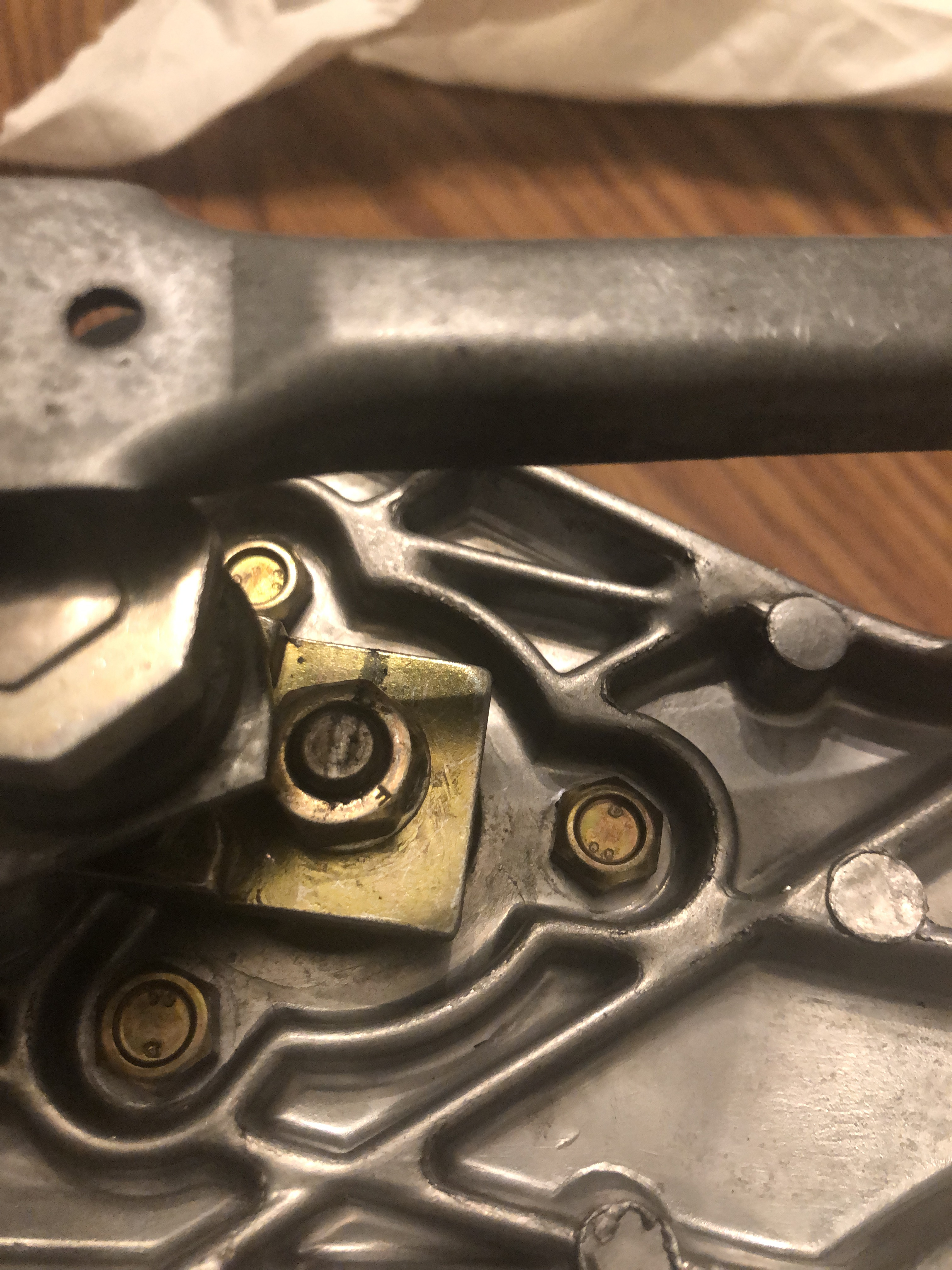

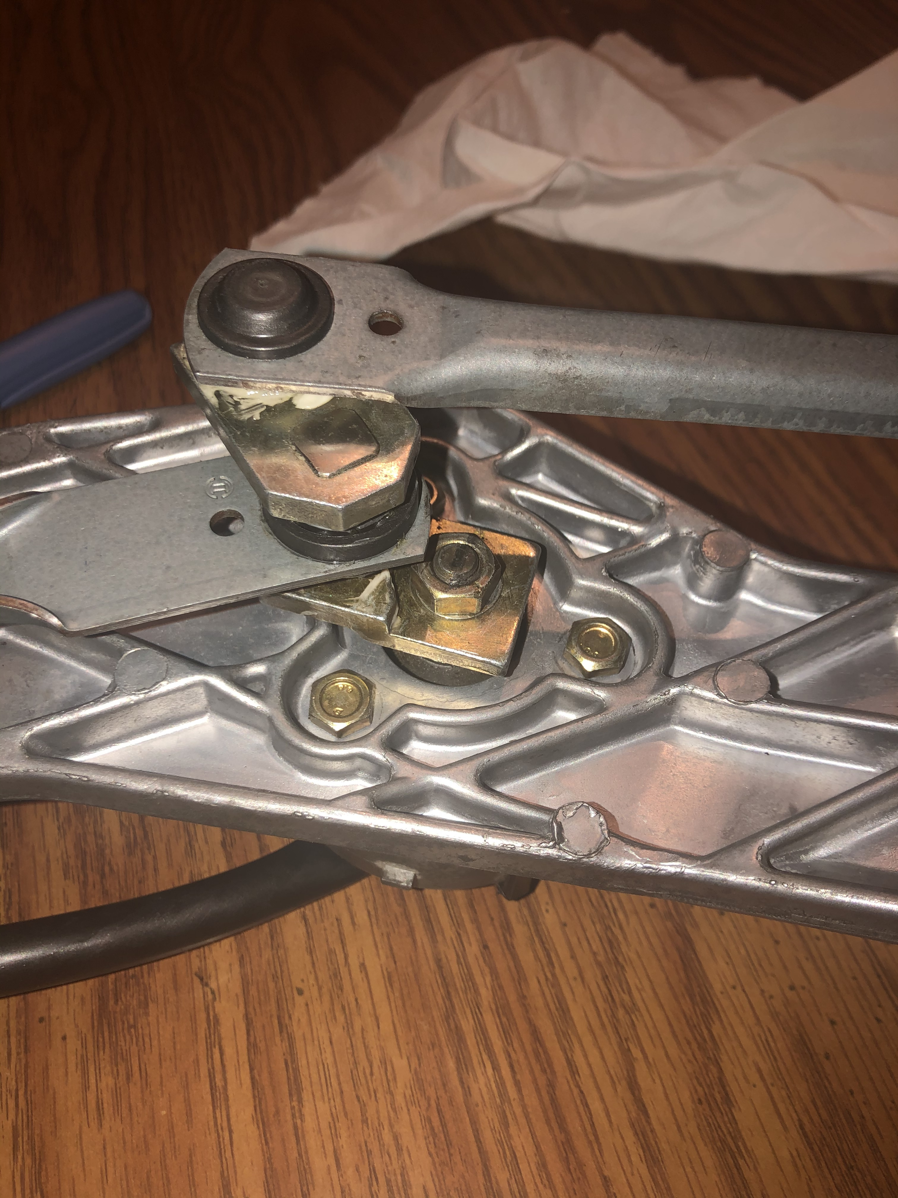

Hello, I went ahead and took the wiper transmission apart and found one of the shafts completely siezed. I had to hammer out the shafts with a punch. I lubed them with antisieze and grease and the shafts work perfectly. Now I got another problem I can’t get the connecting arms to sync properly.
I marked the shaft on the motor to the bracket before I took everything apart and the wipers were in the park position. When I loosened the nut on the motor it did rotate the motor maybe a quarter turn at the most. Here are some pics

Not a great picture but does this help?
https://www.b-parts.com/en/store/produc ... 1996-1997/
Maybe enough detail to get the correct positions.

Then of course this may help too:

Check the bearing mounts and rod bushings. They can break, crack and wear out.
