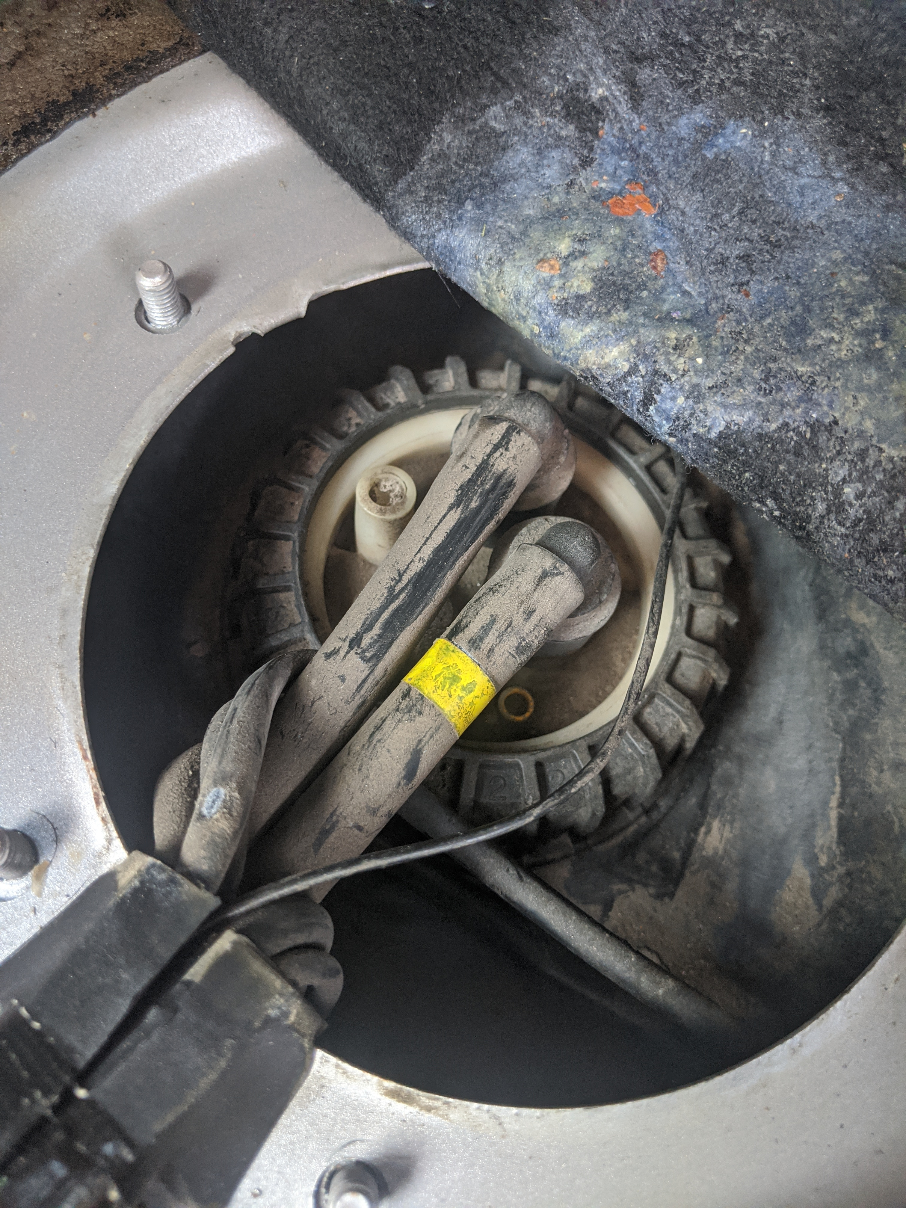

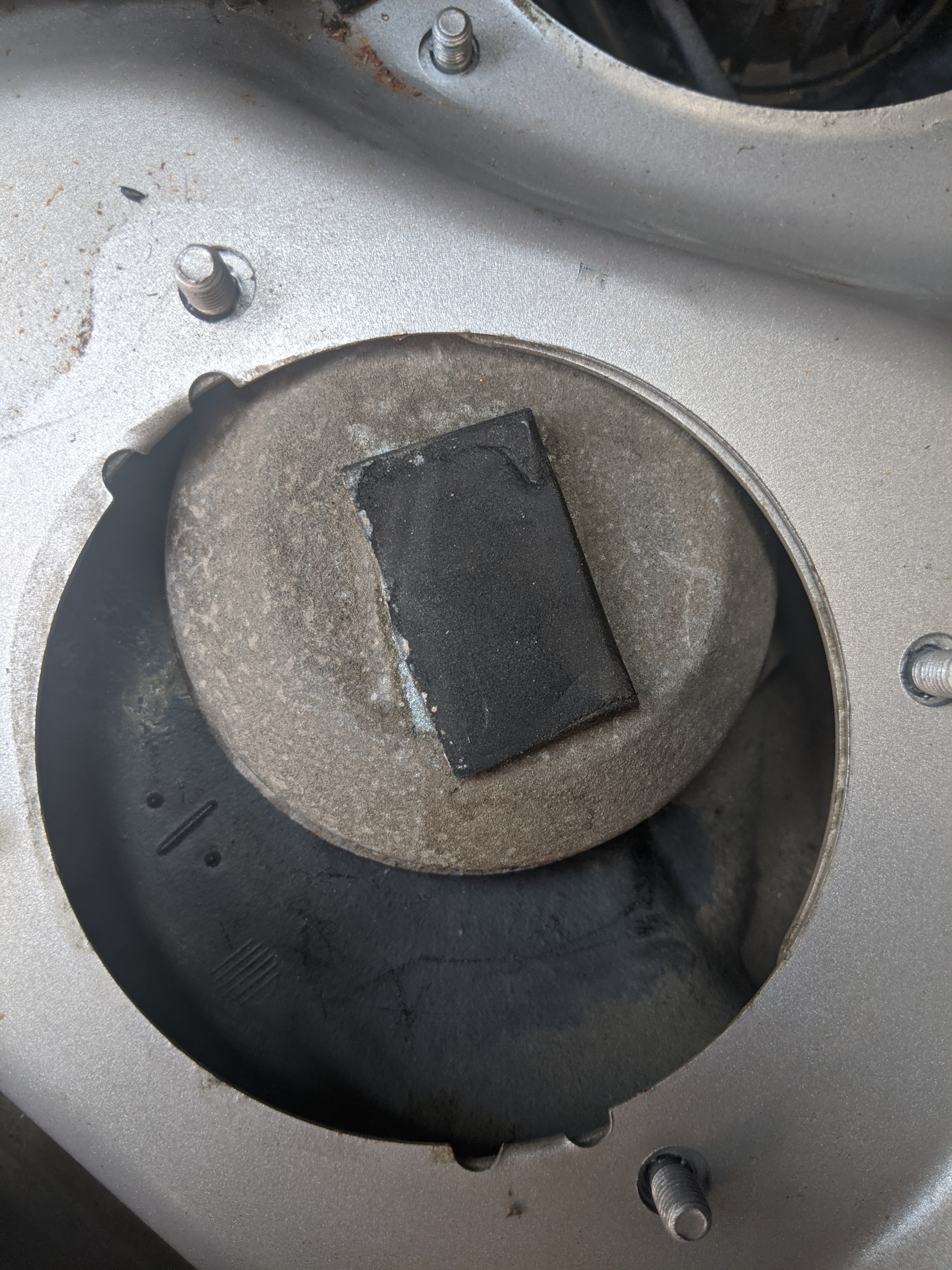

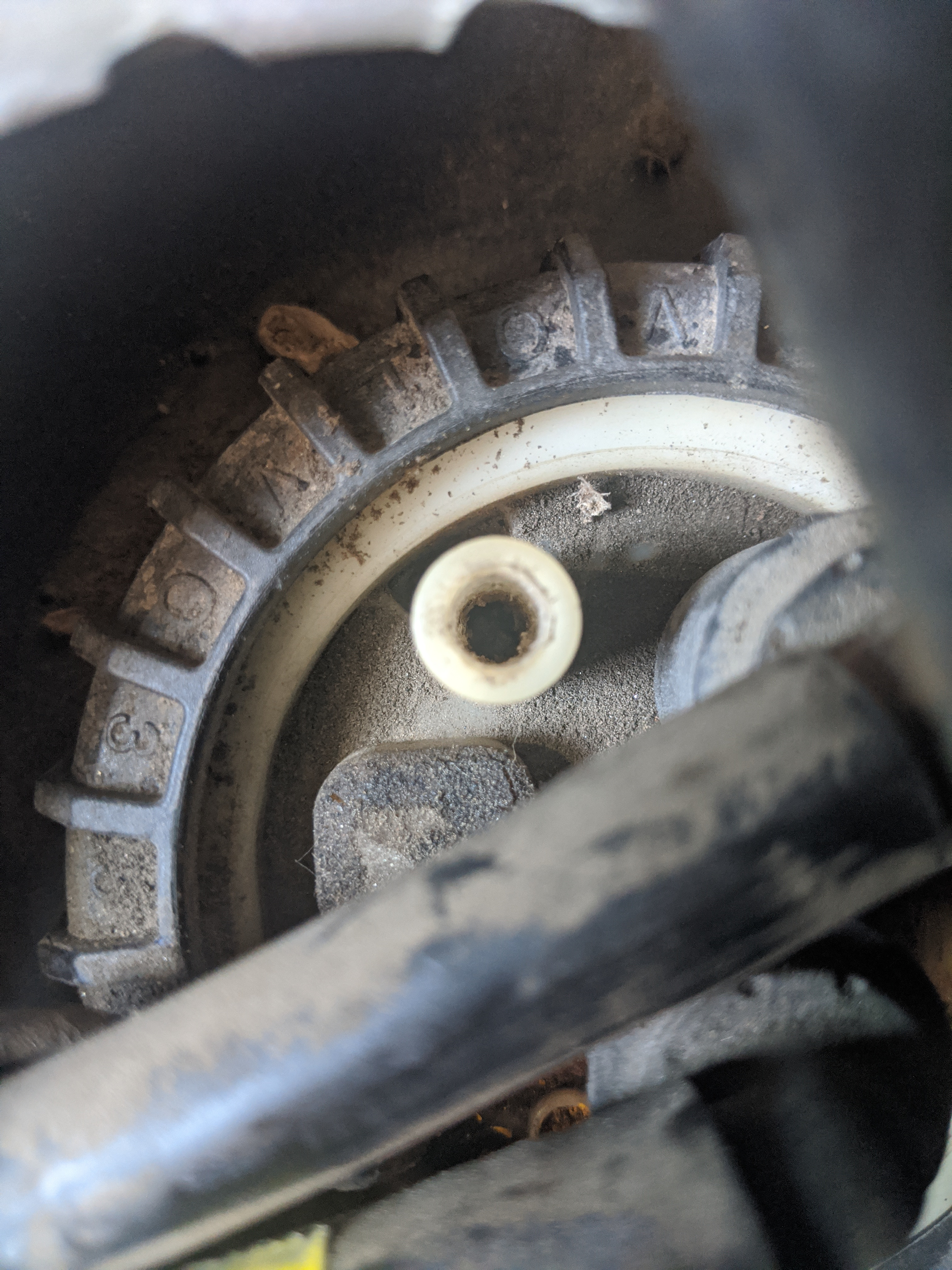

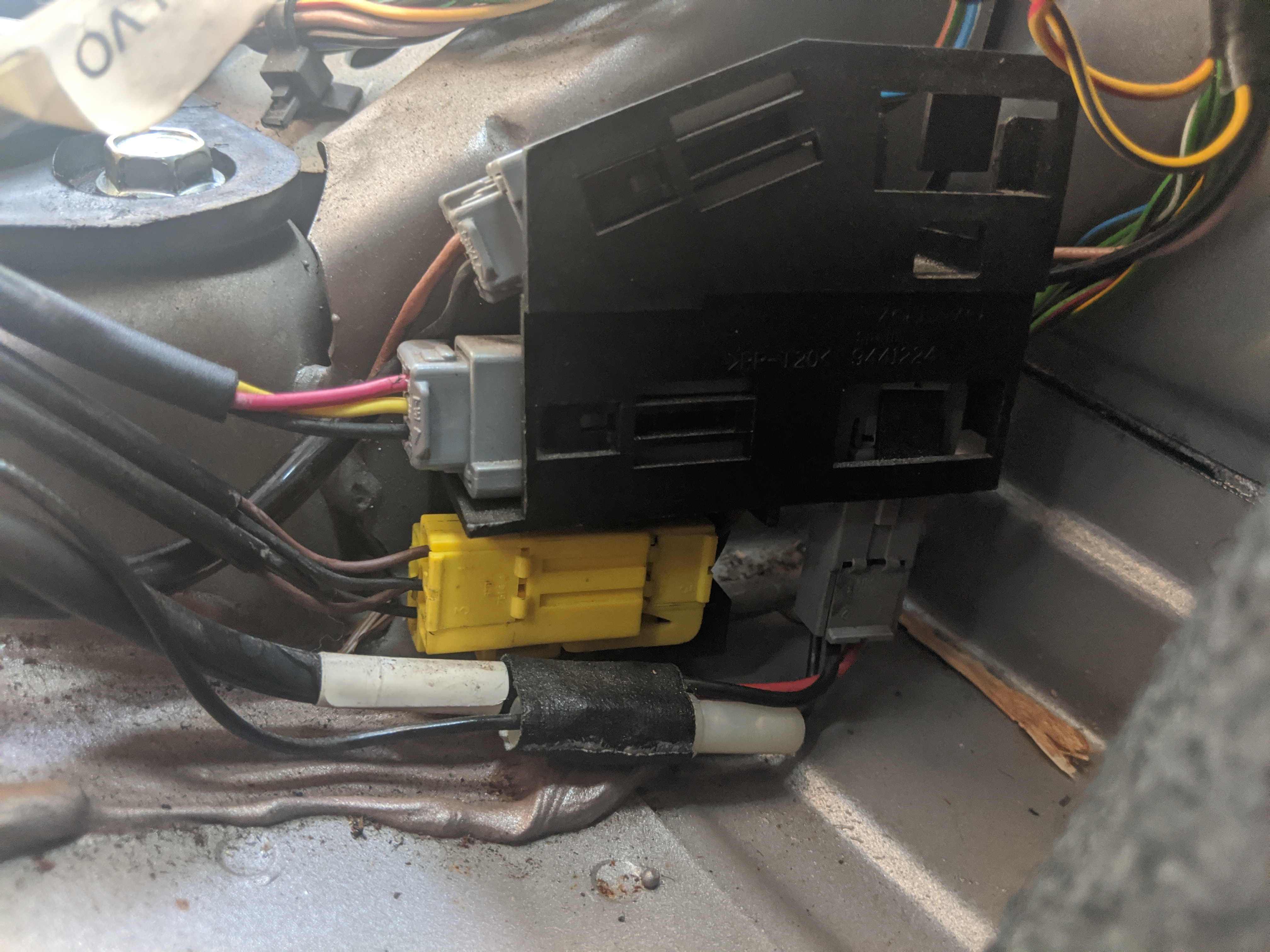

Got back there and pulled the connectors on the black bracket one by one to clean them with electrical connector cleaner. Also found some spider webs in the little white tube and cleaned those out with a pick.
Definitely smells a little like gas back here, without even having the car running, so there could be a leak somewhere? Or is that normal by the fuel pump?

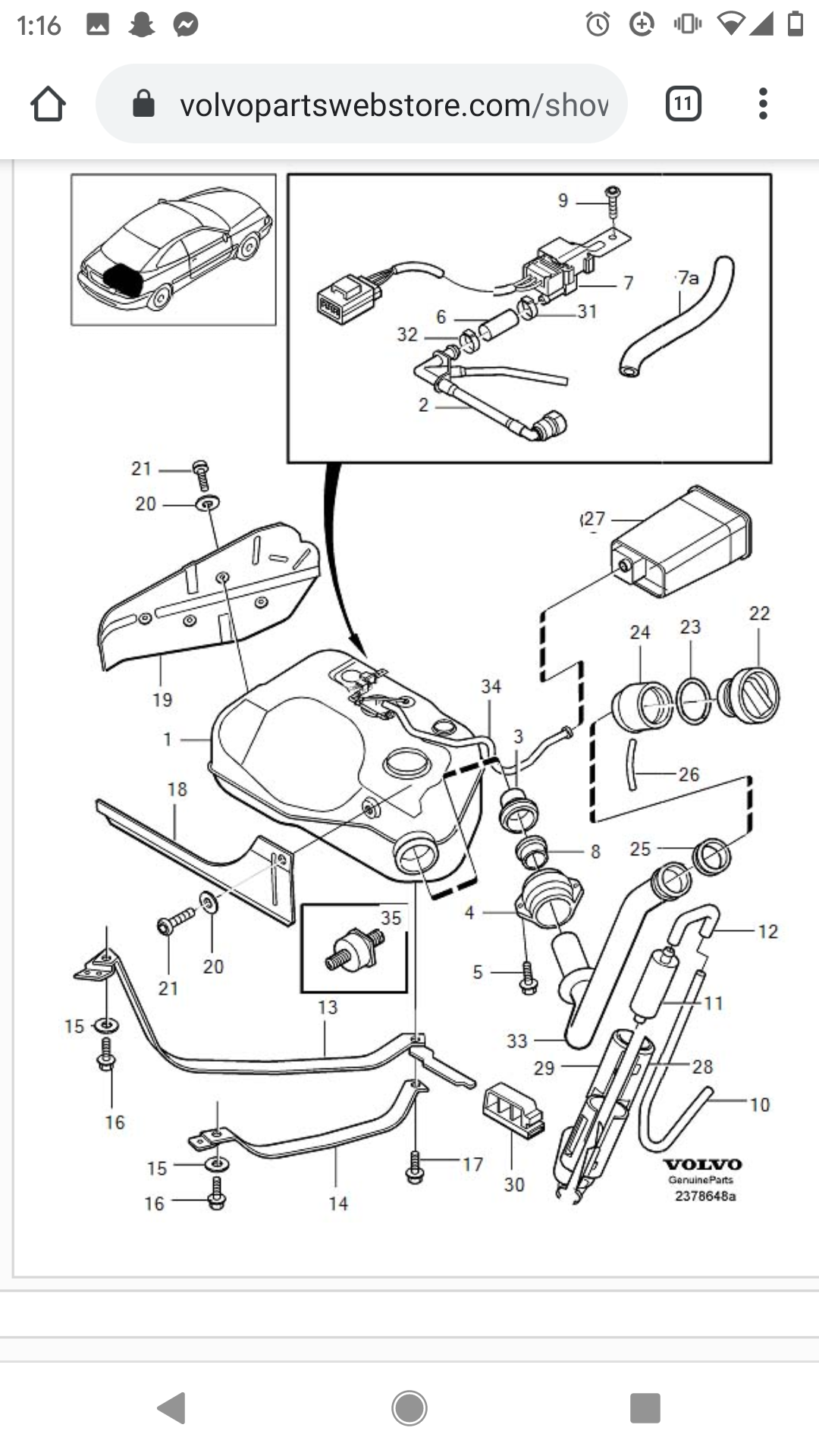

Also from taking this apart and being back here, it looks like the actual sensor itself (#7 on the diagram) is not accessible from the top and I'd have to drop the tank to get to it?
Otherwise I didn't notice any frayed wires or broken connections back here.

Just looking does not cut it. Break out the Ohm meter and measure.smacknab wrote: 14 Aug 2020, 11:26 Otherwise I didn't notice any frayed wires or broken connections back here.
Checking for shorts is easy. Just check for continuity between two wires that should not have continuity. If none, the wires are not shorted.
Opens is a little harder. On one end short the two wires. Then check for continuity at the other end. If none one of the wires is open.

So i unplug the battery, disconnect the correct plug on the black bracket in the picture and test each side of the plug? I'll have to look up a guide for testing as I'm not following 100%

For shorts you pull the plug and test for shorts between each possible pair of wires in the harness. Keeping in mind a ground to a ground will show as 0 Ohms.
If you don't have fundamental electronics knowledge you will need to have somebody test the wiring for you. If this is the case you are not alone. Plenty of professional automotive mechanics do not fundamental electronics knowledge. That is why automotive electronics specialists get the big bucks.

Rick I'll follow your advice and pull out my multi-meter to test both ends of the cable. I'll test the fuel tank pressure sensor cable to it's disconnect and look for the diagram where to test the other side of the cable
