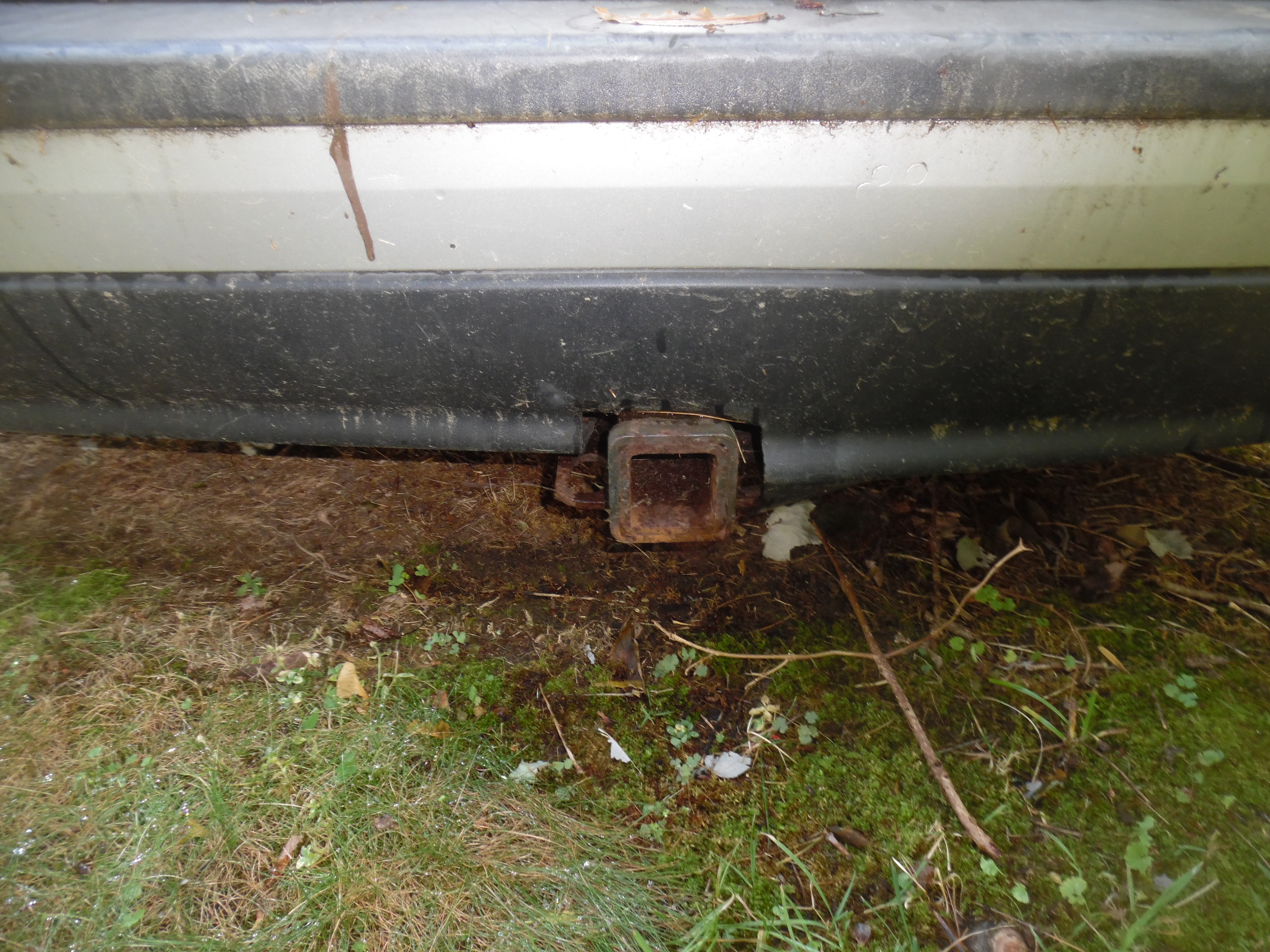

Here is a picture of my hitch. Note how the bumper cover has been cut away to allow clearance. I can't quite see whether the one you pictured required the bumper cover to be cut. I believe this is a factory hitch, I couldn't find an adapter to connect the light socket with the standard "flat four" connector on my trailer.

BlackBart
Posts: 6725
Joined: 10 Dec 2016, 17:03
Has thanked: 967 times
Been thanked: 921 times
Post by BlackBart »
Volvo factory hitch....

Faust
Posts: 396
Joined: 04 Jan 2012, 07:22
Year and Model: xc70 2008
Location: MA
Has thanked: 31 times
Been thanked: 10 times
Post by Faust »
I compared my hitch to the drawing, appears to be a factory hitch. Still required cutting away the bumper cover.

BlackBart
Posts: 6725
Post by BlackBart »
Yep, they're supposed to be that way, tucked up inside.
