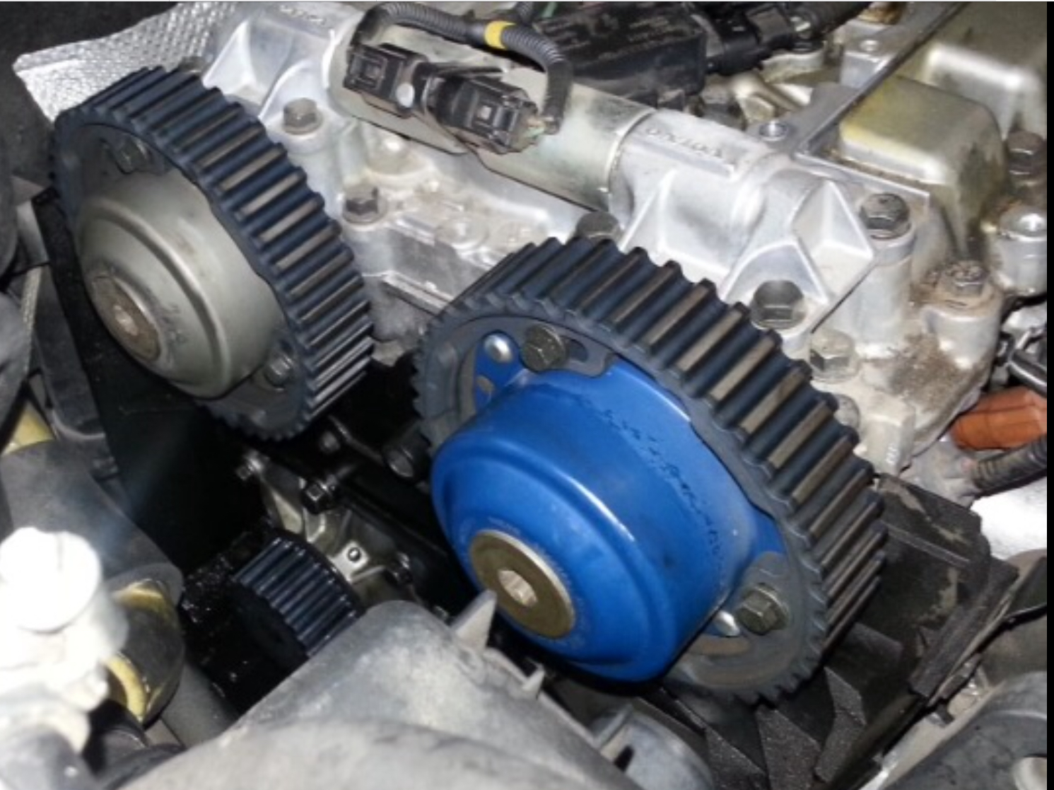

Ben would like a Aisin water pump, INA tensioner and idler , and a Conti timing belt. Ben also warns you that anything URO is creepier than guys with car covers for their car covers.
Cars Ike your 2004 have variable valve timing on one/ both cams. When you set up the timing, the marks have to be brought in turning the engine backwards,not forwards. The official procedure is the turn past the mark 1/4 turn, then go back to it.

Thanks Abscate! Ben got the Aisin/Conti kit from FCP, because I listened to you guys about brands.
That sounds daunting... Do I really need a cam gear holder tool? I'm not doing this until I feel confident about it because I don't want to break Ben and you guys don't want to read another 12 pages about me searching for Ben II.

You don’t need the cam lock tool unless you are removing VVT hubs, which you don’t need to do for timing belt.
If you lift your cover plates, you can tell us if you have one or two VVT HUBS by the number of solenoids you see

I am not removing the hubs. I'll look at them to see if anything is leaking but I'm going to let that sleeping dragon lie.
I won't have tools until tomorrow as my garage is in a separate location so no T30. Sadface. Eventually I'll make a Ben tool kit to keep with him but that hasn't happened yet.
