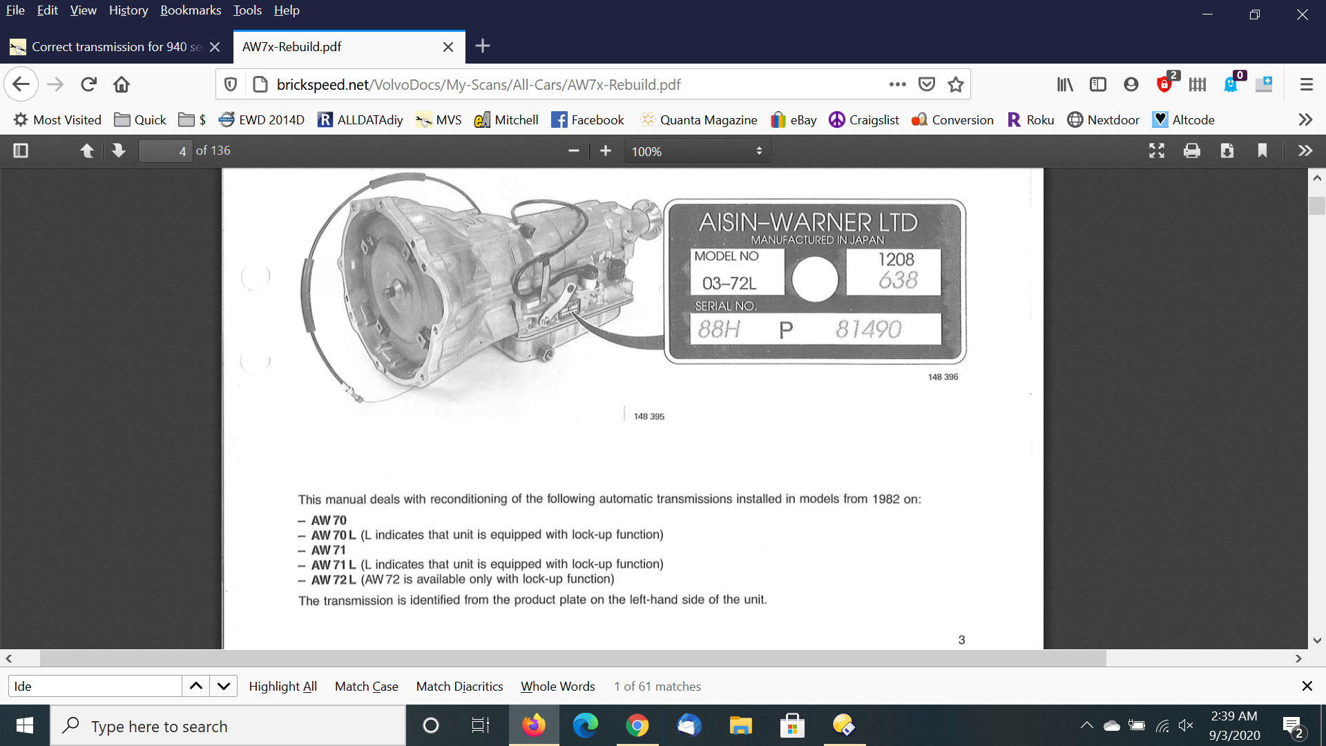

Post by RickHaleParker »
zimbodel wrote: 03 Sep 2020, 01:28 I went to look right now.
there is no plate just the numbers

Post by zimbodel »
Exactly at that position the plate is missing.... Darn !!!
