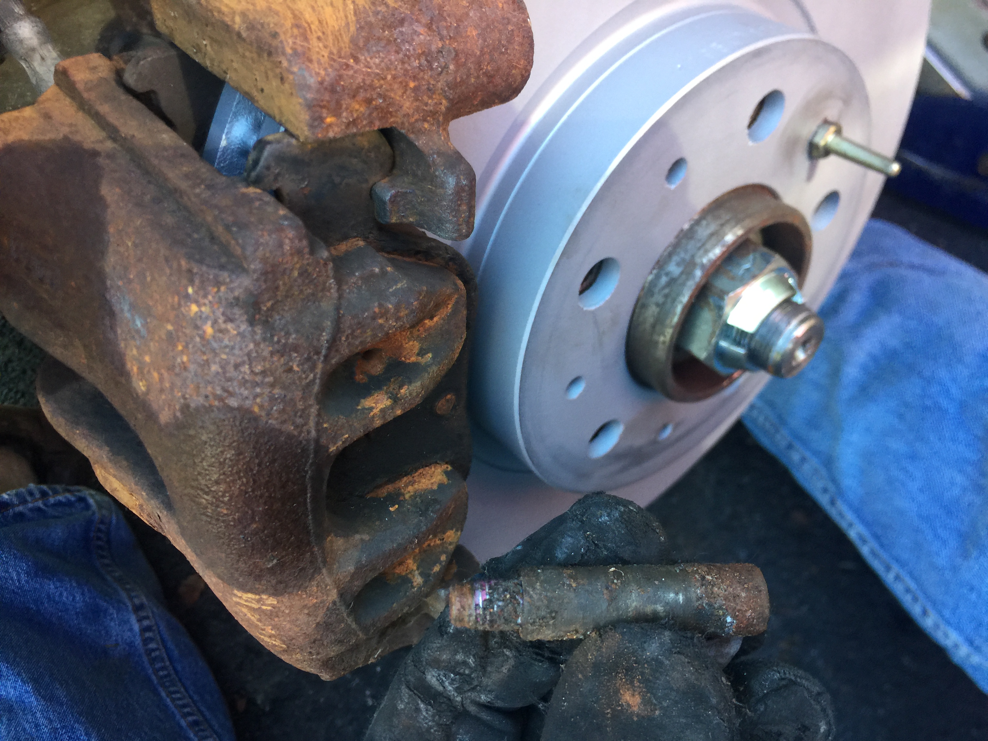

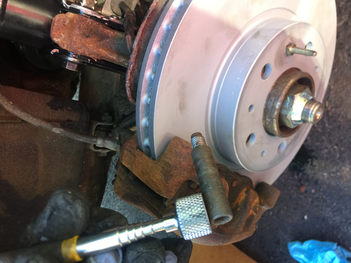

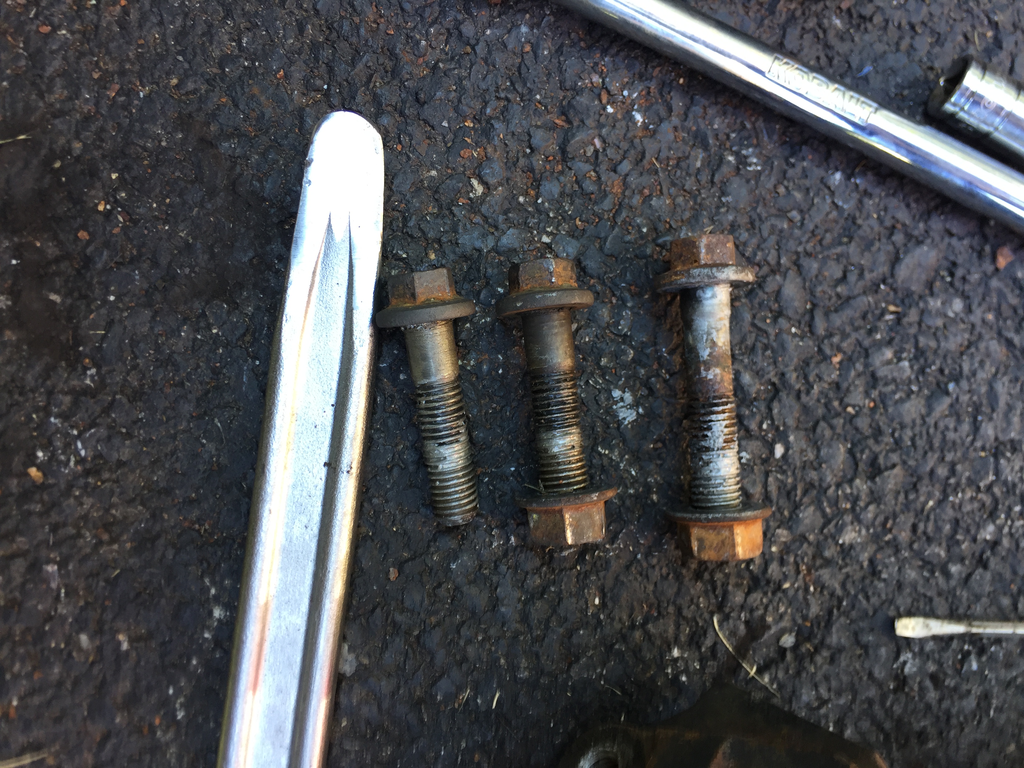

When you are doing struts and rotors and your caliper bracket bolts bottom out before the brackets are tight.....
It’s because you mixed up a strut bolt with a caliper bracket bolt
Crappy caliper slide pins too

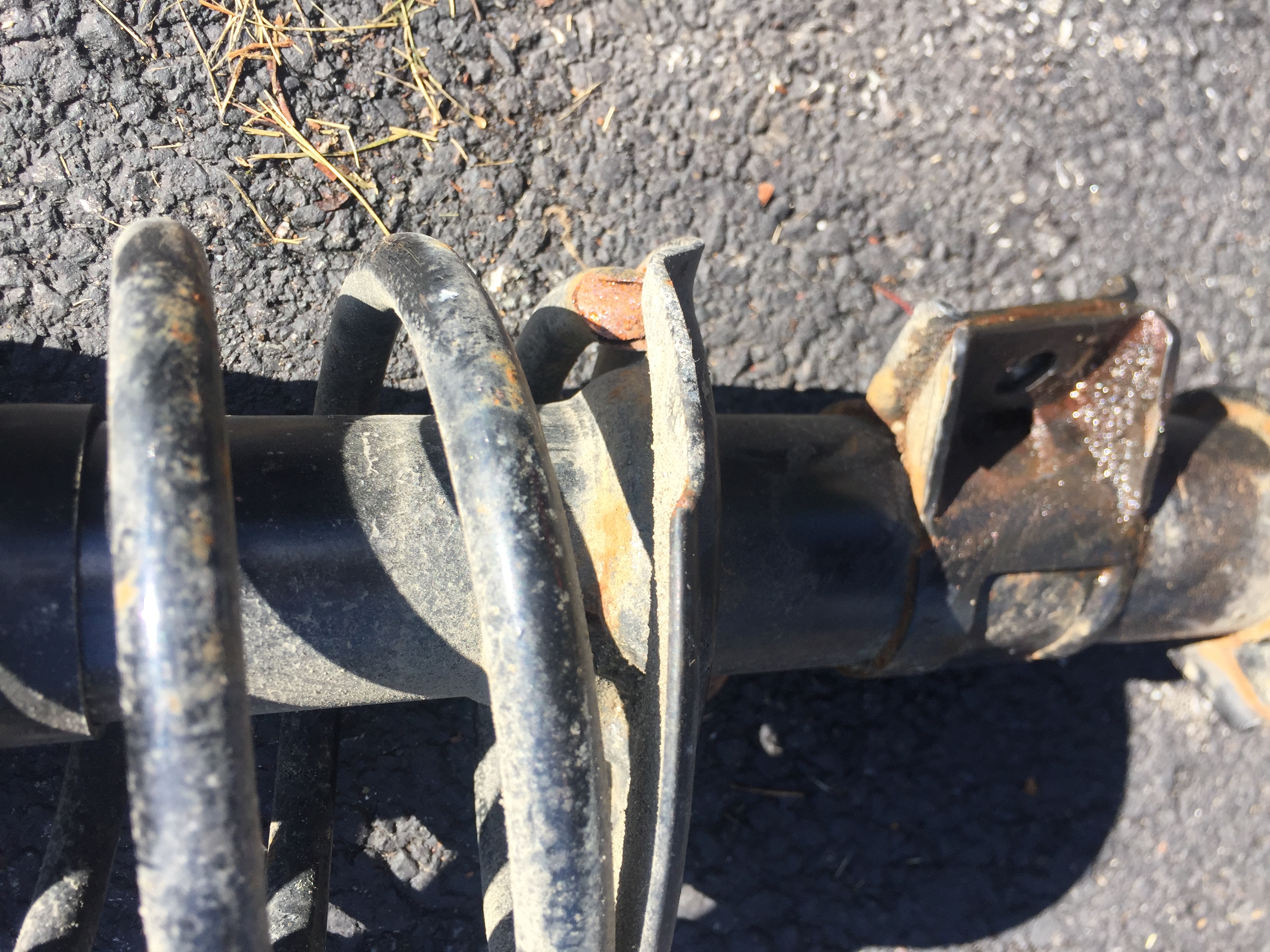

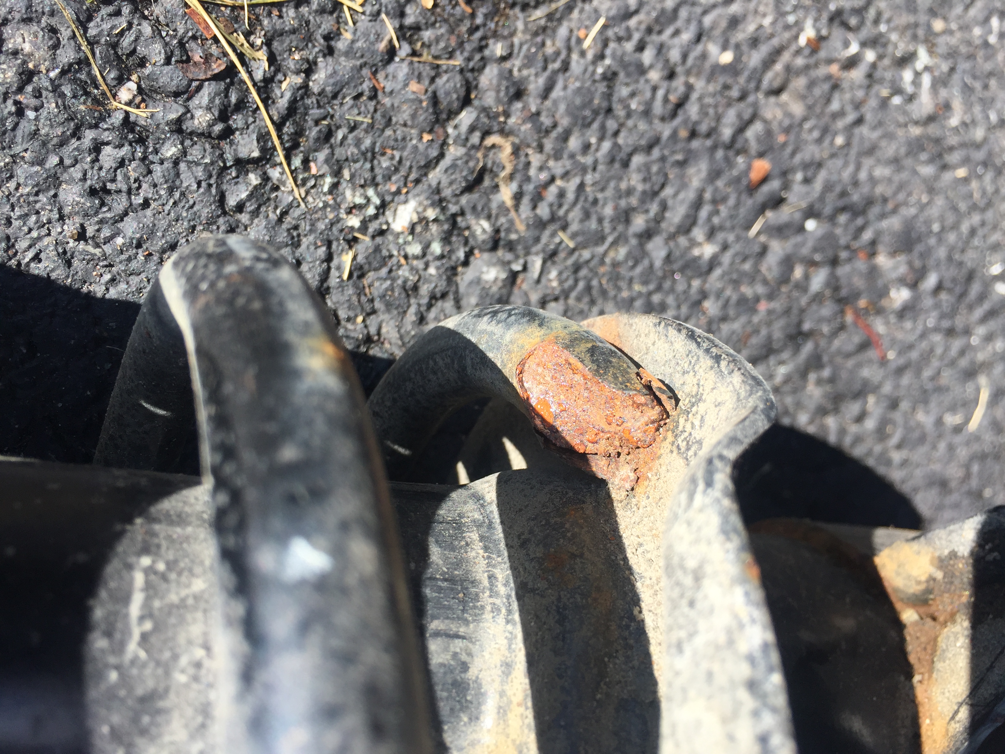

Second broken Sachs quick strut spring
