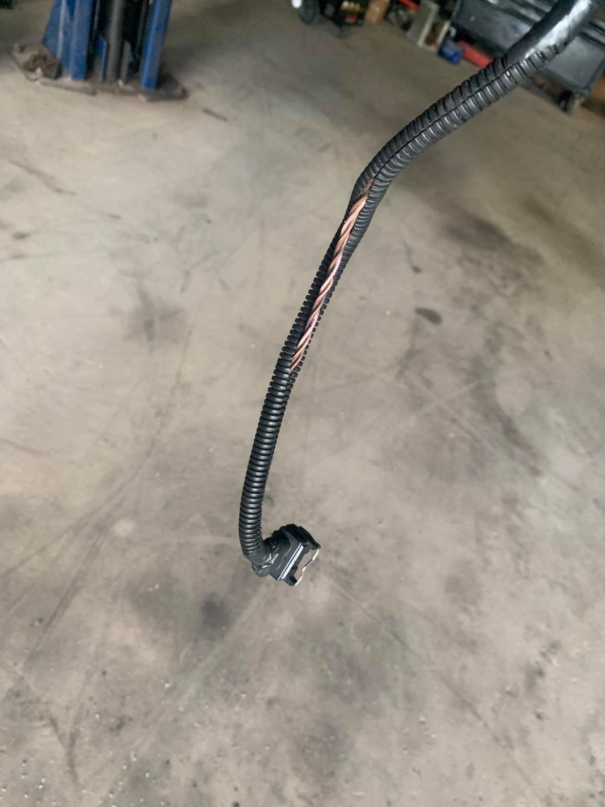

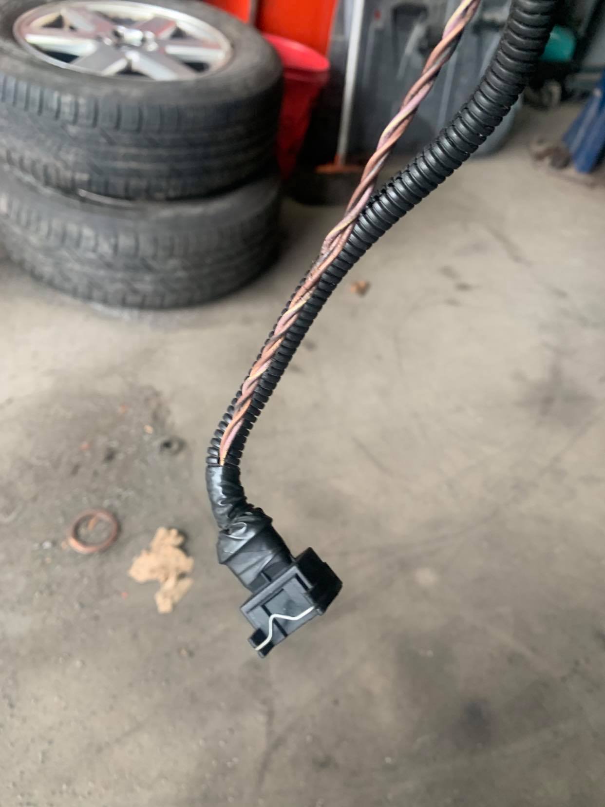

2005 XC90 2.5 So whats going on. original motor blew. installed new motor reused original wiring harness and ecu. got the car to crank no start. found car was not getting spark or fuel. determined most likely an immobilization issue scanned car verified that was the issue. testing procedure determined the CEM was OK and the issues was at the ecu. Ok i was thinking i for got a connector or a ground did not find and thing but on connector that i still can not located. so after a whole day of testing and probing i for got to disconnect the battery before removing ecu and i think the key might have been in the on position now the only power i am getting to car is from the dome lights and the power locks. no radio no gauges no power so now i have two issues PLZ HELP
