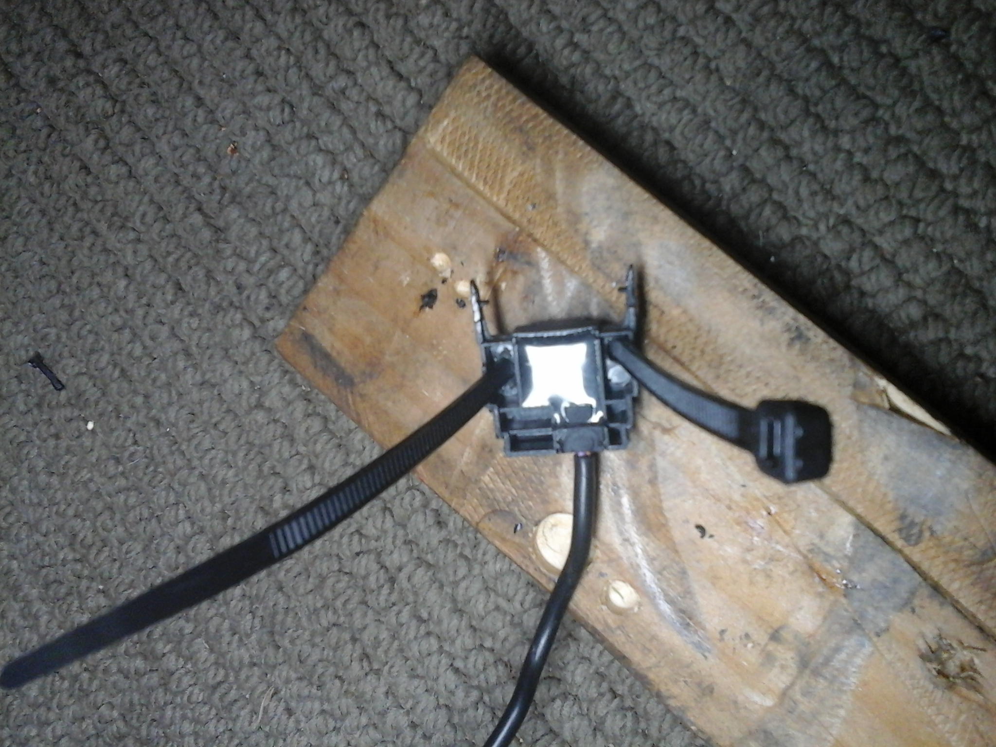

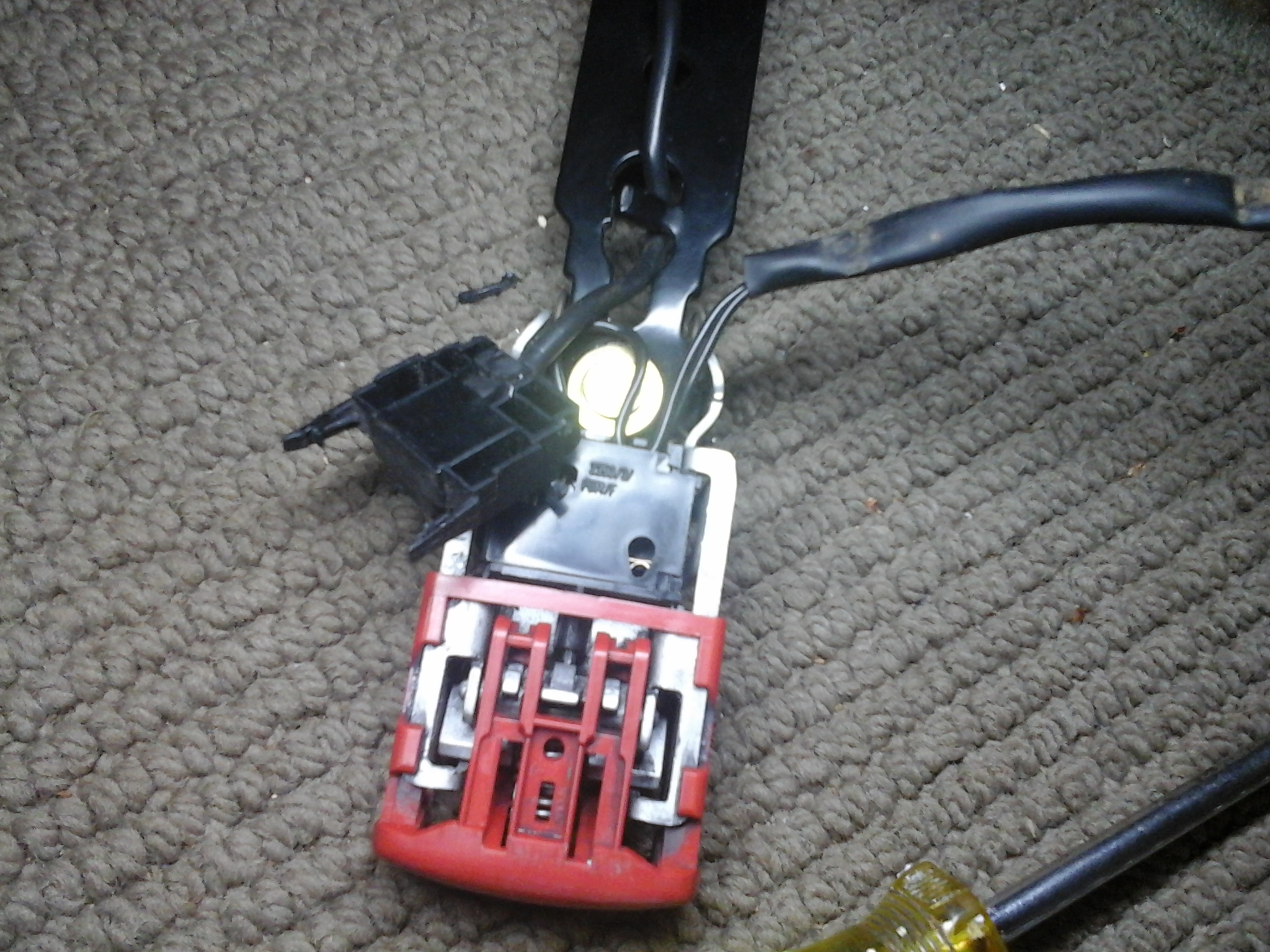

okay first step/hurdle is the seat belt catch. The P2 has some type of magnetic contactless sensor that i cannot use so i installed a p80 contact sensor.
Now the CEM throws an airbag code if i unplug the contactless sensor so ive plugged it back in. I read a discussion on another forum about the passenger airbag is deactivated if the passenger seatbelt isnt latched?...i find this hard to believe that would mean if they are not wearing a seatbelt the airbag wont deploy?..but to be on the safe side ive zip tied the contactless sensor to bar under the seat.
https://www.quora.com/Does-an-airbag-ne ... -activated

the contactless sensor needs to be away from metal to simulate a latched belt.
