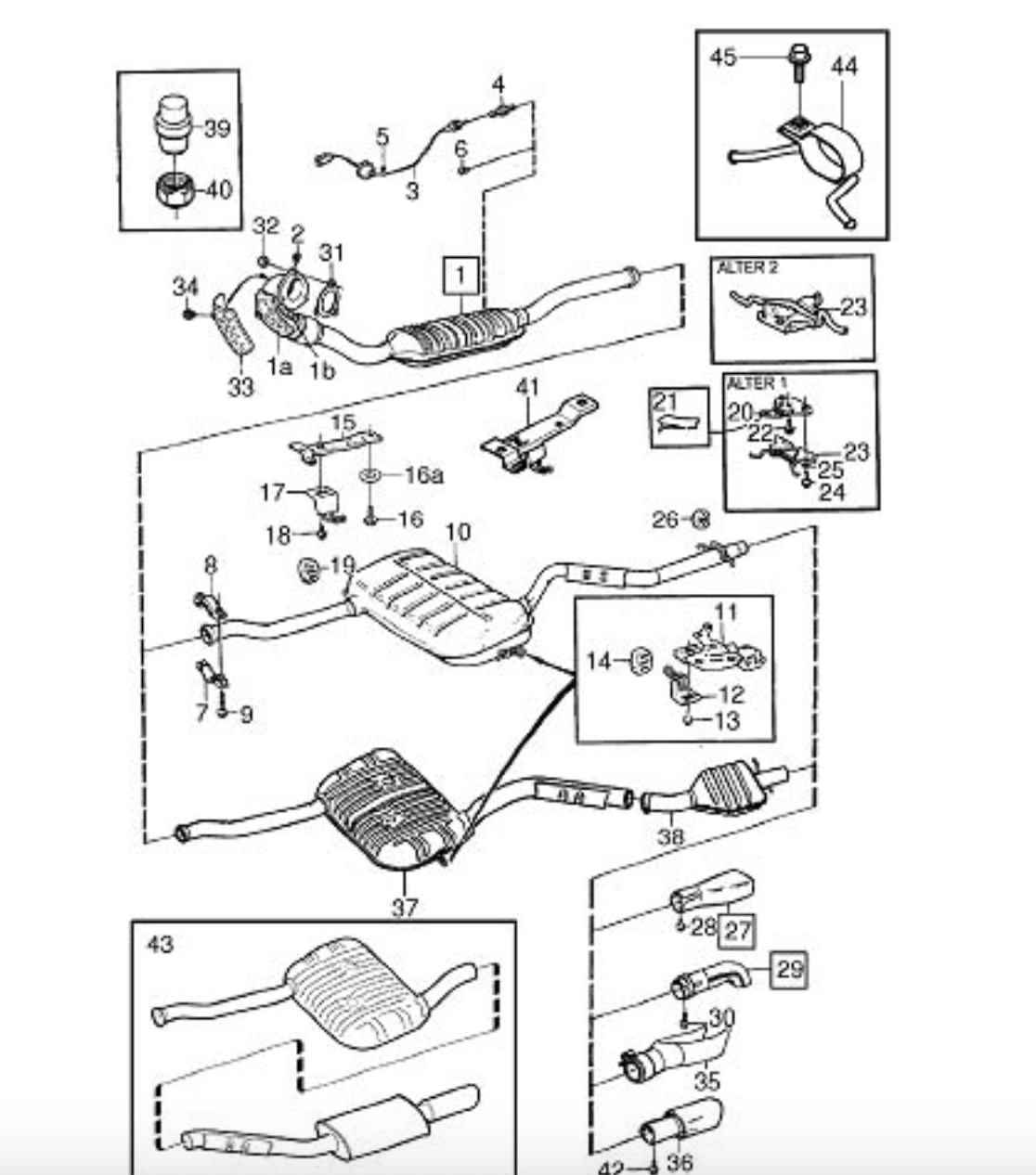

Having a hard time figuring out what I need (trying fcp and europarts). There really isn't a photo of the assembly -- they have some rubber parts but no metal? I just need to buy all that's needed for my guy to repair. It's the last hanger at the rear of the car -- just using steel wire right now. big THANKS.

Get your part numbers from here..
https://www.volvopartswebstore.com/show ... evel=24647
then start shopping!!
- Posts: 15486
- Has thanked: 2199 times
If the rear hanger broke off (common issue), then you need parts 44 and 45 in drawing above. Be warned. I had a 2000 V70 base and the replacement hanger was too big a diameter for the pipe. I had to make up a collar to pack out the gap. I don't know if it was an aftermarket muffler on the car or an OE.
