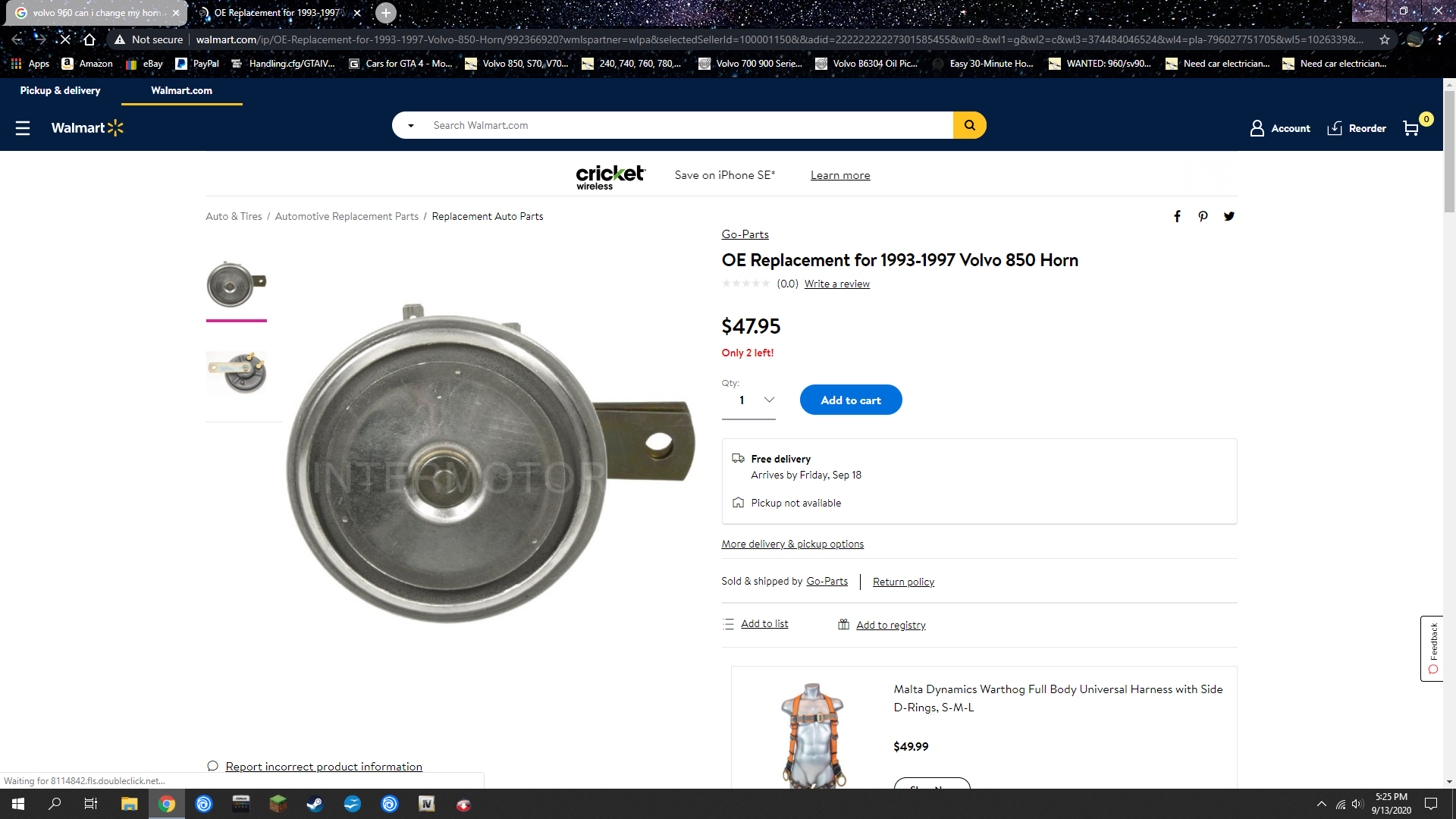

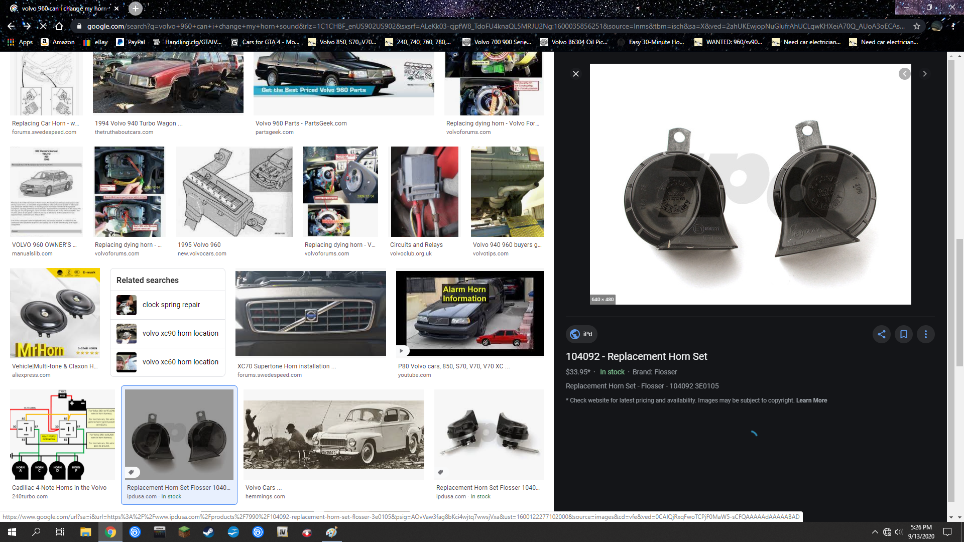

My 98 XC has a normal, mid sound horn. My 96 960 has that girly VW Bug/Honda Civic high pitch horn. How do I change the one on 960? Is the sound issued from a sound board or built into either of the horns that come on most Volvos? Refer to the two horn pics below.

does that mean i only need to swap the cylinder object in the walmart picture? My 960 has 3 for the horn and 1 for alarm. 98 xc has 1 for alarm and 2 of the spiral objects in picture #1 for the horn.RickHaleParker wrote: 15 Sep 2020, 01:47OEM Horns are all Electrical/Mechanical devices. A electromagnet vibrating a spring loaded flat circular steel diaphragm. None are Electronics devices.CIK7 wrote: 13 Sep 2020, 16:34 Is the sound issued from a sound board or built into either of the horns that come on most Volvos?
