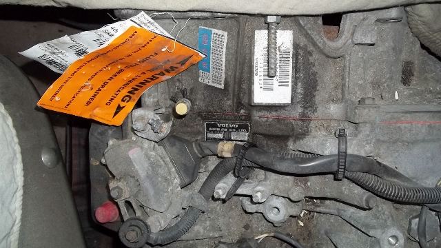

The transmission model tag is located near the PNP plug on my AW-55.
I'd imagine it's near the same location on an AW-50.
See below.
