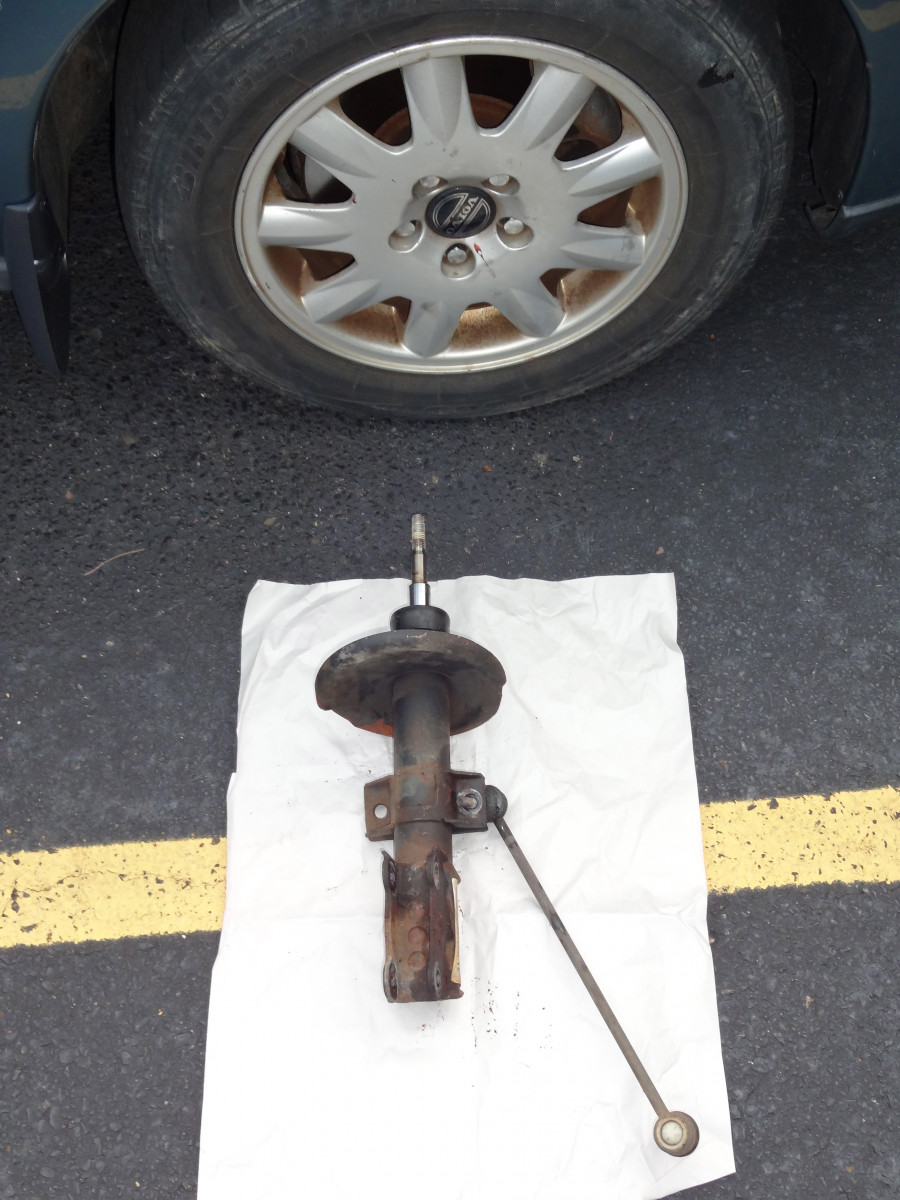

Test each drop link by exposing them by turning the steering wheel fully in one direction and grab it. If you get any movement, replace 'em. 160K is well beyond their service life.
You can see a dead strut (won't extend one bit) and a worn sway bar link aka drop link.

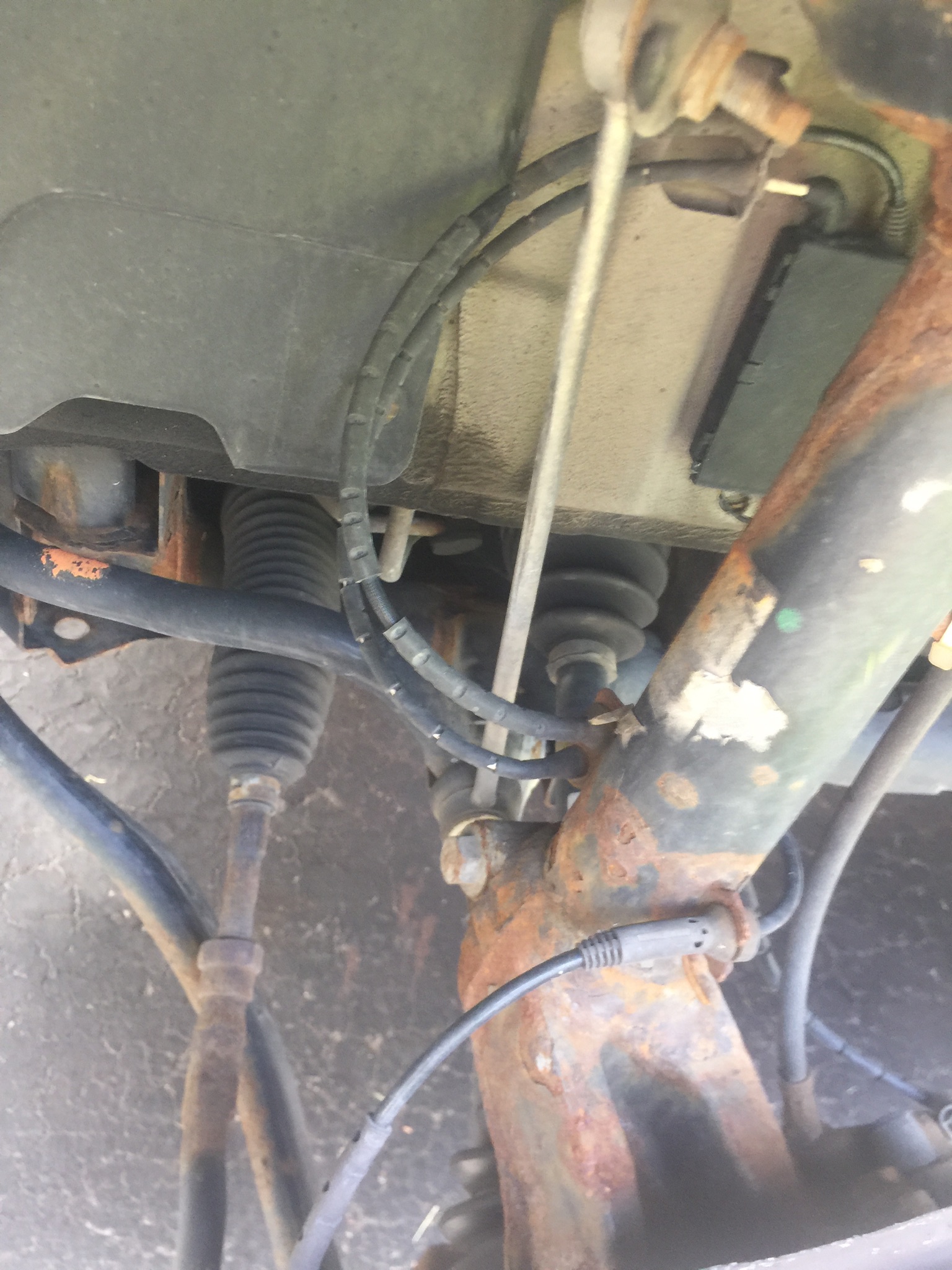

Worn sway bar links can be diagnosed
by disconnecting the lower end and wiring the link back out of harms way. Then drive the car and see if it still clunks. It it does still clunk then You may have a worn out spring seat.

You can USUALLY tell the sway bar links by grabbing them and yank/push/pull on it like a madman (grab it, then shake it like you're throttling your best friend after you found out he slept with your girlfriend).
If it rattles/clunks, it needs replacement. If it's solid, it's LIKELY not it.
It can be the top spring seat. The little bushing in it separates from the rubber and allows too much movement.

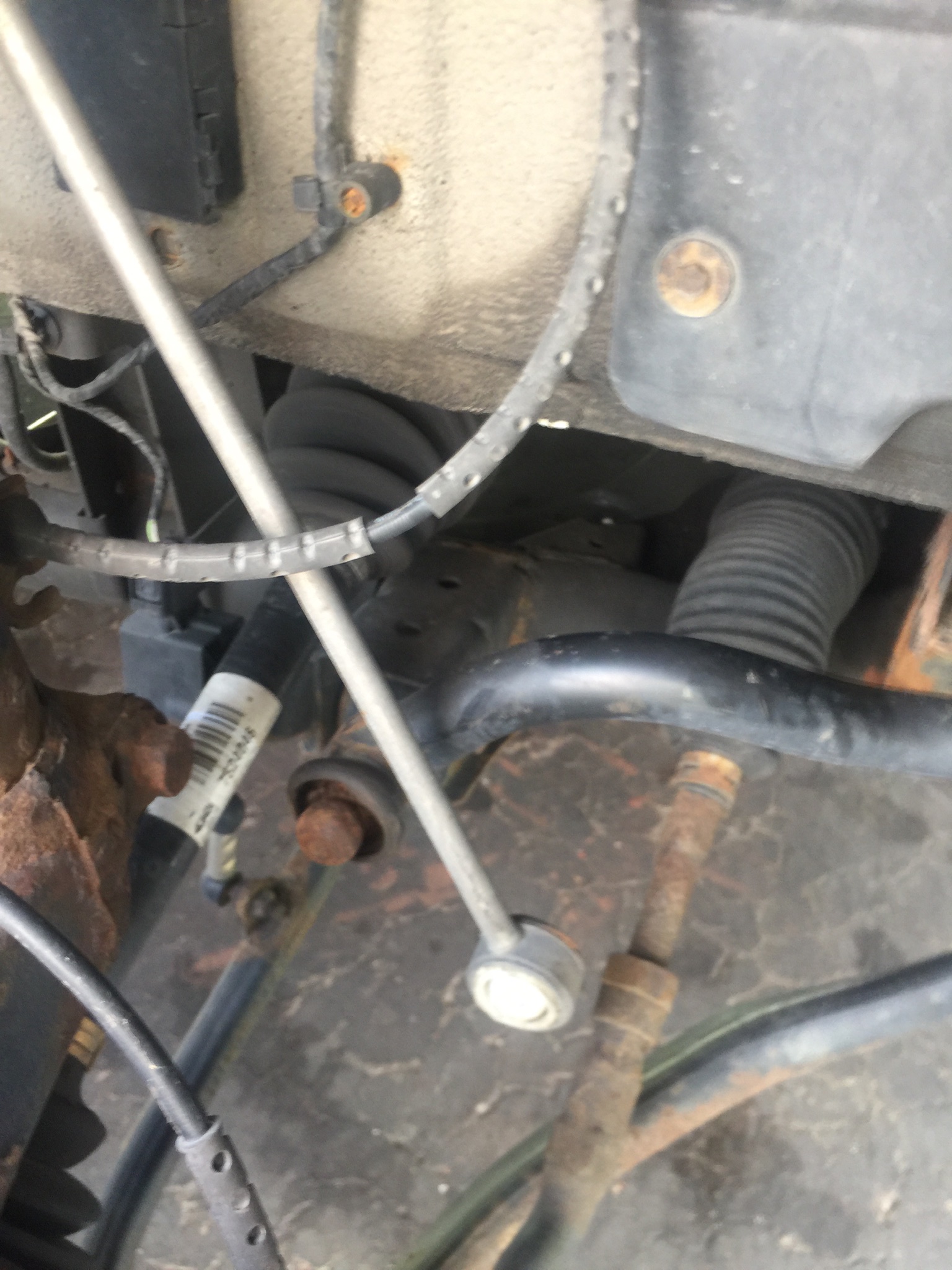

Speaking of these end links.. I think it's a little trickier to test them. I tested mines, pulled with force - no play. Removed the nut, turned the small bj by hand, no play. Put back, tightened down with force, still noisy. I'm getting the feeling these will knock if the small bj is no longer super tight to rotate - when the end link is new, the bj is very stiff to move by hand, as they get old, it becomes easier to move even if it has no play. Just a theory. Also, I have the feeling the anti roll bar may move sideways and may also kick on the control arm on cars with over 150k miles
