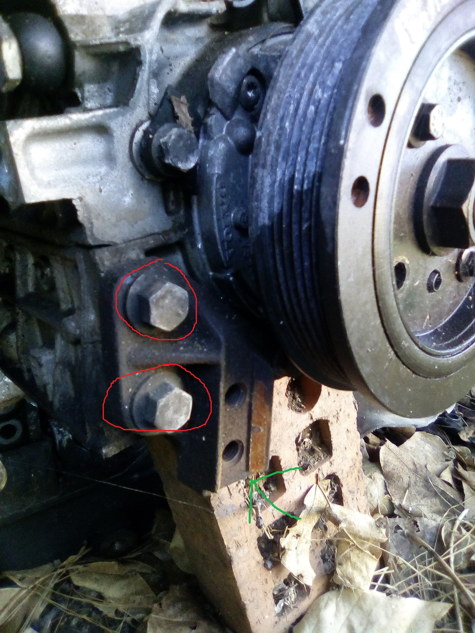

thats the front of the engine. its bolted onto a bracket to the block. i was thinking you meant the round mounds on the sides of the engine they also both use brackets.

Interesting,
Thanks @darrylrobert for the photo.
I assume it is safe to use propane torch here, just keep the flame away from the Timing Belt (or place a heat shield).
Heat it really hot, then use reverse drill.
Or remove the bracket from the car and play with it.

umm..yea its holding weight...The engine weight...did you jack the engine to lift the weight before taking the front mount off?
remove the whole bracket and then use heat or replace bracket.

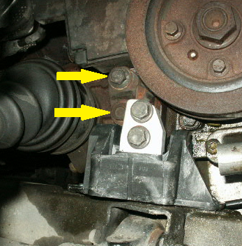

Thanks for reminding me that it's attached to a bracket. Only replaced two and that was 8 years ago and I no longer own the 98 S70 T5. I don't think he was referring to those bolts regardless as no one ever touches those while removing a mount. Some newer members to the forum won't reference that mount as the front engine mount. Most people will reference engine compartment to location of mount so the front and rear are really the round side ones in reference to the engine.darrylrobert wrote: 20 Sep 2020, 20:41
Since he is referring to two bolts and the broken one holding weight, he is just concerned what would happened if the second bolt broke and what would happen to the car. It maybe safe to assume this also as he referenced front right as in engine compartment position and that mount has two bolts working in conjunction to holding up weight. With the round side mounts weight would not be a concern.

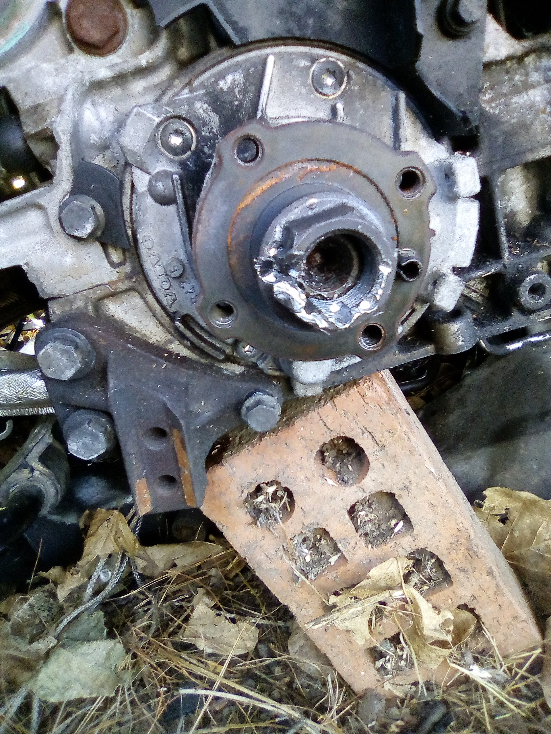

here is a better pic of the bracket, ive been trying to remove the harmonic balancer for some time..finally i was able to drill it free.
you can see two 14mm bolts and a 12mm bolt that may prove difficult (depends on bolt length) with the pulley in place
