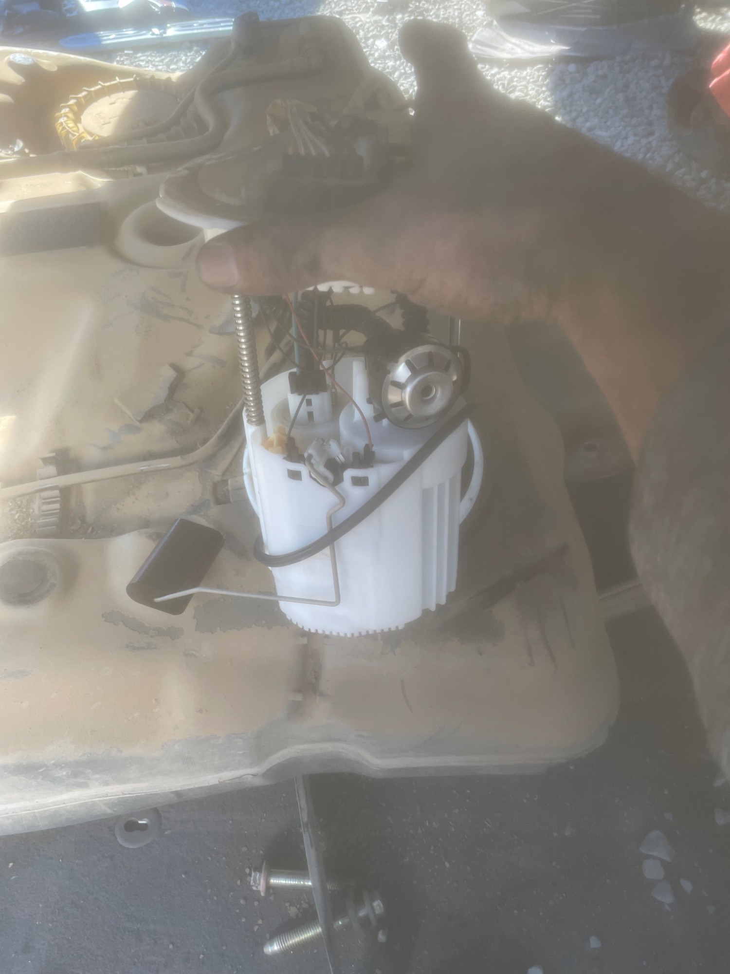

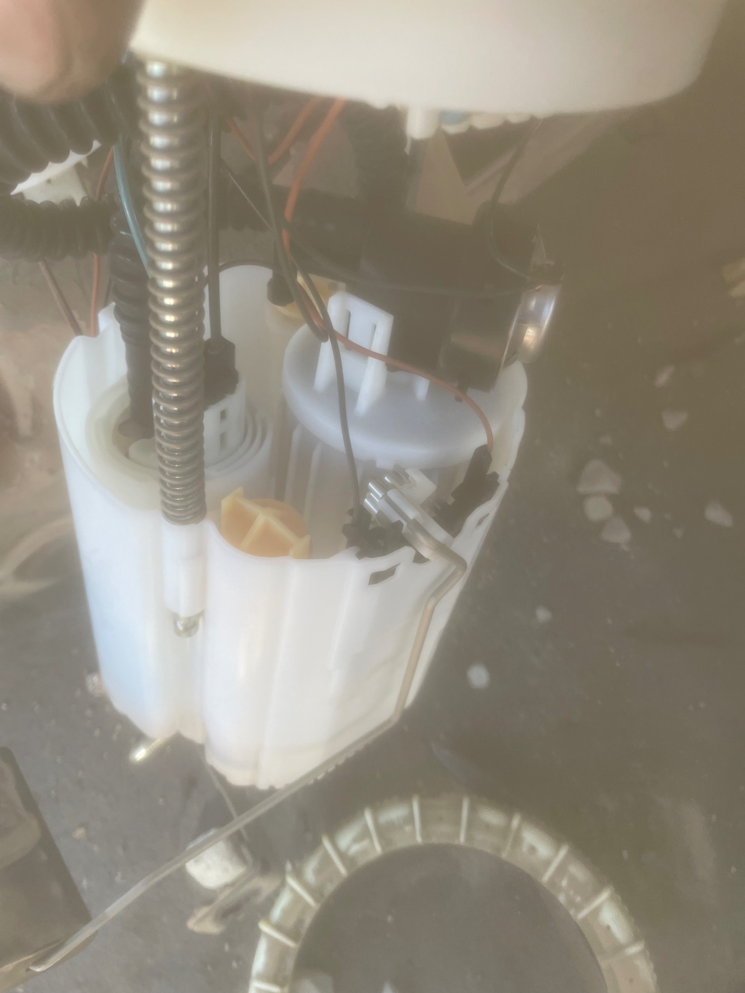

Correct. This has been asked before. The fuel filter is part of the fuel filter assembly. There is no external unit on P1 cars. See pics.jimmy57 wrote: ↑22 Oct 2020, 09:15 The fuel filter is part of the fuel pump module in tank. The primary fuel filtration is the mesh on bottom of the vessel the pumps sits in. The fuel filter after the pump catches finer particle size and will stop brush and commutator bits from the fuel pump electric motor. I have not seen a stopped up fuel filter on these or other brand using non-serviceable filters even on cars and trucks with 200+ K miles. The bulk of gasoline fueled vehicles built from mid 2000s are like this. Honda dropped servceable filters beginning in 1996 as I recall. If you get 3 gallons of water then the filter gets full of water but in that case you need to remove and clean tank and the pump will need and should be changed. That mesh primary filter will reject water unless the whole surface area is covered and then the suction will get high enough to pull water through.
