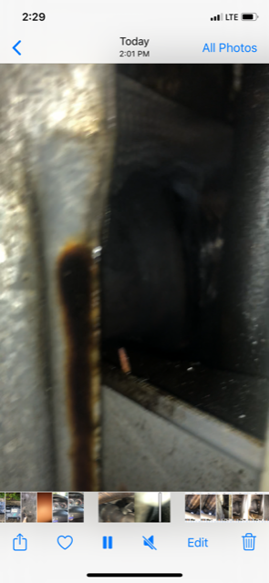

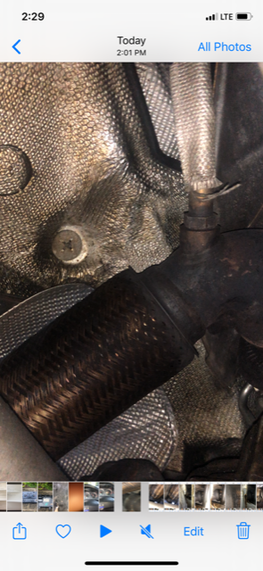

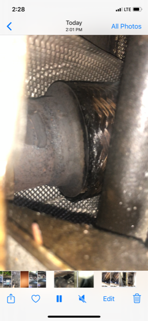

Current symptoms - car emits smoke from front underside after driving for 10 mins - it can sit and idle for 30 mins. and no smoke - only after driving for a bit.
Drove it for 10 mins today - started smoking, put it on ramps to see where smoke is originating.

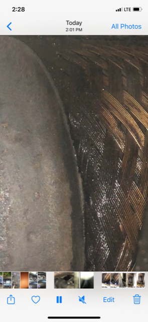

Looks like rear most portion of “braided pipe” is somehow burning off some oil?? I mean that is definitely where the smoke is coming from, no question about it, when I crawled underneath to look. I did not see anything dripping, BUT, “braided pipe” looks saturated to me and oil appears in that same spot (frame underneath rear most portion of “braided pipe” - 2nd pic) after being wiped clean after every time I drive it.
Again, "left over" oil being burned from when I drove it around with blown engine? Or something worse...head gasket, etc?
Coolant and oil level steady. Compression test 155, 150, 135, 155, 155 on cylinders 1-5 respectively.

Was left over from previous blown engine - eventually burned off...
