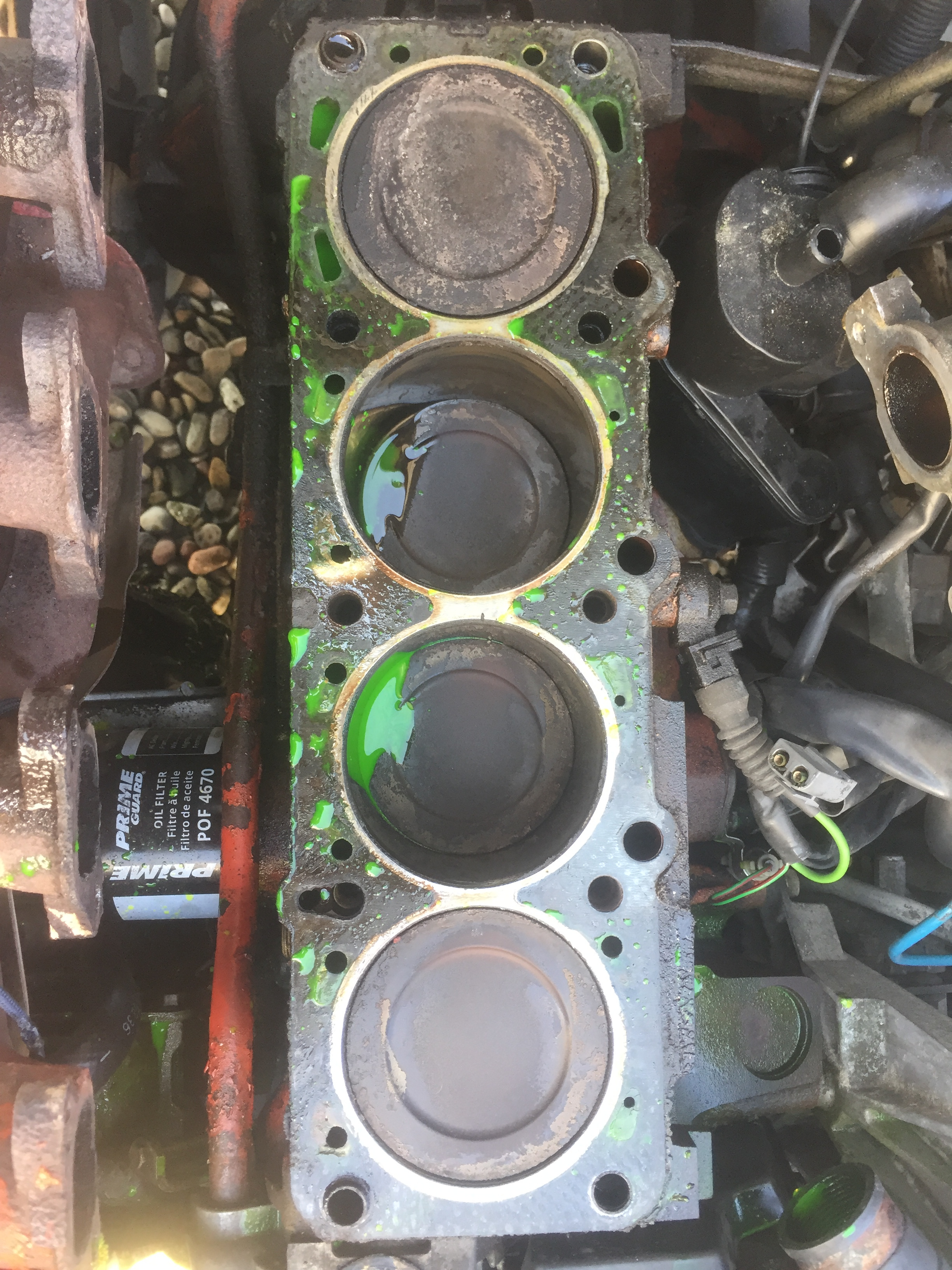

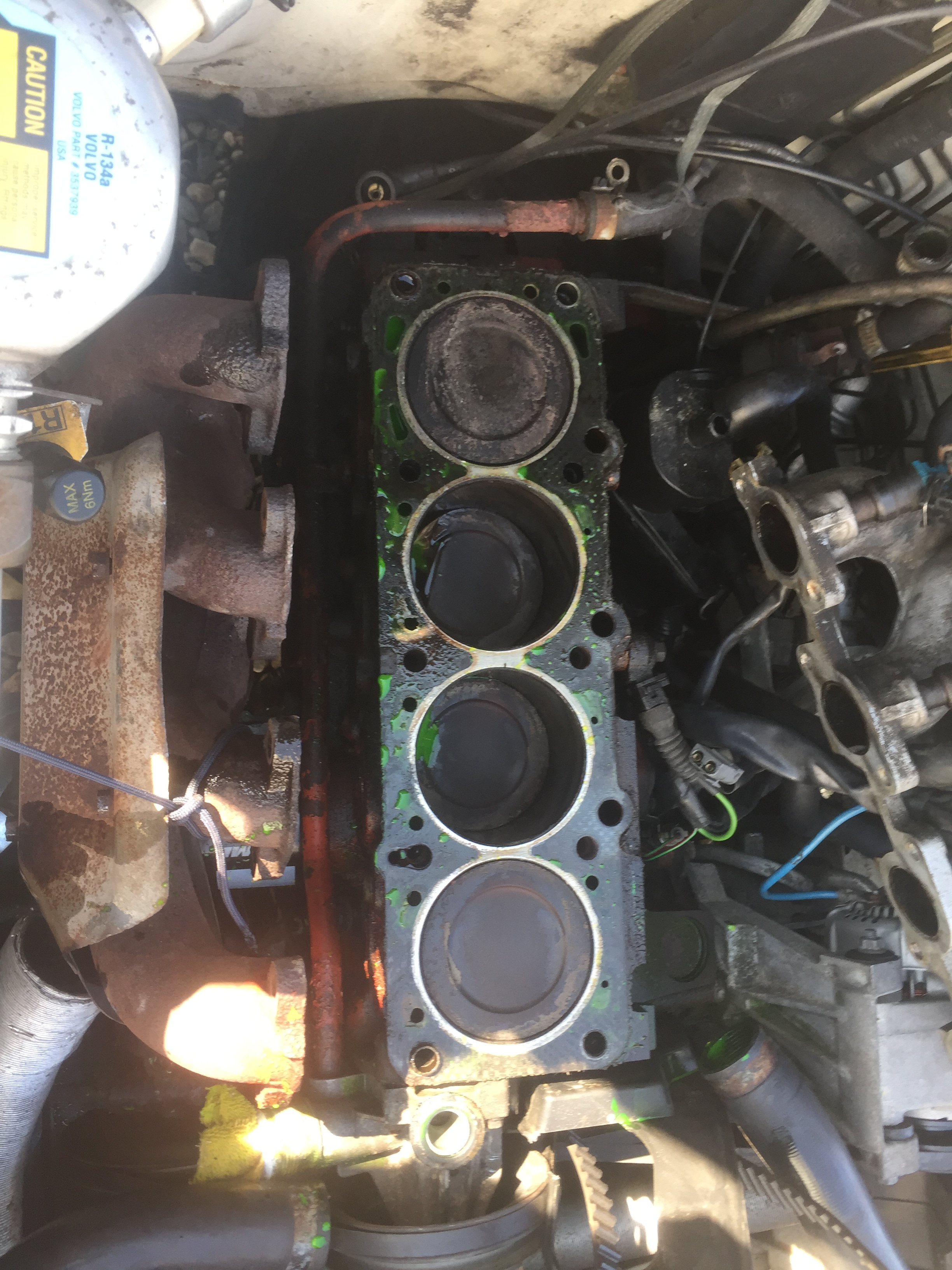

So i was able to remove the head, without removing any belts. I did loosen the water pump pulley and slide it out a little. to remove timing belt cover.
I only removed the timing belt from the cam shaft gear. all other belts stayed on (alternator accessory and water pump). did not have to remove the harmonic balancer or timing belt completely. just slid back on to camshaft.
I was able to get rid of the leak. I did not machine the head.

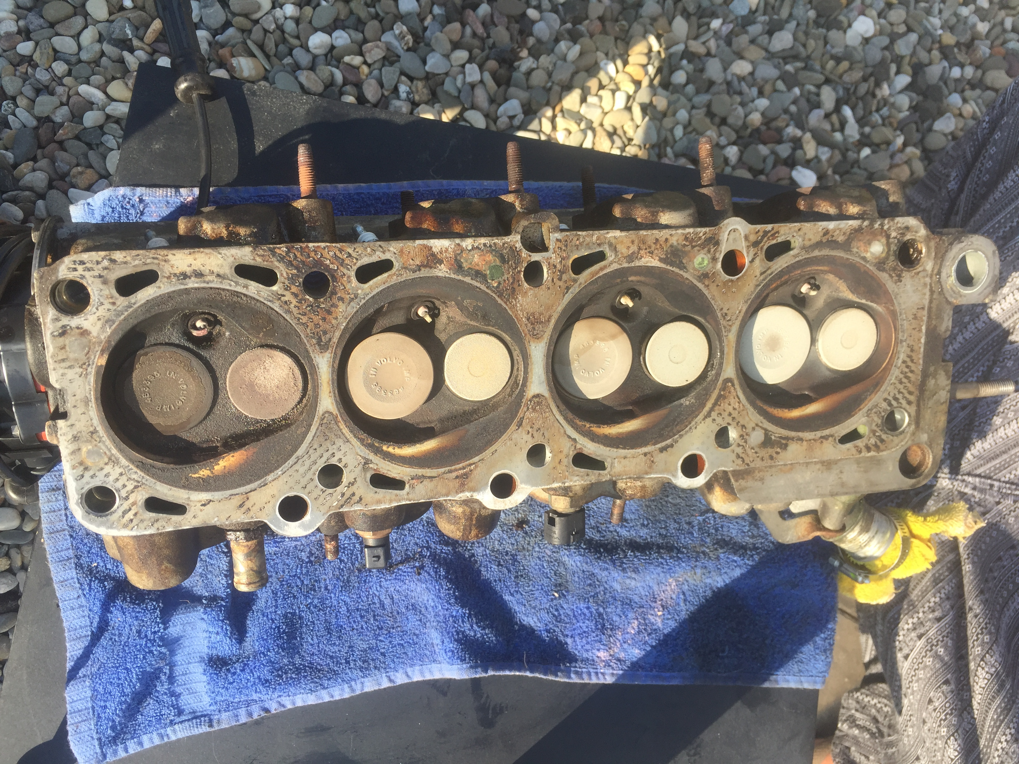

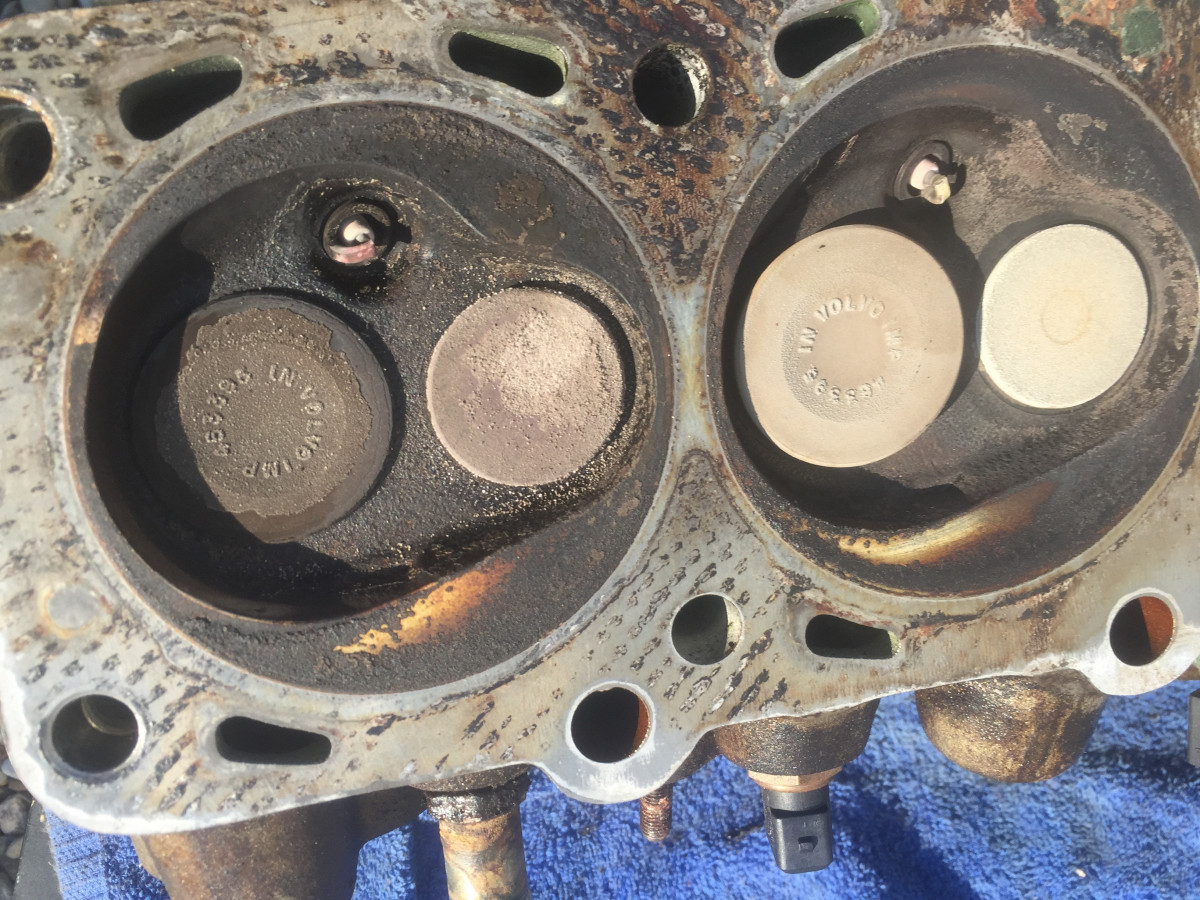

I did not rid myself of the engine shaking. unfortunately. via a vacuum intake reading while car is at idle. internet says i have a loose valve guide. cylinder 4 (closest to windshield) was darker, had some carbon fouling on the plug. and the exhaust port had more carbon than the other ports. I was way in over my head already and needed my memory to get the car back together, so i just cleaned gently what i could.
motor mounts and transmission mount have been replaced. a month ago. shaking is at idle in gear and in neutral. shaking is also at 2200 to 3000 rpms. It is possible i have a clogged CAT but i guess the vacuum reading could not be wrong, "pointing" to the valve guide. 21 to 18 fast fluctuation at idle.
If i pull the head again, any idea of costs for parts and machine shop labor to get the number 4 valve"s" back and working again ?
I have no smoke on start up, all i have is significant engine vibration. shakes the back windows. driver side window. and whole car. loud enough to over power the very nice factory installed stereo.

- Posts: 36137
- Been thanked: 4064 times
Shop charge estimate for valves and guides probably $250-300 plus parts
Do all four of course. Cleaning that block will be some time , get started now while the head in under work!
