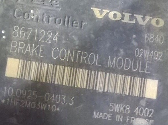

In this case will be cool if you show me couple screenshots:
Vin, detailed info about car and tab Network, click on BCM on the image and show me SW numbers also.

I took a picture of the sticker
VIN YV1RS61TX32272264

I don't have Vida. I use a regular scanner
