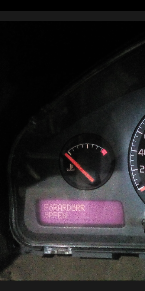

I finally got around to fitting my cheap DIM i purchased on ebay from Lithuania (same code numbers). Everything seems to work plug and play exept its in Swedish, a minor detail i forgot and a google search says unlike other cars i have driven its not changed via a onboard menu?..cant even change with VIDA with a software download..
dim language change
dim language change
dim in svenska.png (439.04 KiB) Viewed 677 times

Can't do it from onboard menu. Try finding a garage that has a more expensive code reader. I think to remember there was a language change option for the DIM - but I might be wrong. Maybe Vida could do it ? I think it's rather important because something tells me you won't be able to recognize a "Low coolant level, stop safely" message on the spot. Perhaps may want to make a list with common warning messages and translate them in advance ?

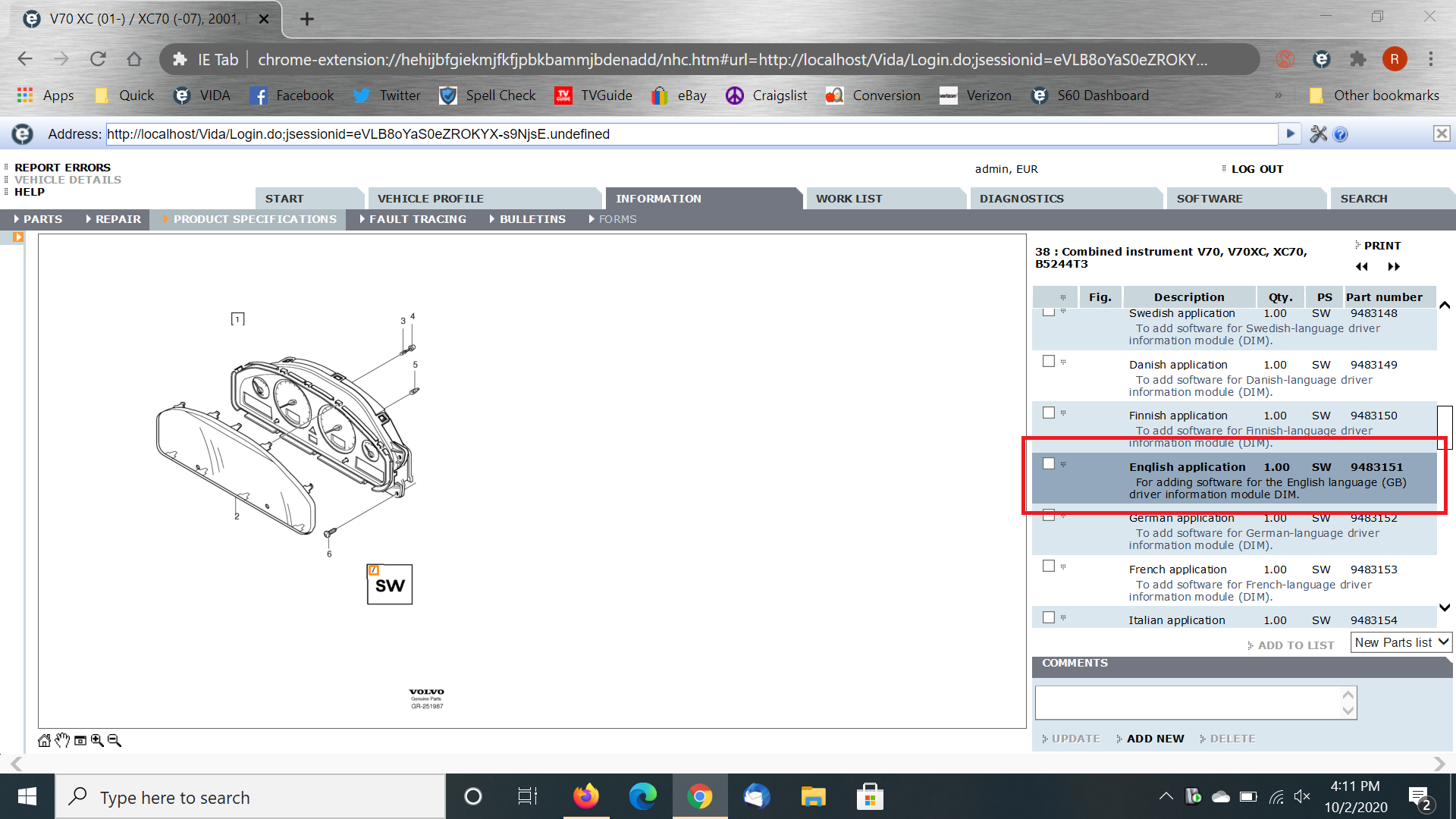

I have not needed to do this nor have I looked in a long time But there were several languages listed in VIDA software list for P2 clusters. Quebec dealers often changed the DIM to French.

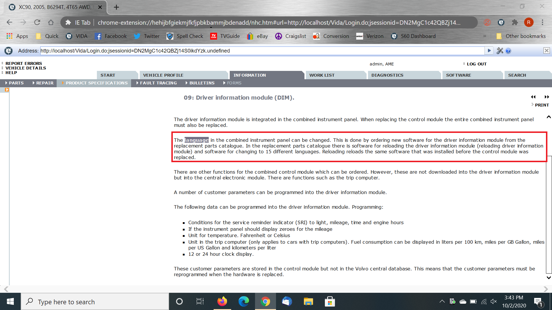

RickHaleParker
Posts: 7129
Joined: 25 May 2015
Location: Kansas
Has thanked: 8 times
Been thanked: 958 times
Post by RickHaleParker »
RickHaleParker
Posts: 7129
Joined: 25 May 2015
Location: Kansas
There is a company in Rainham, Essex that does DIM repairs. Perhaps they can do a software transfer or trade you for one in English.
