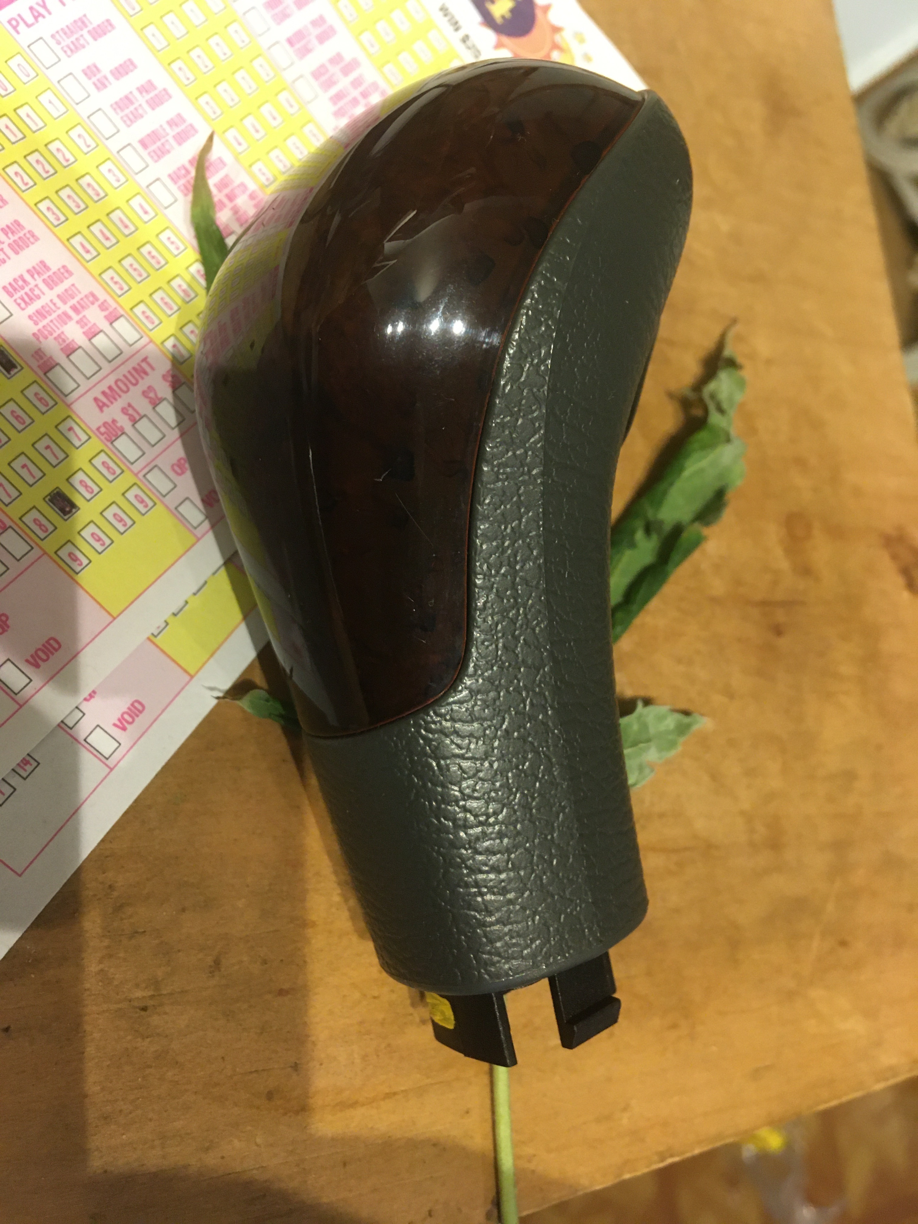

Pardon me if this overlaps my other shifter stuck post but I really need to get this car out of here either sold or given away to a junkyard or otherwise anyone for that matter.
I go this as good as new looking extra nice veneer glossy shift.
I am starting to search for other posts. The boot is in really good shape and following someones instructions I managed to easily rotate the top of the boot and get it to slide down. Pulling as hard as I can on the shifter it does not budge! The other thing is it is stuck in park and I do not know what else to do at the moment.
I really hope putting it into another gear is not part of the removal installation process.
Thanks for your help.
I saw a reference to the Haynes Manual so maybe I should look. It is way funner to come here and beg for help.
Got this lovely shifter, but how to I get the old one off?
