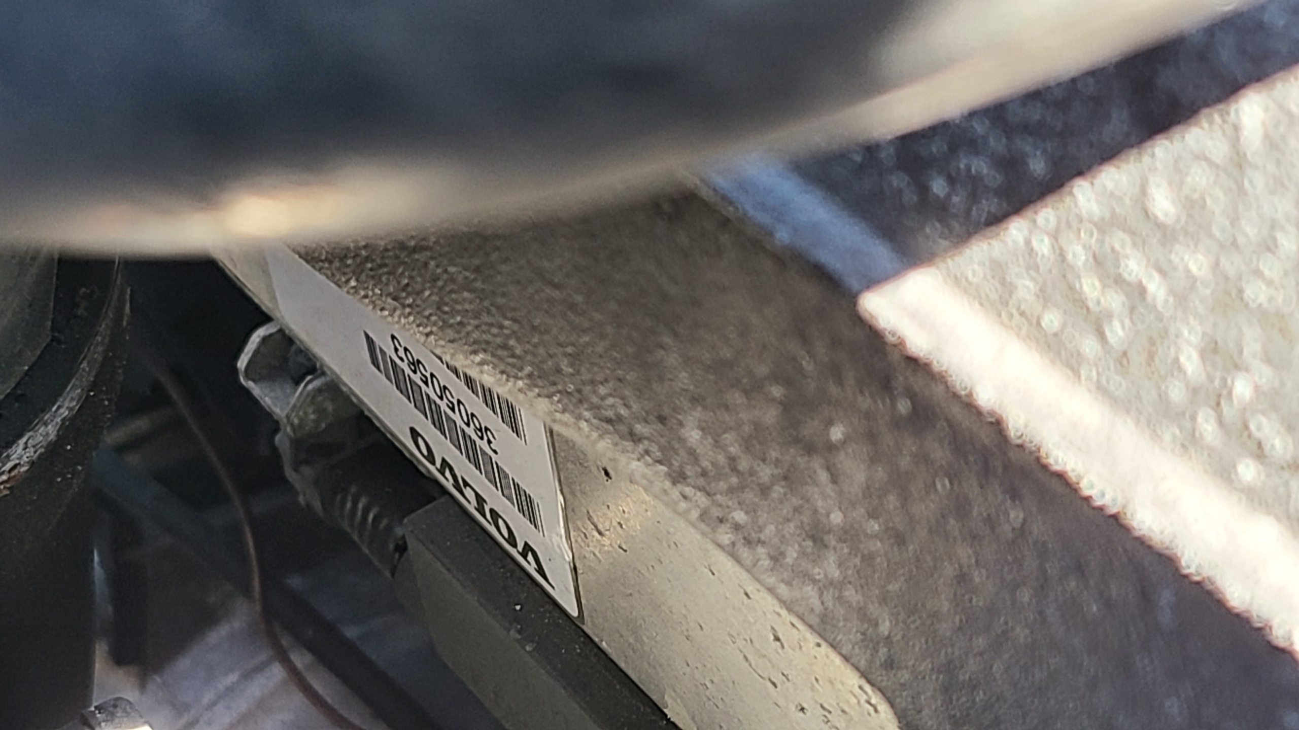

I'm also looking into a junkyard replacement. A place 90 miles away has a used ETM from a 2001 S60 T5. They want $75 for it. Car has over 200k miles, but the ETM is PN 36050563...an ETM build later than original 2001 production. It's most likely a replacement ETM. This S60 T5 was built in the same Swedish factory as my V70 T5, but 1 month later. I believe both cars should have ETM 8644346. Both are engine model B5234T3. Open question: When they flash the ETM, are there any differences in the programming between an automatic transmission vs a manual? I'm thinking not.
I'm leaning towards just swapping the ETM out with the used S60 T5 ETM. The pic of it seems real clean (ie. possibly not on the car long). I have the programming concern and hope to get a response concerning auto vs manual. I know swaps are hit and miss, but I've read some negatives about the rebuild kits and calibrating the magnet and would appreciate input from those with experience.

Have them send you a picture of the label so you can see the build date. If you look in the ETM forum down below, you will find the date where Volvo starting shipping replacements from Sweden with a universal software that should work.

I believe I wasn't clear about buying the used ETM, I would only go that route knowing I do not need reprogramming. I realize having the correct software is critical. My question was geared at the software being correct between the 2001 S60 T5 "newer" ETM, and my 2001 V70 T5 original ETM.
Pic attached, no dates but the PN clearly is the Volvo "replacement" PN for the 8644346 (original from my T5).
From your link, its a white label 36050563 and should have been shipped after 2015.
