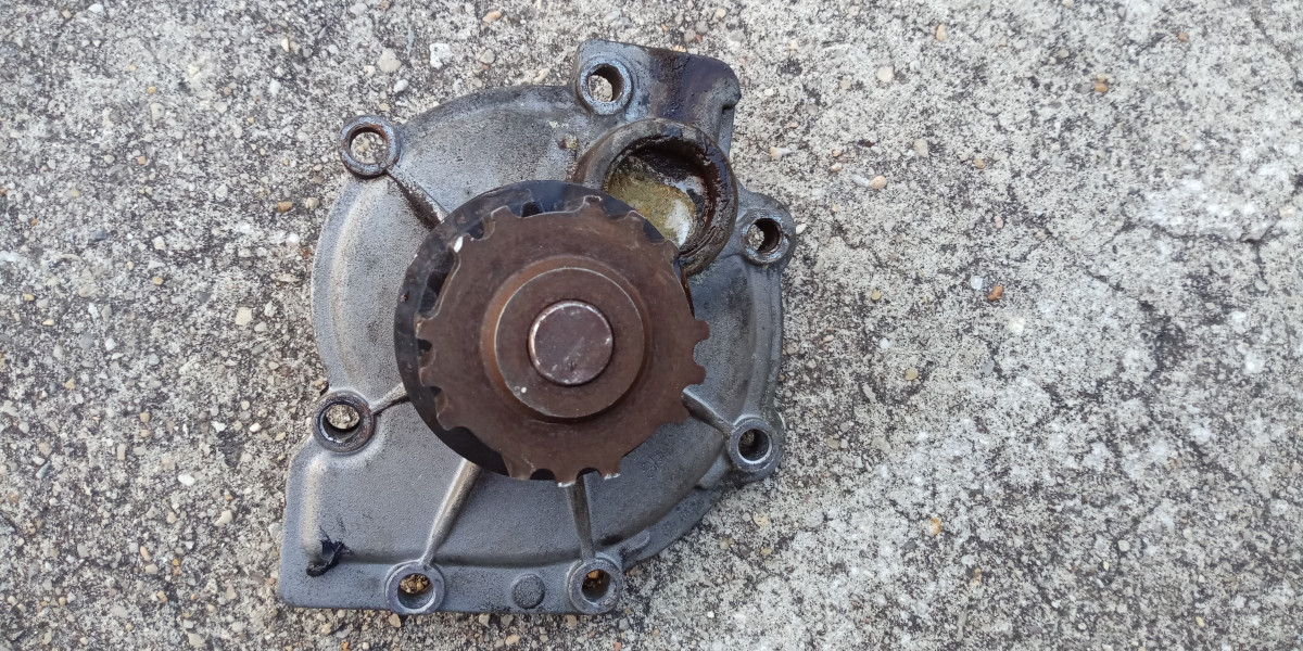

Did the timing belt, water pump, et cetera job this week. Here's what happens when the star bolt in the tensioner pulley (stupid engineering decision which could have been a sturdy hex bolt) is either poorly made or messed up by the previous owner. There was NO WAY I could get enough torque on this sucker to remove it. After trying and trying and modifying tools, I finally resorted to grinding/cutting it off with the Dremel too with a cutoff blade. Believe me that takes a while. When you're done, it looks like this:
All of the components after maybe 60k miles seemed OK except for the hydraulic tensioner and the water pump. The water pump was leaking badly, and that's why I did this job. The hydraulic tensioner may be good, but I cannot depress the pin AT ALL on this thing. seized, or is it really that stiff?
Here is the crap water pump that I removed. There are no manufacturer markings on it. Anyone recognize this brand?
I'm thinking this is an off brand of some sort or wasn't replaced last time the belt was done. I used all top quality parts this time around.

Funny you should post this up
I'm doing GrunHilde water
Pump , green 1998, and it is the first time I've seen the water pump pulley with the notches " missing"
My 1998 AISIN VOLVO one has the same look.

It was the seal on the shaft, as far as I could see. Couldn't feel any wobble in the shaft bearing, but the fluid was coming from the shaft and had left stains. I assume that's a freeze plug there. It looks like hell but was simply being dripped on.amblerman wrote: 08 Oct 2020, 11:42 Was the pump leaking from the gasket failing or the pump housing itself?
No casting marks whatsoever on this pump. There's a chance that the last person to do the timing belt didn't change the pump. The timing belt itself still looked pretty good. Not on its last legs.

That water pump also looks like the one that was on my 98, it had the 3rd notch missing on the pulley, was OEM Volvo. I find you can put a bunch of torque on those Torx bolts, but only if you have the correct size, the next size down usually fits, but loosely, and destroys the bolt, it also needs to sit all the way into the bolt.
