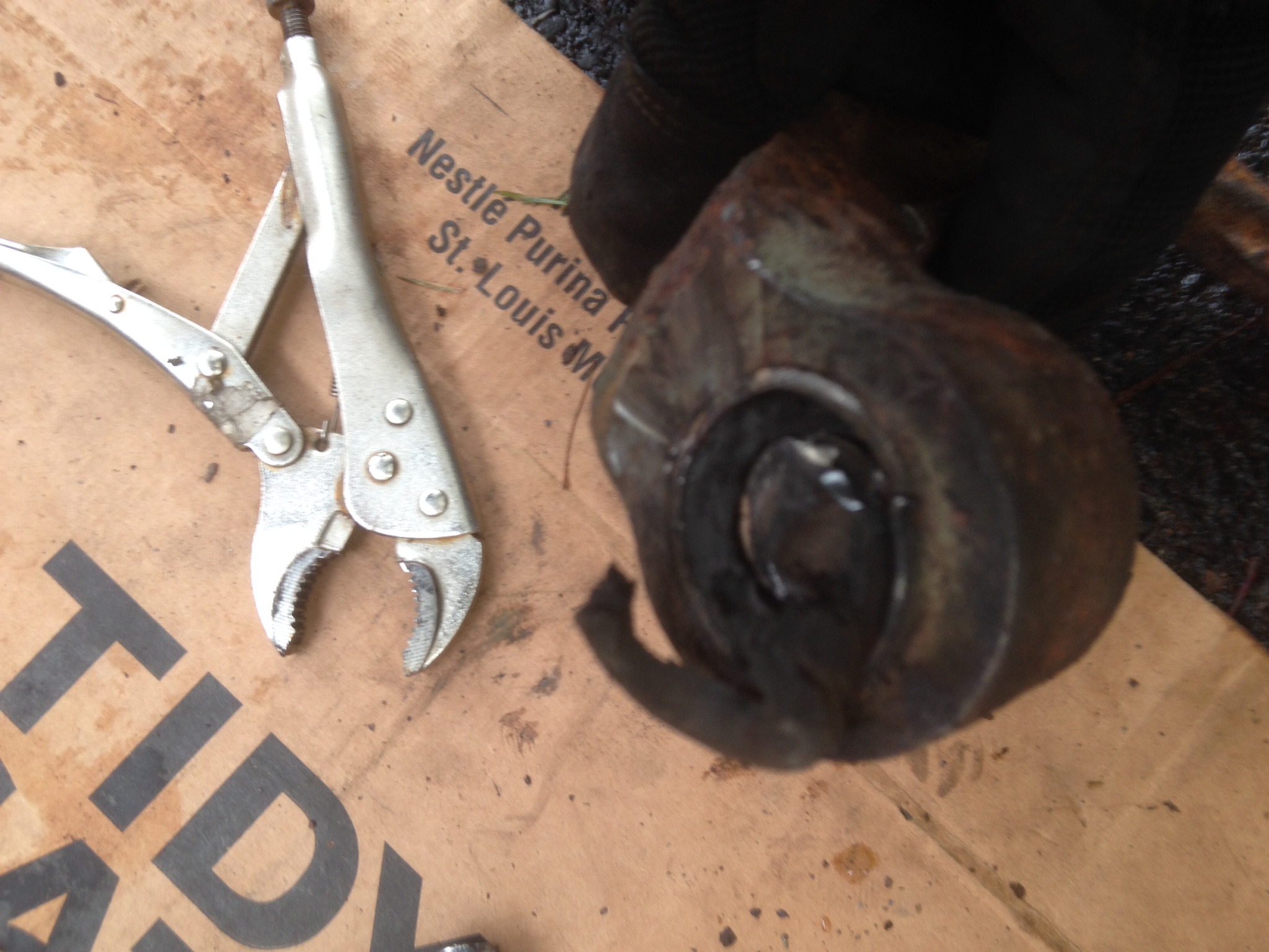

Lower control arm bolt fused to metal collar in rubber bushing
Had to be cut with 4.5 inch wheel.

On my son's LR3 Land Rover, we needed to change an air strut on one corner. Simple enough. Big bolts. Big everything on this car. We got the nut off, but the bolt itself was bonded / fused to the strut sleeve and no amount of pounding or PB blaster or heat would budge it. I pounded until it mushroomed.
We resorted to a sawzall with a badass Diablo blade. The head is recessed in the control arm stamping so you can't get behind it. We went in from beneath and cut the shock/strut sleeve collar and the bolt without cutting into the control arm. Went pretty fast after that decision - if you knew ahead of time there'd be trouble, you'd pull out the big guns and it would go pretty fast, but you always start with little wrenches and OE technique, and the job drags on!

That bolt shaft never did come loose.
Thin-sliced pepperoni - it was pretty accurate.
