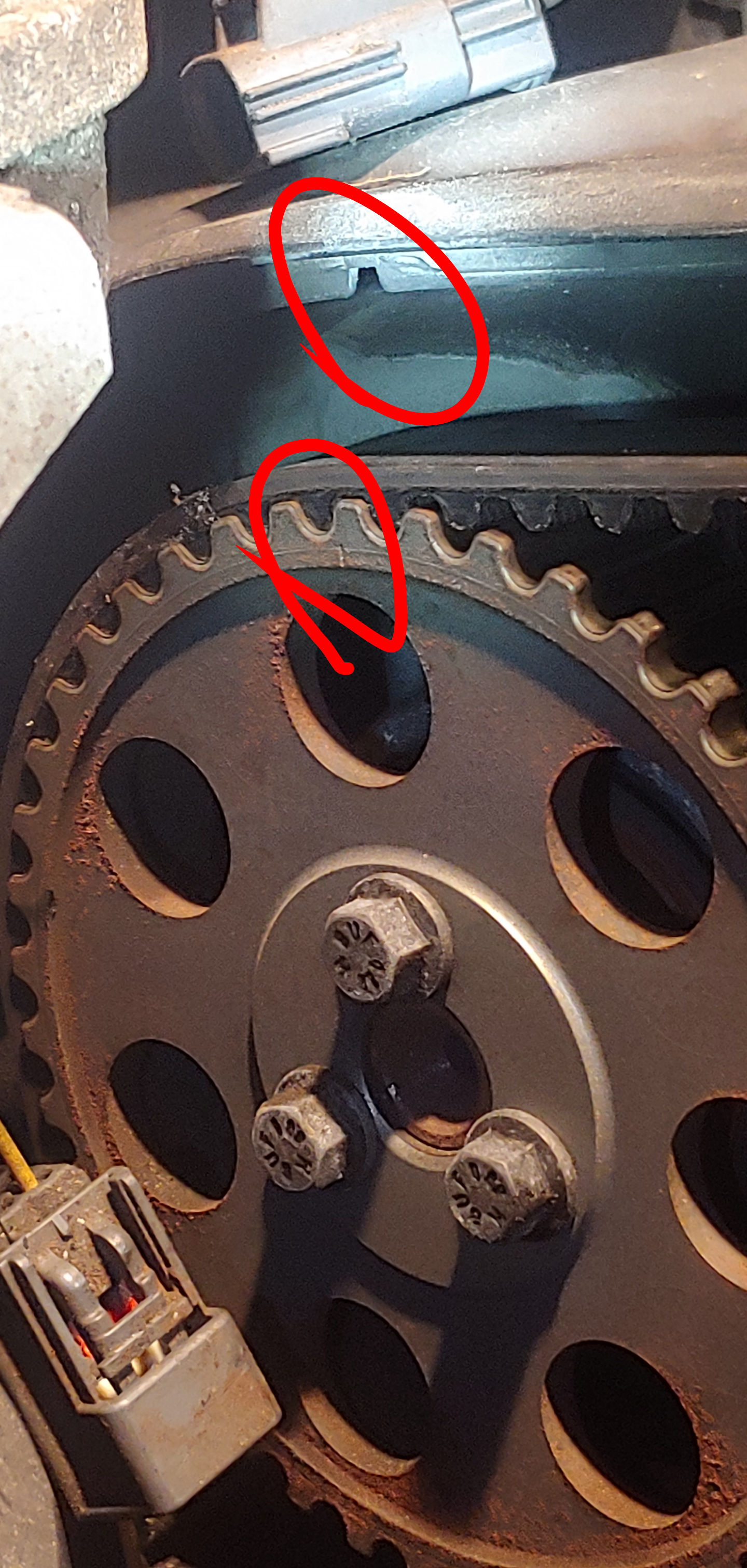

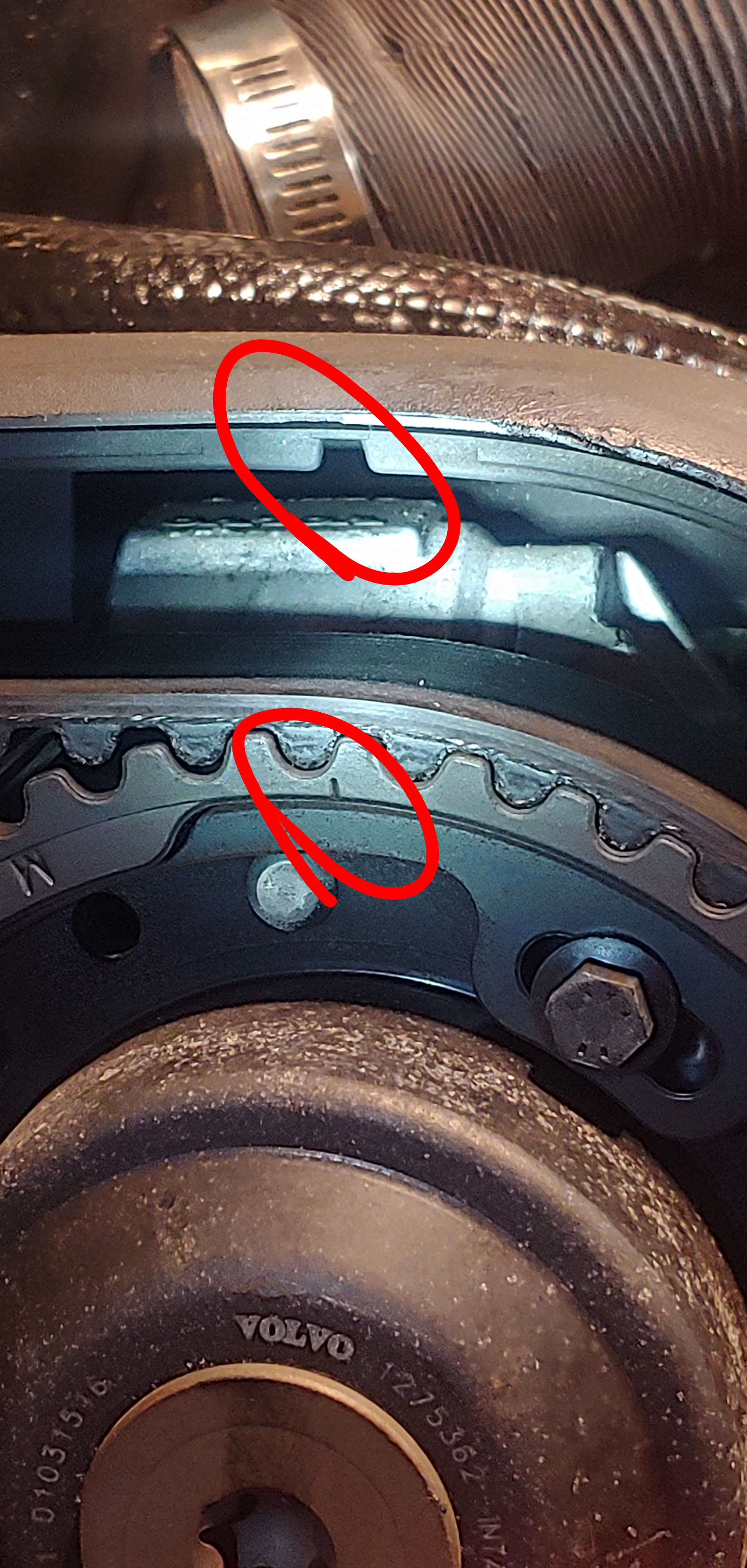

These nicks in the plastic the lineup marks for the cams? Just need confirmation as I've seen a couple different settings.. I've attached what I think is correct and followed accordingly.. Ty

Exhaust side

yes, those are the ones.
