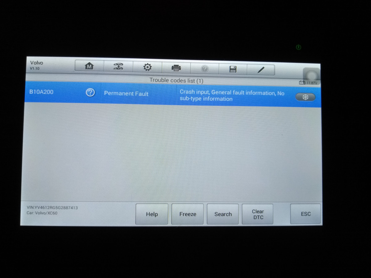

The issue: the battery went dead and after a jumping attempt the "crash mode" message appeared on the dashboard. The car was sitting in the garage and did not get into any accidents. All fuses are good. I've replaced the battery with a new one - it would not start, but the message was gone. When pressing the start button the lights come on, but the car does not start. If the push button is kept pressed the message "starting in progress" appears, but nothing happens. If it's pressed in for an few minutes, the message "push button malfunction, service required" appears. I've replaced key fob battery, push button (new from the dealer) - nothing. There were a lot of codes, and I got all of them cleared, except for B10A200 in the beginning. This code required to get into SRS module and deactivate the crash mode event that was sitting there. After that it was gone. All the codes were cleared with Autel computer. Still no luck.

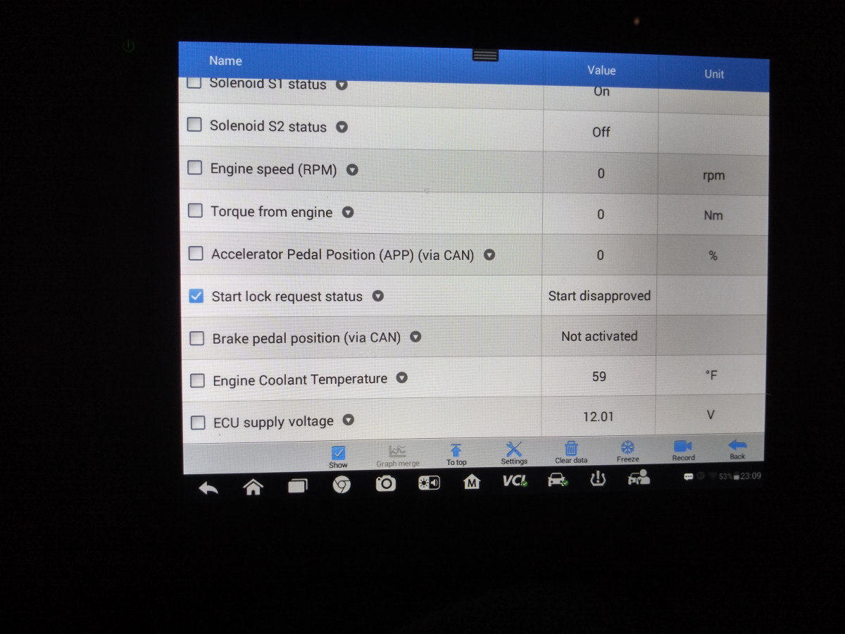

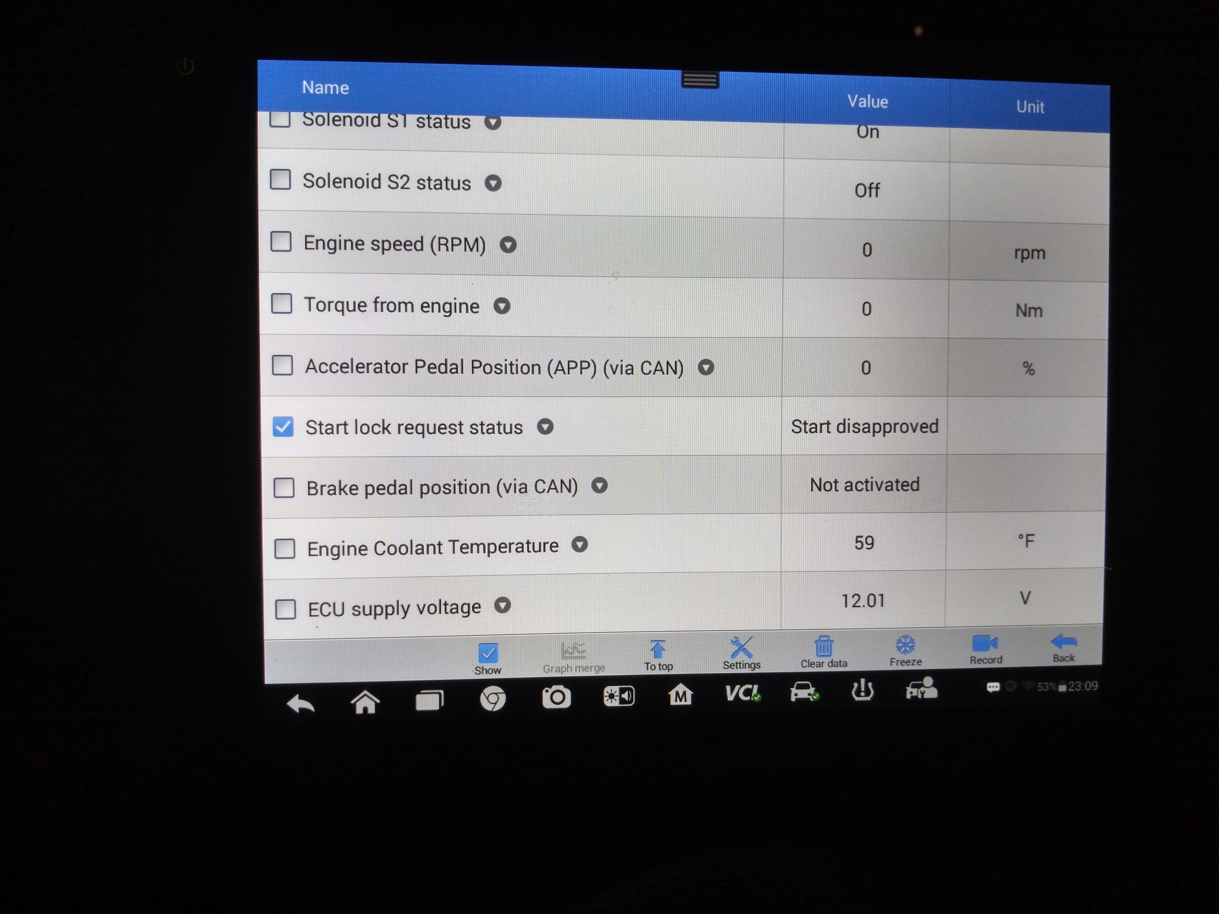

in transmission module "Start lock request status" shows "Start disapproved"

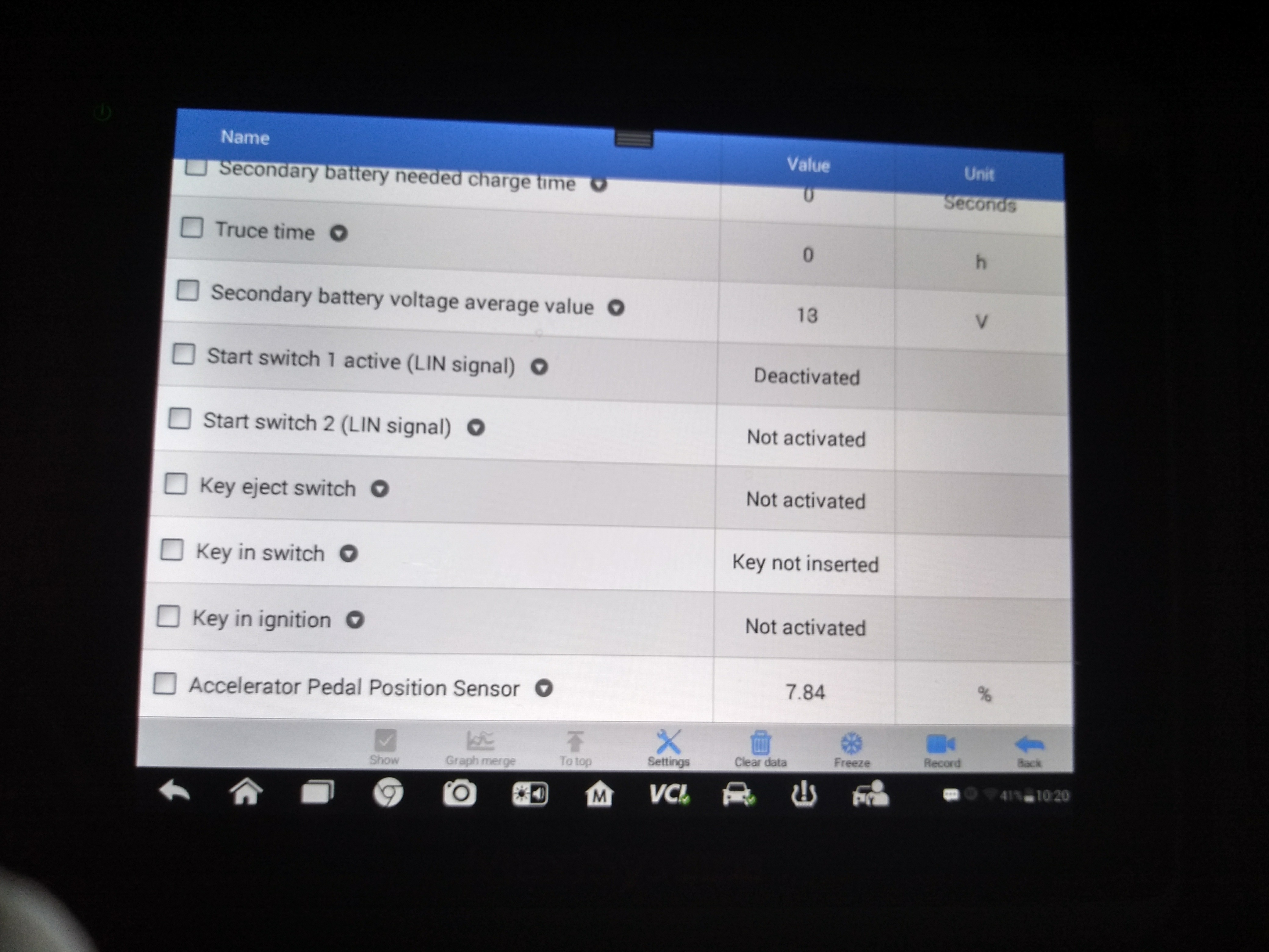

"Start switch 1" shows "Deactivated"
"Key in switch" shows "Key not inserted"
"Key in ignition" shows "Not activated"

You need an SRS module. I know of no way to clear that. The people at XEMODEX may have a way now. From experience with years 8 or so years back, this means the internal memory that has some portion that is non-erasable has reached its storage limit. I would usually say it means there was a prior airbag or seatbelt deploying collision bu the fact it occurred when jump starting means all bets are off.
