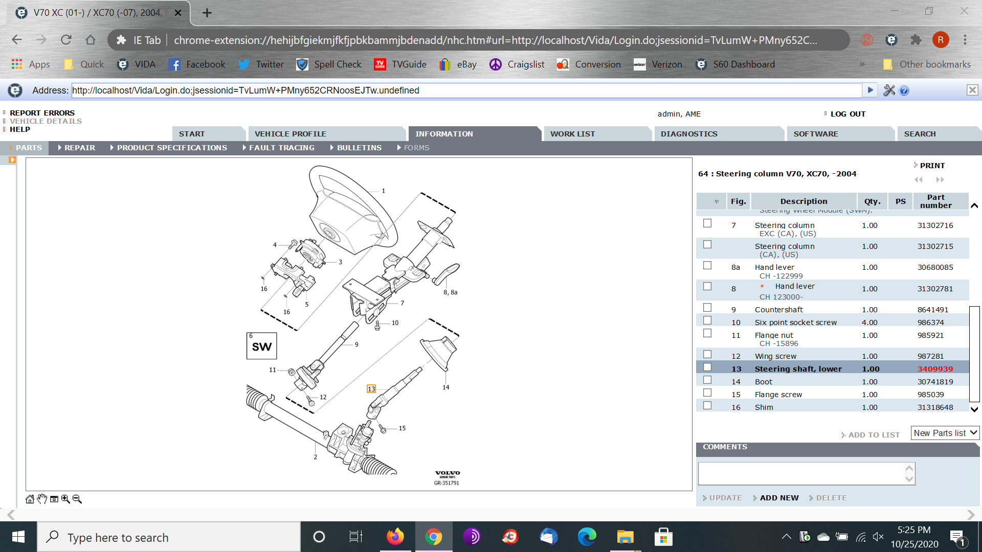

Suspect #1 & #2 are the joint on the lower end of the steering shaft (#13) or the joint on the Countershaft (#9).

Thanks.
Is it the part mentioned in about 8:25 of this video:
Do I have to remove the boot to check it or is there ways to check it without taking it apart?
