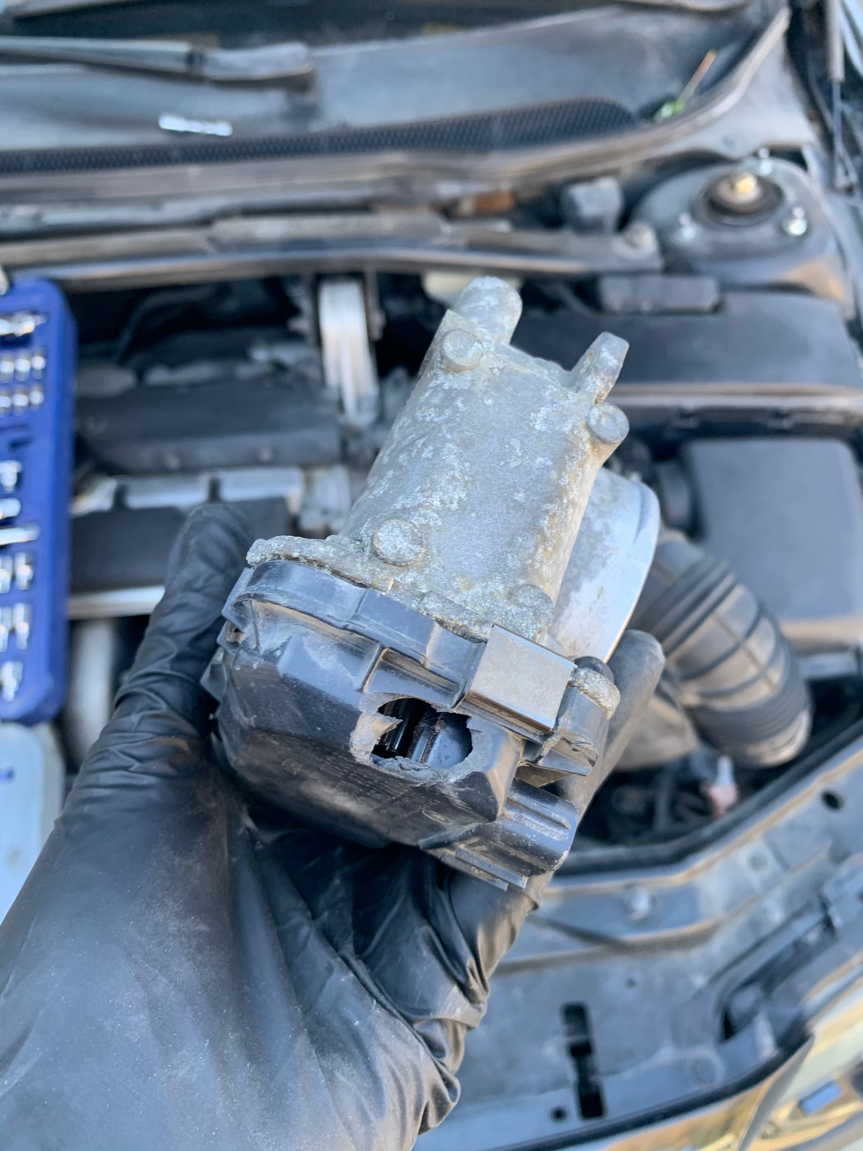

No codes, let the car sit for a day, and the weather warm up. I started with no problem. Pulled the throttle body to replace but got the wrong part. So it will be replaced later on. This is the hole I was talking about.

Yikes. Big throttle body mice.

I’m stumped on how it got that hole. Looks like it was dropped and broke almost.

nucci480 wrote: 31 Oct 2020, 12:31 No codes, let the car sit for a day, and the weather warm up. I started with no problem. Pulled the throttle body to replace but got the wrong part. So it will be replaced later on. This is the hole I was talking about.
looks like an impact strike, ran over something that got flipped up and hit the plastic.

The hole in the ETA is in the plastic cover that protects the motor solenoid and the throttle plate position sensor. Water and dirt (and mice) are getting in there causing all sorts of nasty damage. Get a replacement installed ASAP. Car is likely to drop into limp mode or engine stop unexpectedly.
I replaced my ETA with a cheap chinese clone with contactless throttle position sensing in early 2019 and it has been fine.
