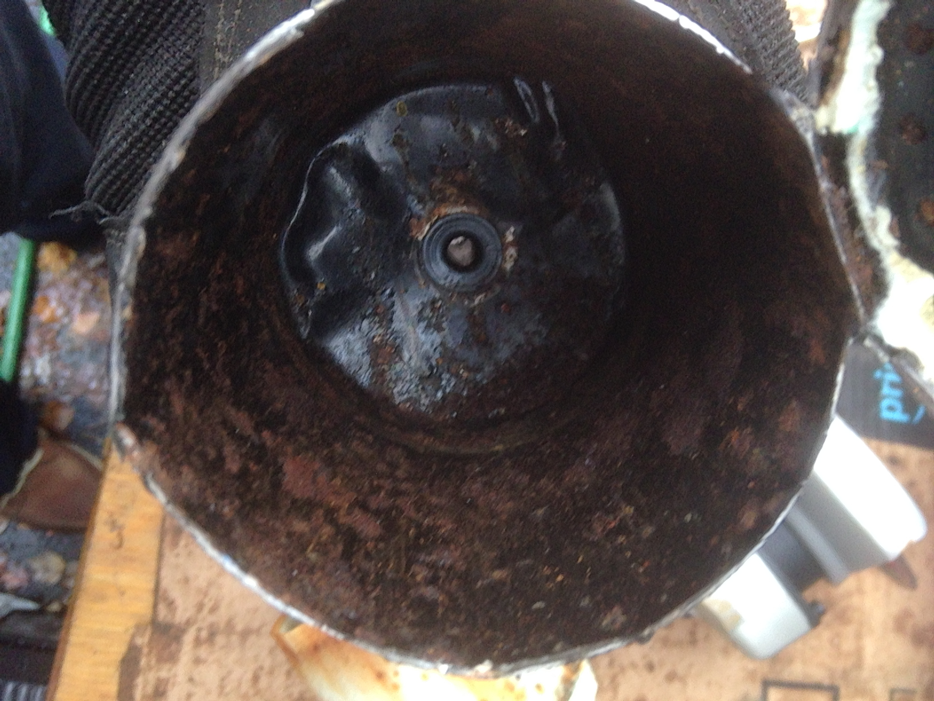

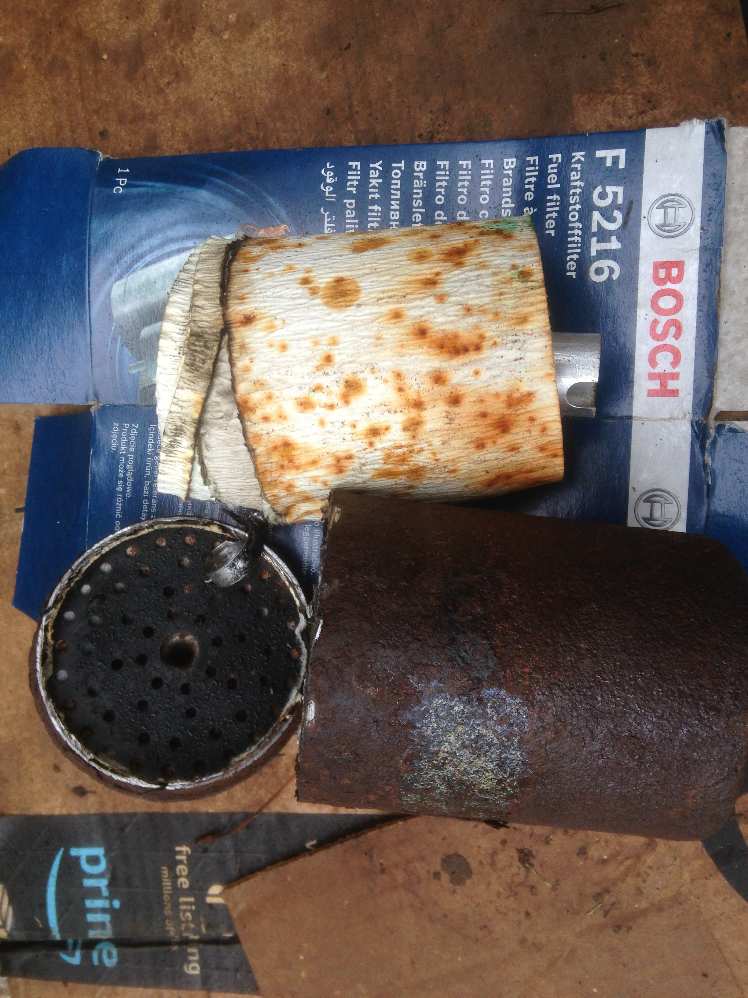

It’s hard not to eye roll at the ‘plugged fuel filter’ diagnosis. Unlike Uncle Joe’s era, gas stations sell a lot cleaner product than the past, and we rarely see fuel systems getting gunked up.
This fuel filter came off a 1998 and ran 22 years and 180,000 miles, the fuel system was pristine inside , despite the filter being ‘ near end of life’
Bosch 71049
P80 How overbuilt are the Fuel filters 30671182 on our P80 ! Fuel filter autopsy

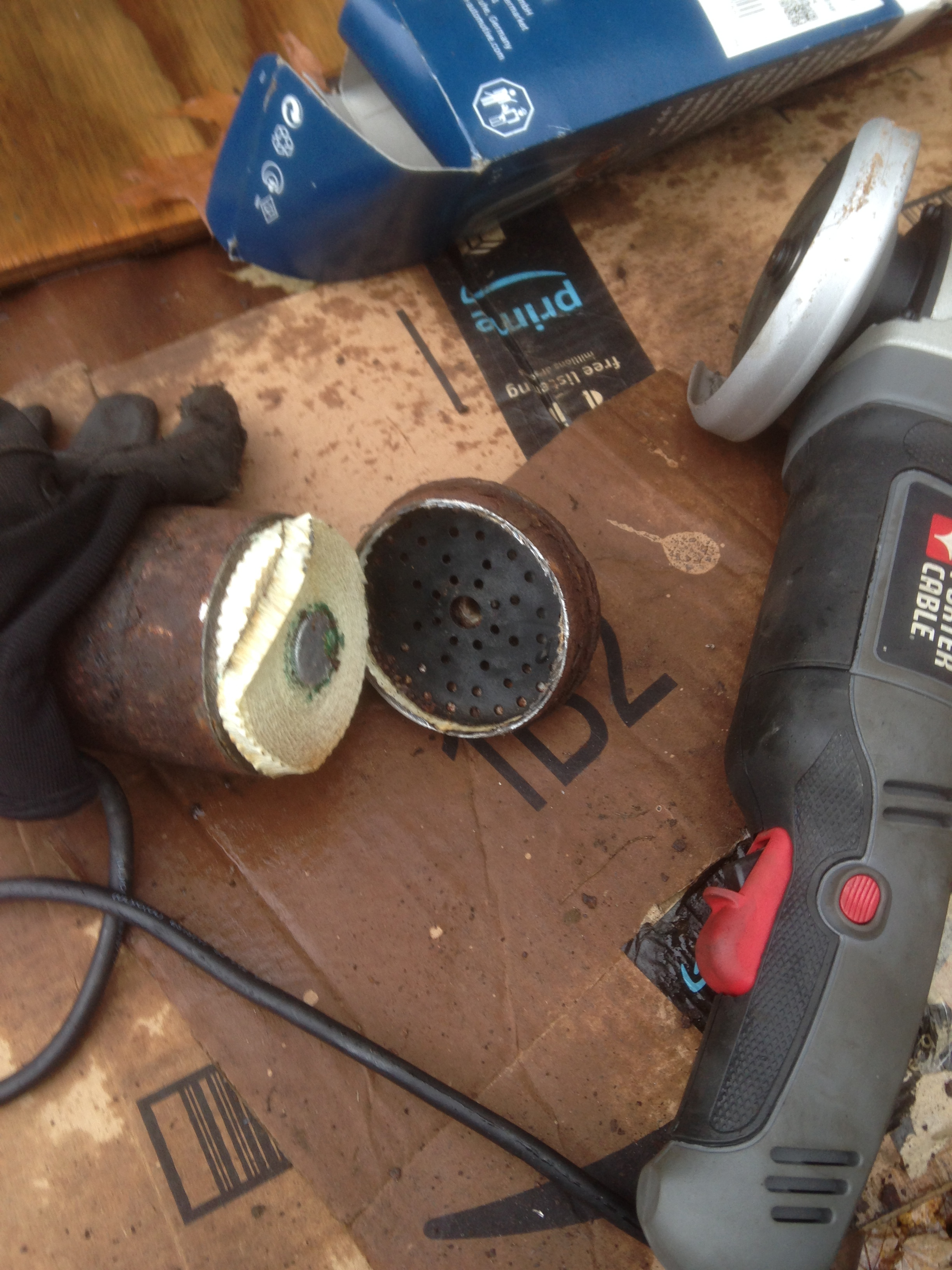

Interesting, thank you! I wouldn't have been gutsy enough to cut it apart with an angle grinder.

Abscate, did you let that thing bake in the sun for a while before slicing it open with the grinder?
It looks like you changed it just in time, before mass quantities of rust flakes started coming loose inside the shell.

It bake for about a month. I dislike gas bombs.
Look at how the top, which collects the fuel to be sent the injectors is pristine, while the rest of the filter is a dumpster fire.
