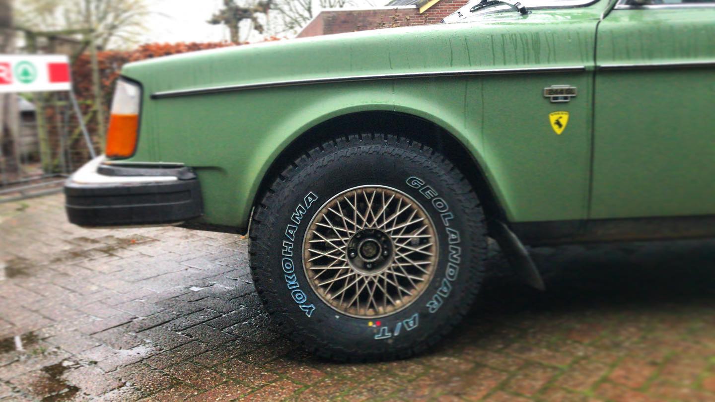

Thank you lummert and dmg4 - I ended up installing the 205/70R15 Geolanders and they perform well for my needs
This diameter must be the largest acceptable on a stock vehicle because there's just a .6" gap left between the tire and the front spring bottom support plates.
