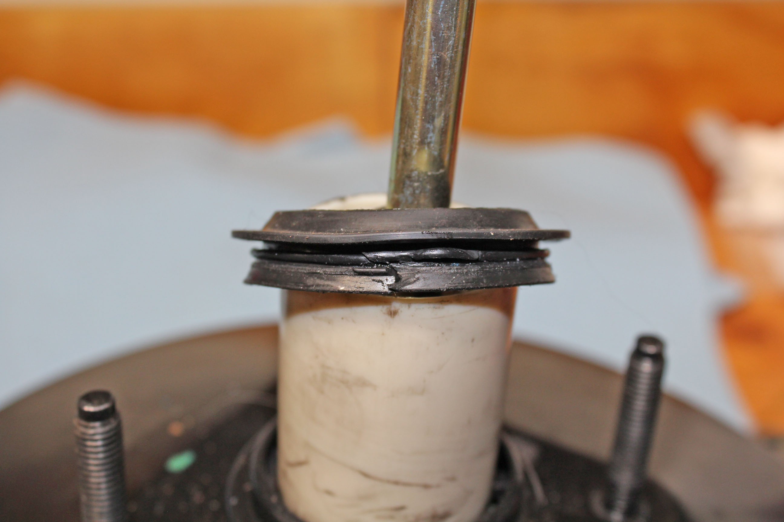

The other day I attempted to replace the leaking brake booster seal in the car as shown in the Oragex Youtube video, which is excellent. Even with the detailed instructions and tips I was still unsuccessful as I cut the seal during the install. I almost had the seal lip fully tucked in but as I pressed on the seal to insert the final part of the seal edge the seal tore. Ended up replacing the brake booster with a remanufacture one but now that I have the original booster on the workbench I think I know what happened. The edge of the brake booster where the seal is inserted is pretty sharp so you cannot apply too much pressure on the seal when the seal lip is partially inserted, the seal lip still outside the opening is sitting against the edge of the booster opening and too much pressure tears the seal. You have to apply some pressure to get the lip inserted and near the end when most of the lip is tucked in the pressure needed increases but too much will cut the seal. This is a tough seal to install and even more difficult working under the dash but can be done as shown by Oragex and I think I would be successful on a second try but needed the car and couldn't get another seal in time to try.

Just found out today from URO (APA Industries) that the brake booster seal they sell is not compatible with every seal used in the ATE brake booster for Volvo model years such as mine. After buying two of their seals and having problems(damaging) installing both of them, once in the car and once on the bench I find out the original seal in my brake booster is not compatible the seal they sell. Even though I purchased the seals from two different places and after entering my car model, year and trim to filter which part to buy the seals wasn't the correct one for the OEM original ATE brake booster in my car. They do note the seal number their seal replaces but I didn't realize there are more than one seal types used in my Volvo. Very frustrating, a lot of work and lot of expense wasted on this effort. I also noticed in the comments of your video that other people just weren't able to successfully install this seal no matter what they did and I'm thinking they had brake boosters/seal not compatible with the one URO sells.oragex wrote: 18 Nov 2020, 13:00 Just seen this topic, sorry about the misfortune. As I tried to mention in the video, it is the kind of job that needs some sort of mind control to succeed and good fingers perhaps (I used to play piano) Anyhow, I see what happened with the seal and that is precisely the difficult point due to the seal edge making an 'outer' angle, the opposite of what would actually be needed for an easy install - it's this angle that will actually keep the seal in place once installed. The use of that side pushing 'tool' being essential to force this edge in, I feel sorry I couldn't present more details about it. And that had to be combined with pushing the plunger to the opposite side to increase the gap. Perhaps I should have also added some footage with the work done on a booster on the bench, for better understanding. I know some people in the comments managed to install the seal, while others couldn't do it - some also tried the 'red' seal from Poland without success. As for reaching with both hands perhaps it's a matter of shoulder flexibility.
If anyone else is considering doing this seal replacement please be warned you'd better get the number of the original seal and compare with the URO seal replaces or else you'll waste all the time and expense I did. This is the ATE seal 03.7718-5028.1 that their seal replaces, if your original seal number is not this then you've been warned and good luck reading this number off the seal with the brake booster in the car.
