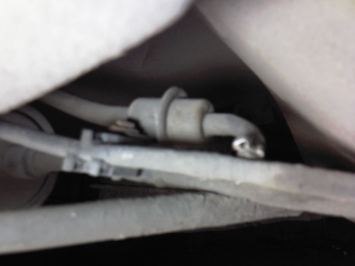

My question is....since fpr is small one, Bosch 0 280 160 554 near fuel filter....can i reuse the return line which comes out of it without replacing the whole line?
Can i slide the hose off the old one and slide it on...on new fpr and secure it with a clamp as a precaution?
Fpr is held by 2 screws on plastic housing...so there shouldn't be a problem here.

Here is my FPR near the fuel filter:
