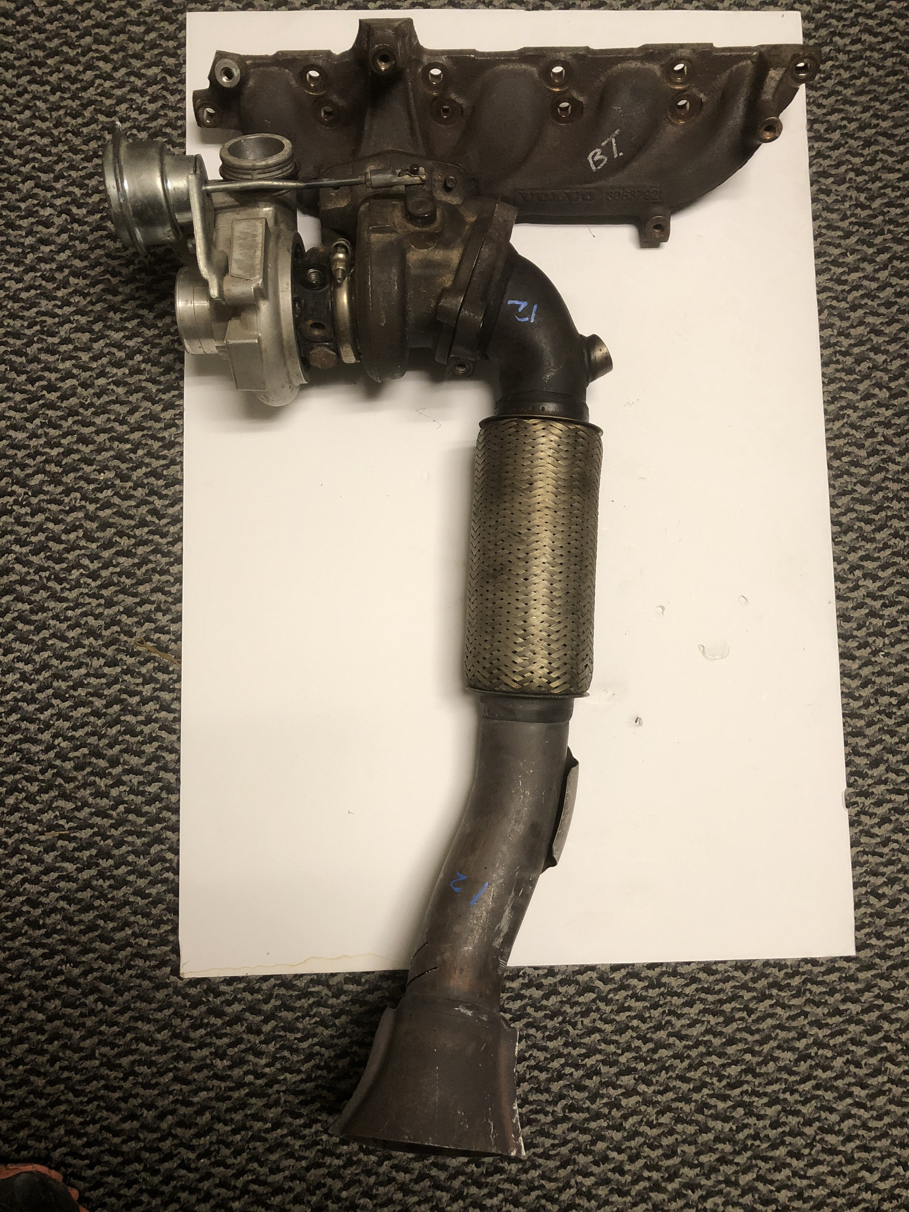

It looks like I can finally start my turbo/exhaust phase of the build.
I will get a local muffler shop to build me a exhaust system after finally getting an angle flange downpipe.
16T
R manifold
Angle flange downpipe
I also got some blue injectors today. I will get them cleaned and flow checked.
I am finishing up the big bore intake system to go with these injectors too.
16T
R manifold
