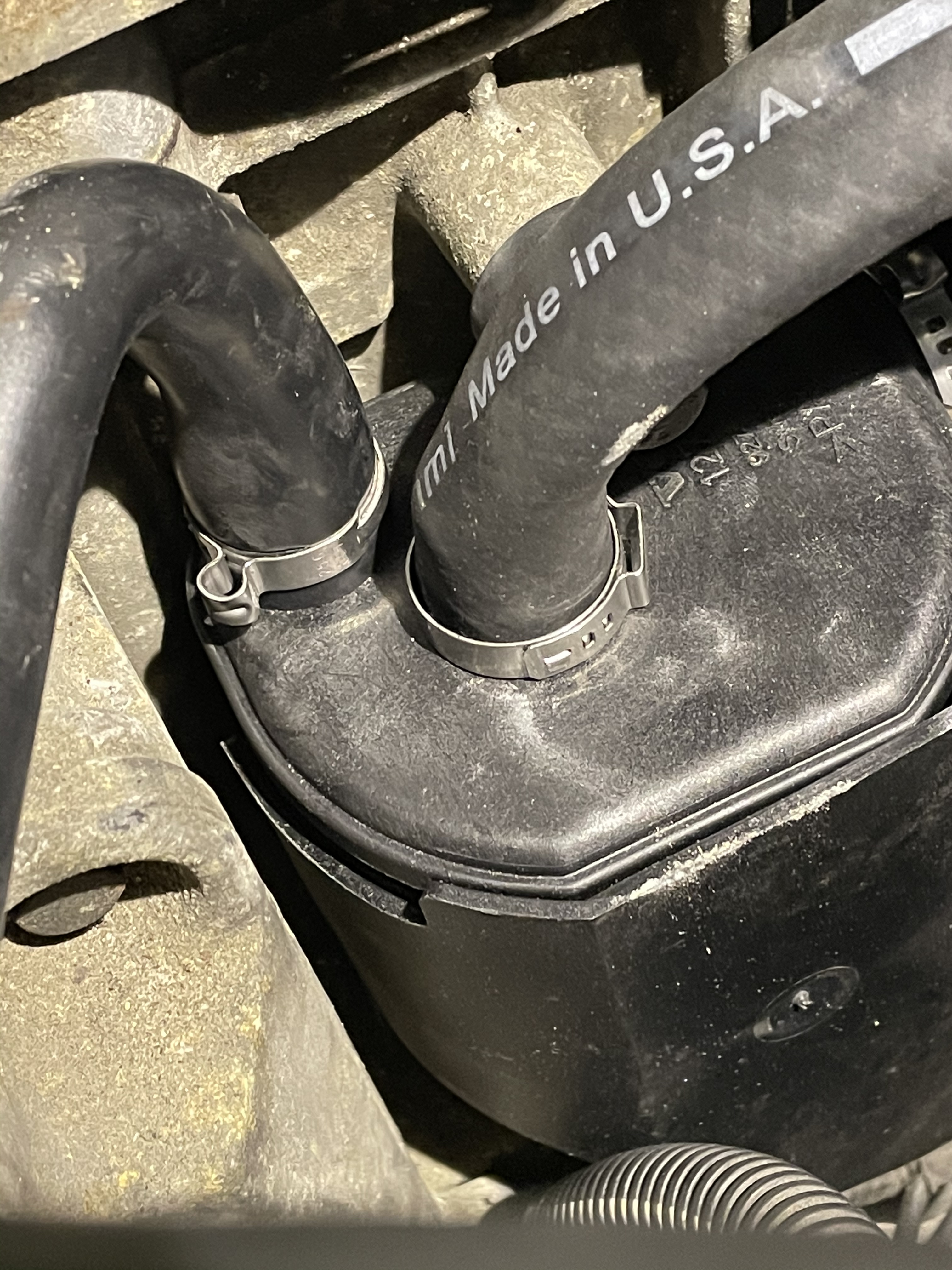

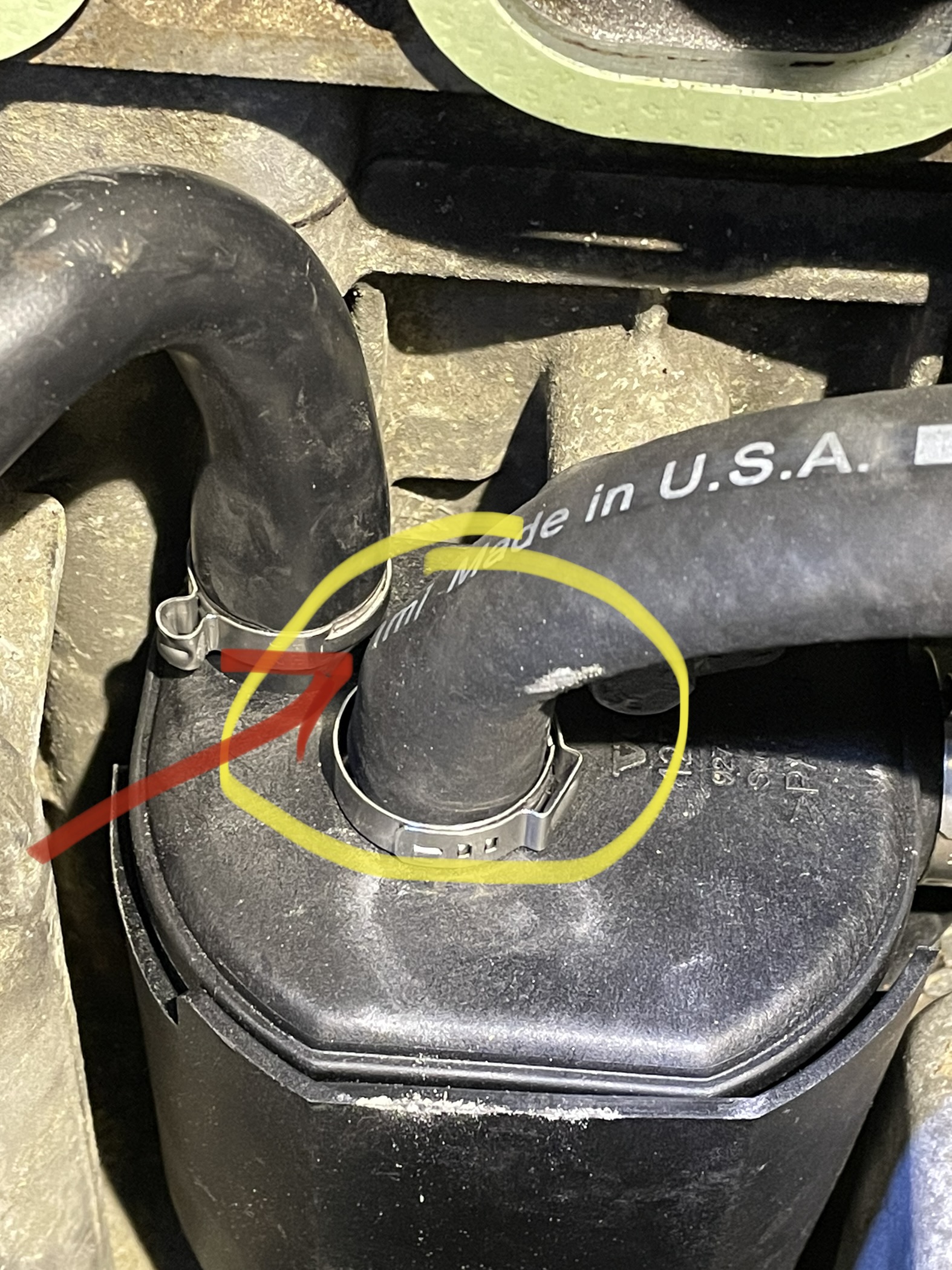

Running a 5/8” gates fuel line to my PCV oil trap box and I have this kink.
How big of a deal would this cause in regards to maybe tearing this hose as time goes on? I don’t think this hose will flex much, so I believe I’ll be fine— it shouldn’t tear.
Thoughts?
Would this kink cause issues? PCV job

I would run that for 5 years

When you put the manifold on it will push the hose further down and make that much worse, if not close it off. That's the purpose of the spring.
