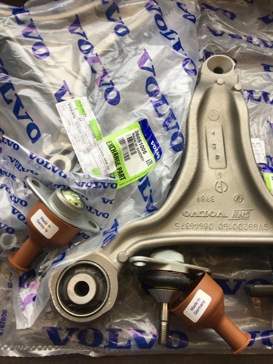

New parts arrived today, nice cast aluminum control arms made in Sweden. Ball joints from Germany in Volvo boxes.......this is where quality parts should come from! I noticed that the Chinese control arms always are painted silver, and much heavier.........I wonder what kind of mystery metal they are made of?

Affectionately called, “silver cheese” here.

I agree, and the rubber in the bushings is the same material that they make bicycle tires out of. The Volvo hardware is strangely reminiscent of fine jewelry!

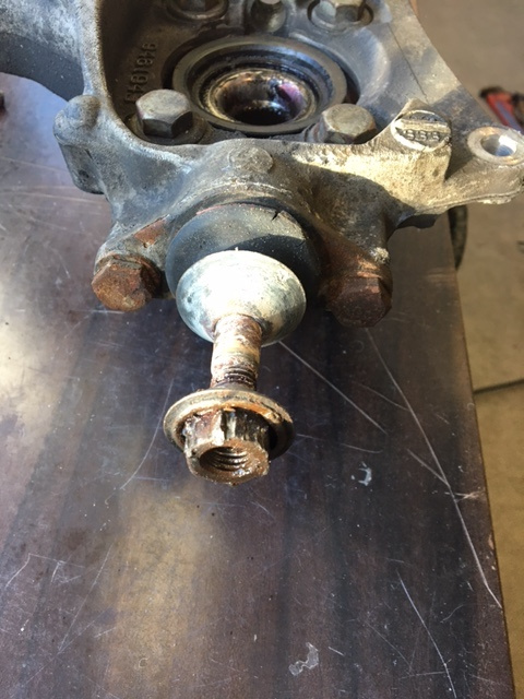

So here's the lower control arm that was hitting the subframe after 6 months, also the ball joints that were so cheap that the fasteners ( nut on bottom) rounded when I tried to loosen it and had to use a pipe wrench. I think the actual ball joint was made of the same material and wore out in less than a year. The control arms were not even the same geometry as the Genuine Volvo ones, I measured them after removing them, about 2mm longer to the balljoint centre point. Both parts were Chinese aftermarket from Rockauto.

Looks like the bushing should be inserted in the opposite direction?
