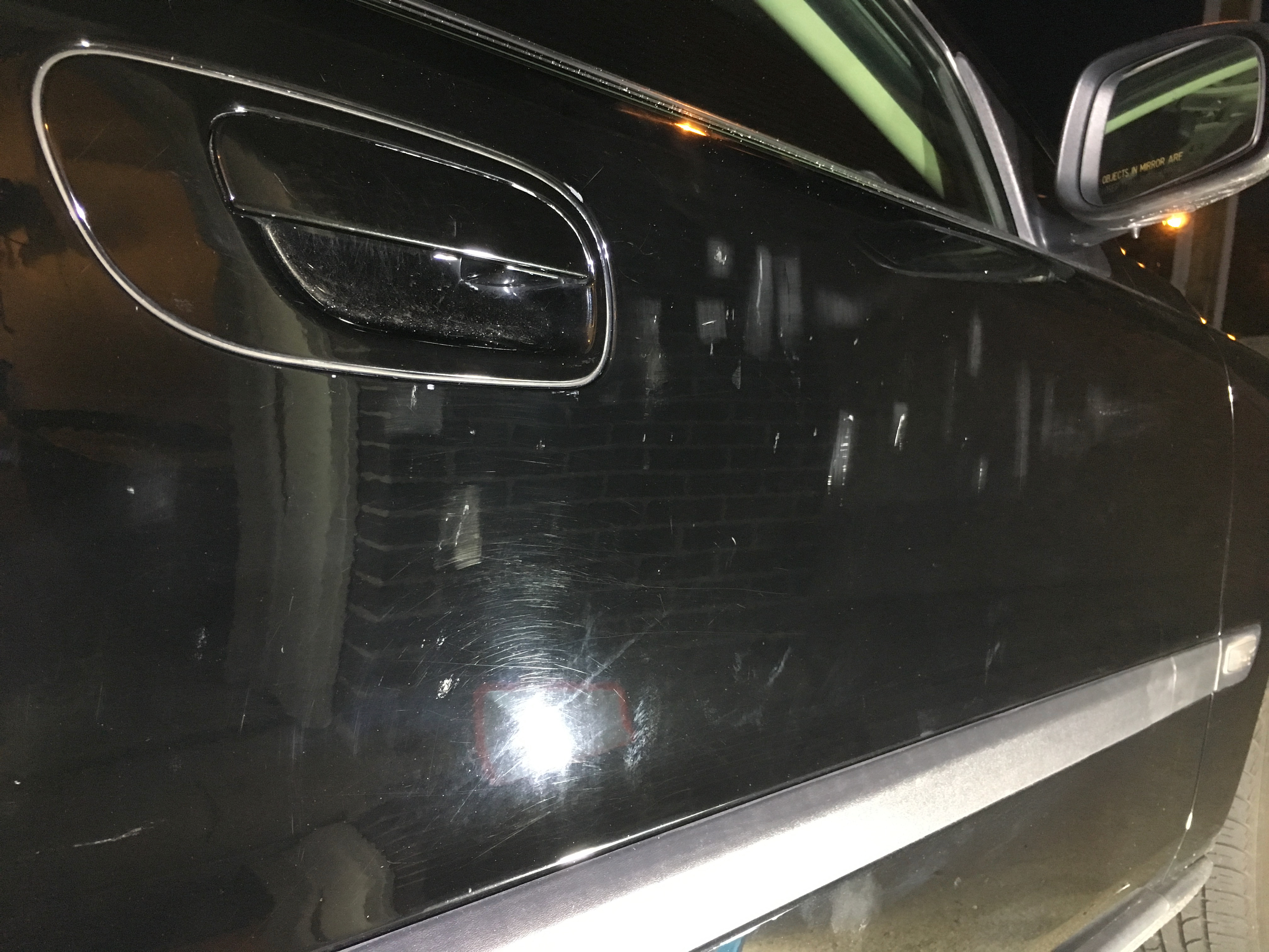

My car is black and although the paint is reasonably good, it is full of small scratches. I'd like to get the scratches out but am not sure how best to do it. I don't know for sure but don't think Volvo used a clear coat over the paint on certain colours. Has anyone been successful at bringing back the shine to their black car? Here is a picture of what the paint looks like, sorry about the quality:

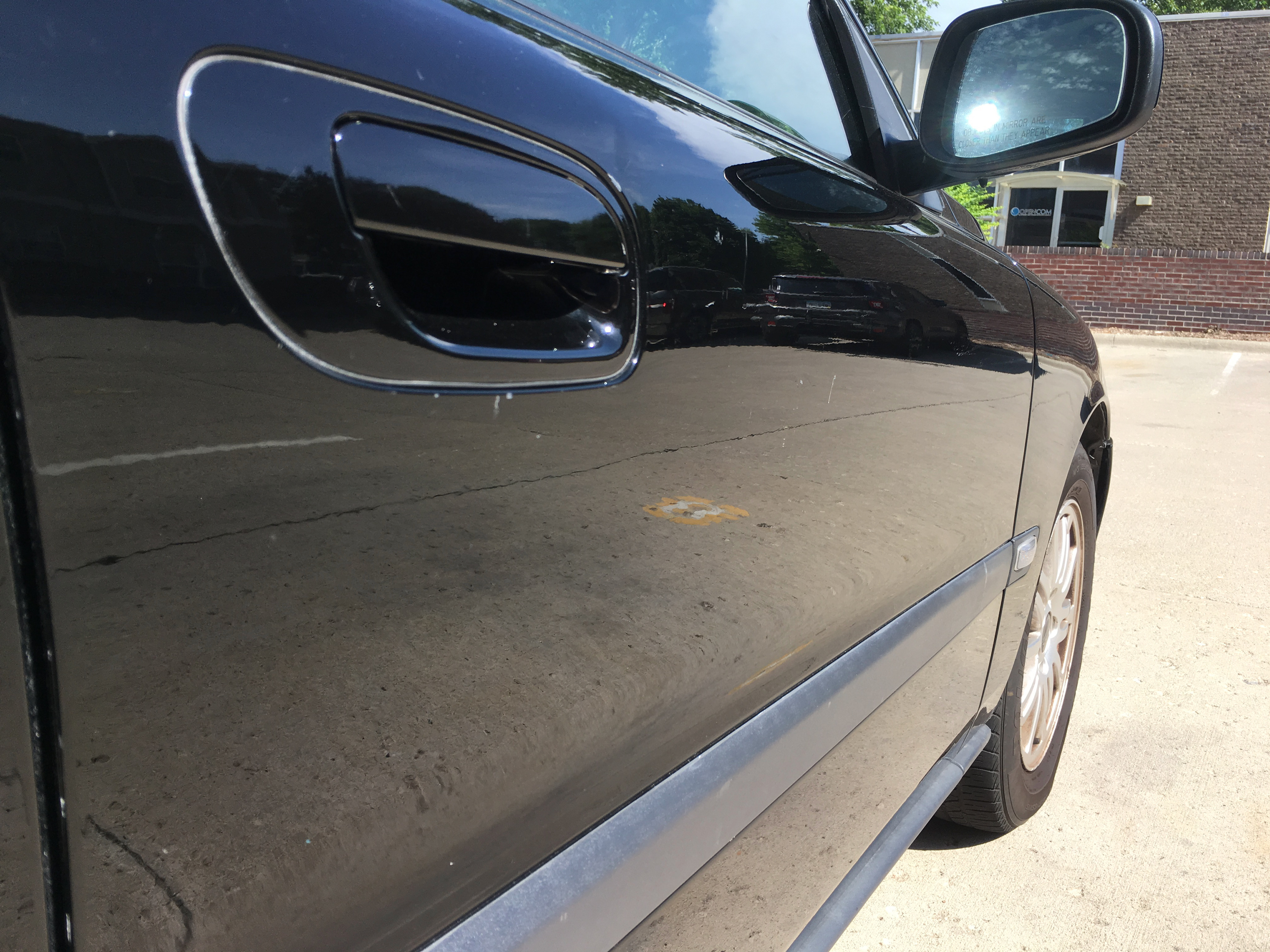

I run an auto detailing business. Your best bet for trim is respraying it with this stuff. Everything else is basically temporary. The paint will need polished to be brought back to life. You would want to use a product like 3D One and a random orbital polisher. I like griots garage orange pads for my polisher. Then follow up with a sealant or wax of your choice. I really like gtechniq c2v3. This was a multiple-stage correction I did. wet sanded, compounded, polished & sealed.

Agree with nucci above.
Your black has a clear coat. Mine is fading, and a random orbital with Griot's products brought a lot of life back to it, but it needs wax to protect it. If no black appears on your pad when polishing, you are not through the clear coat and into the color layers.
